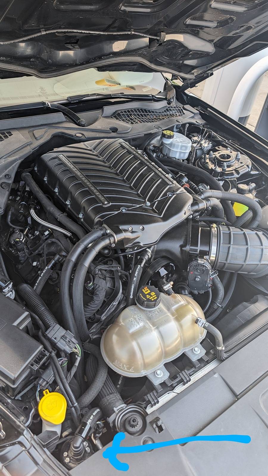

I currently am not running a catch can on my Gen 5 Whipple car. I have a JLT catch can to go on the car, and I want to put it on the passenger side. I am considering some options on routing and mounting so... Who has done it and where did you mount it? Pics are always helpful.

Mounted passenger side next to the radiator, below the washer fluid fill

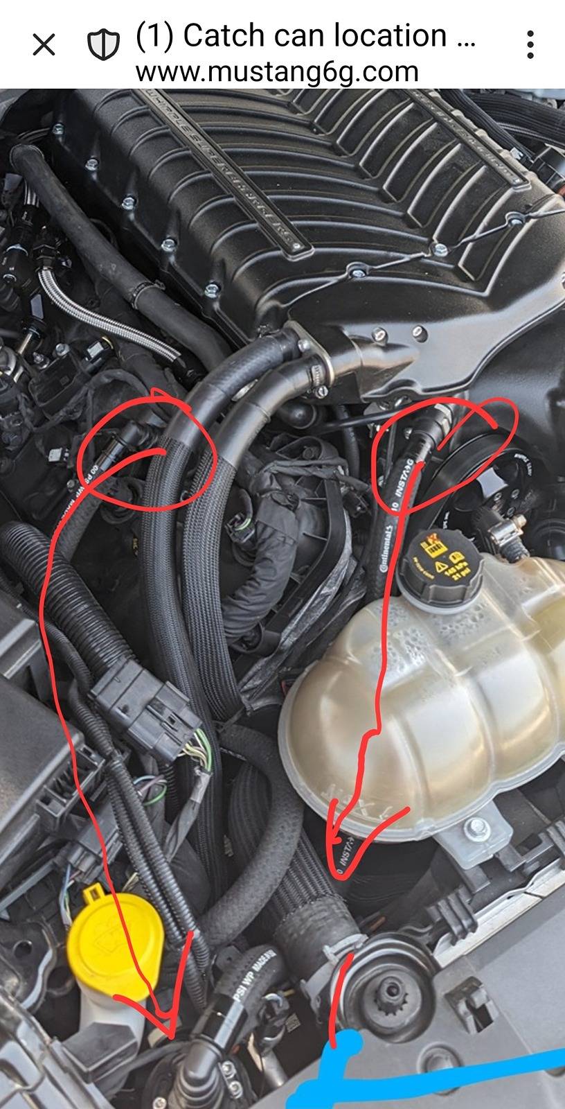

So these two points ran to that can, correct?

Subscribing. I’m looking into a catch can that’s vented to atmosphere. So run a line from each valve cover and then plug the two intake ports. Just donā€˜t know how to mount it.

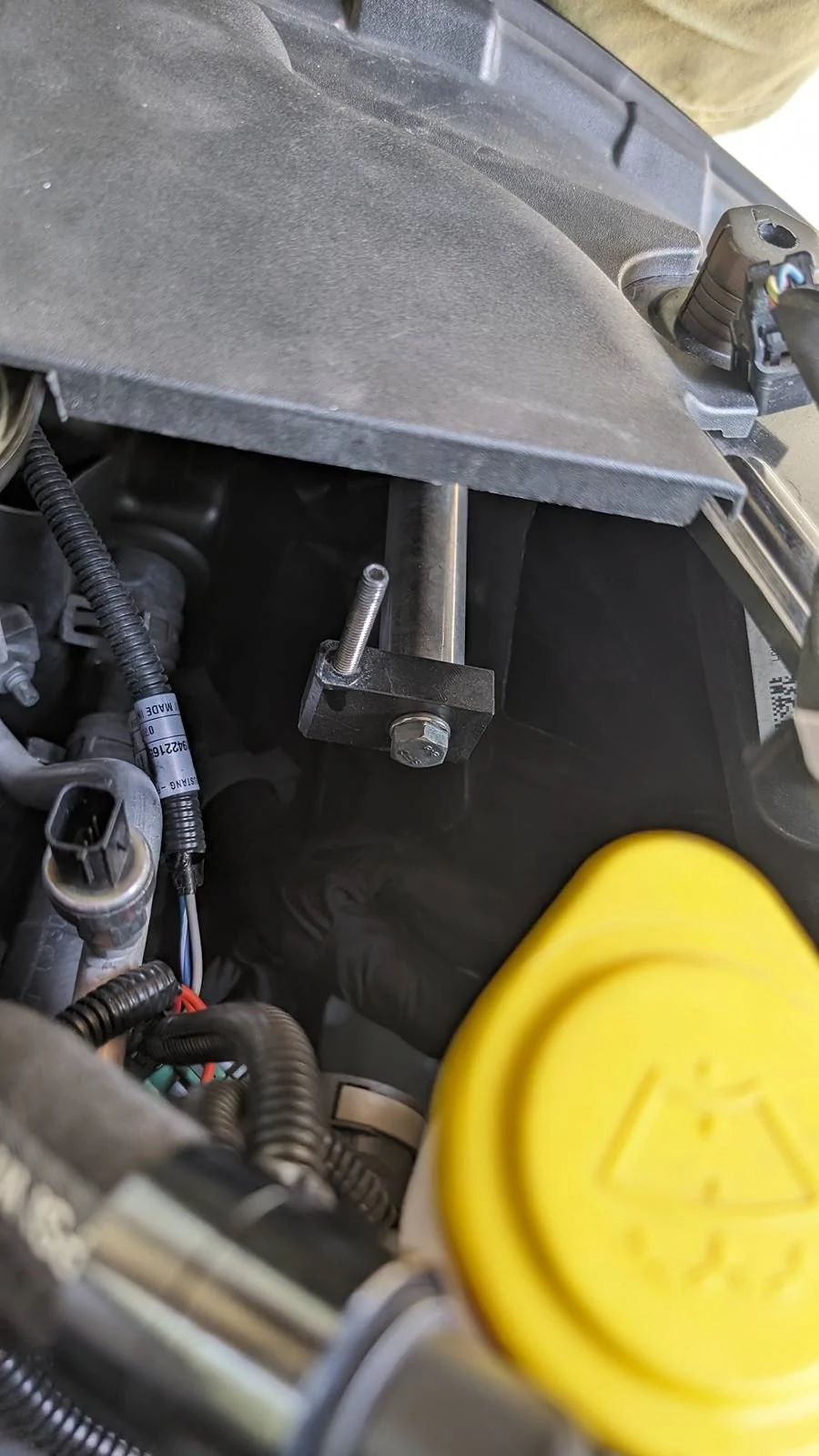

@Btfresse what type of mounting bracket are you using and where does it mount too?
The UPR kit I bought came with this bracket. Remove an existing bolt and install the bracket in its place
