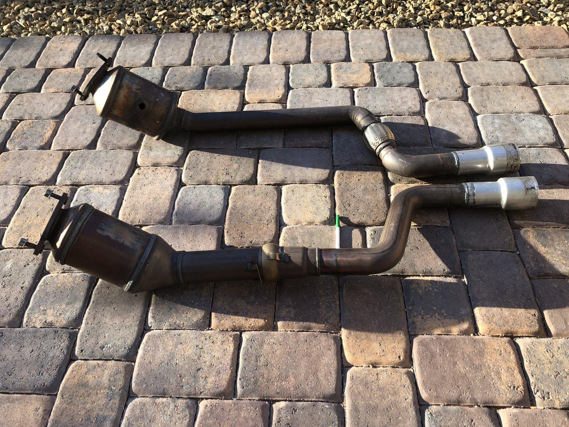

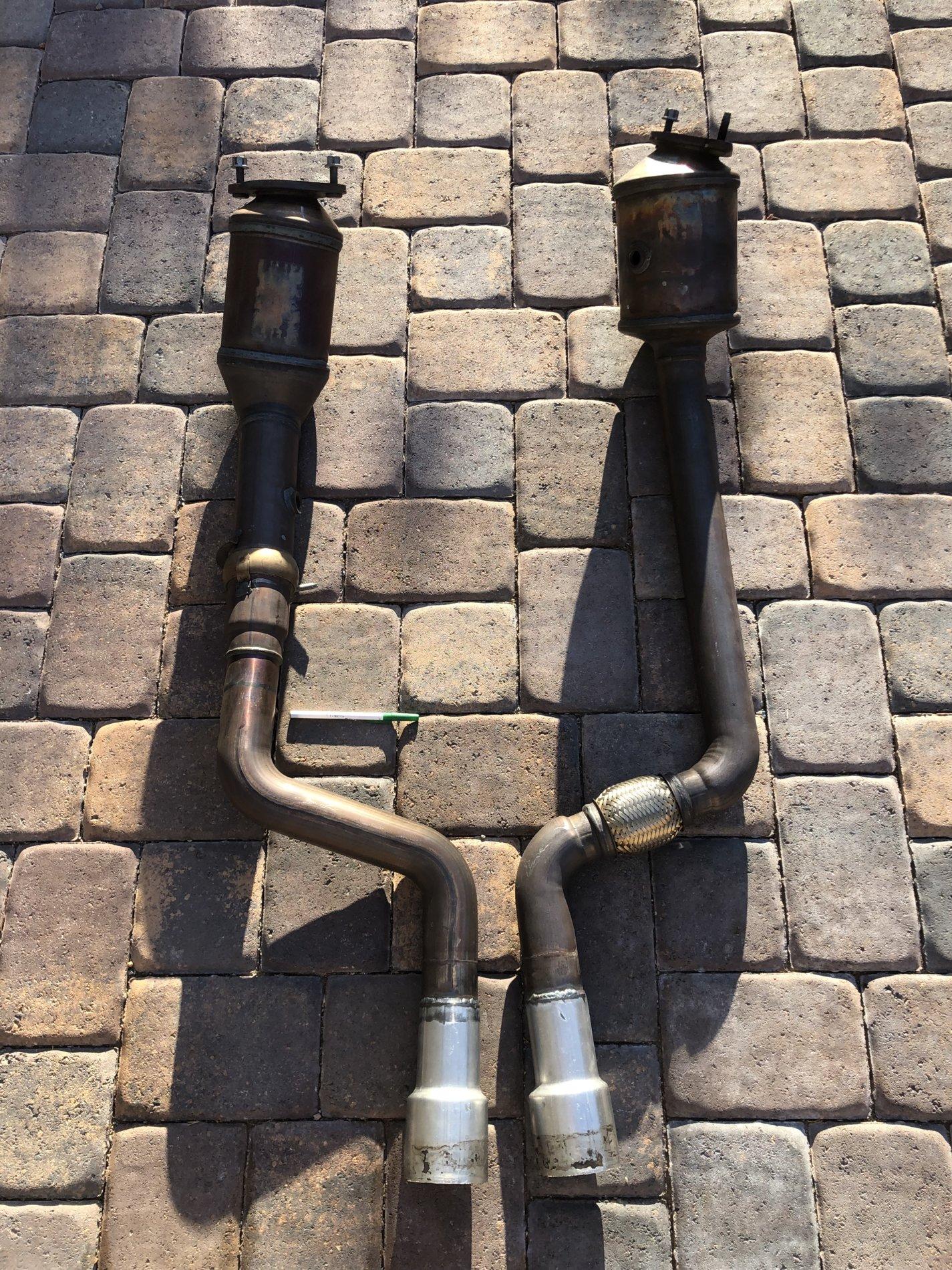

Here is my cat swap set up. Where I put the pen at in the photo is where I had it cut and welded. From where the pen is to the cat is from a 2014 car, from the pen back is from my 2015. I have the same slip on ends on my mak deletes but they are 3 inch OD to 3 inch ID so they slip onto my 3 inch cat back without having to neck down in size at all. I sourced the 2014 parts locally and got both cats and manifolds for $200 which was nice since I didn’t want to cut up the stock cat.

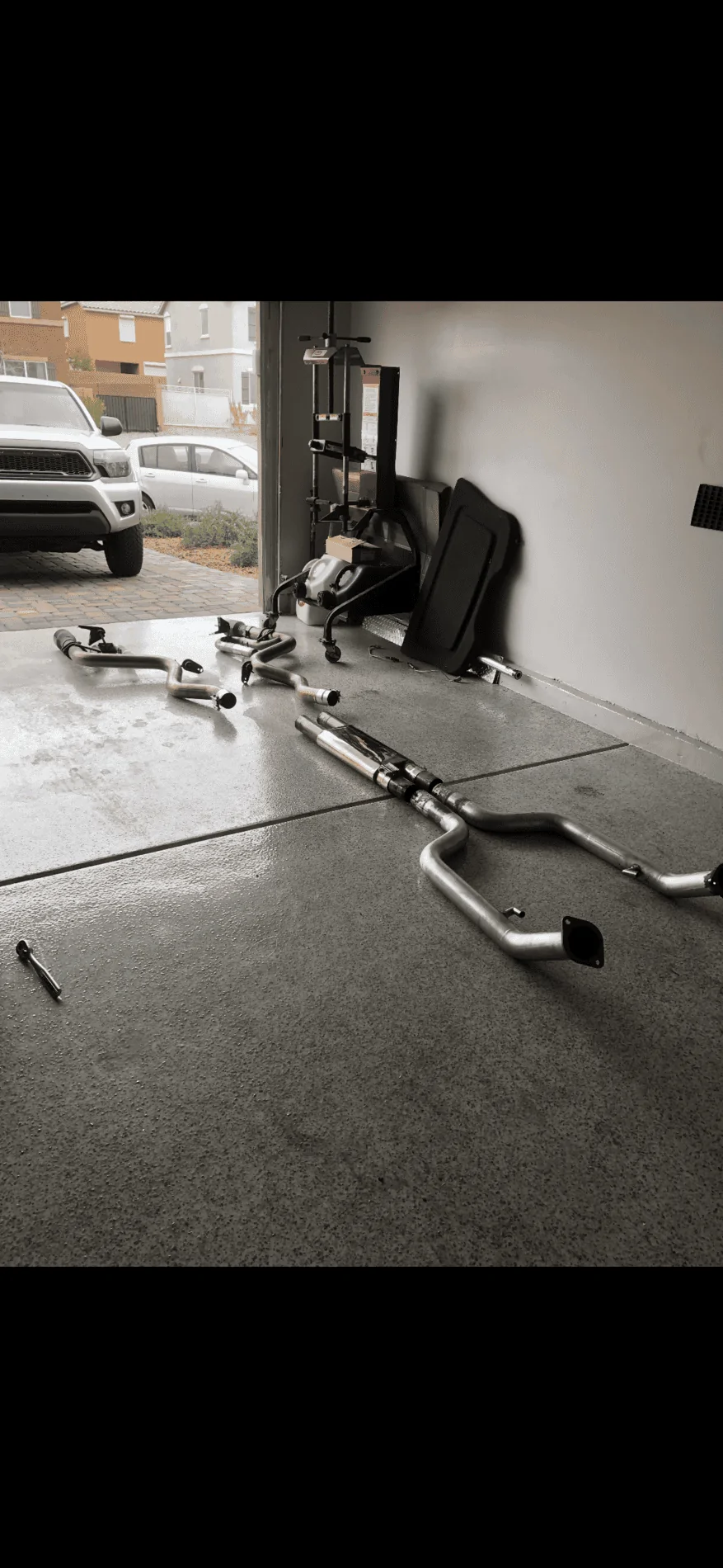

This is my whole exhaust with cat deletes.
