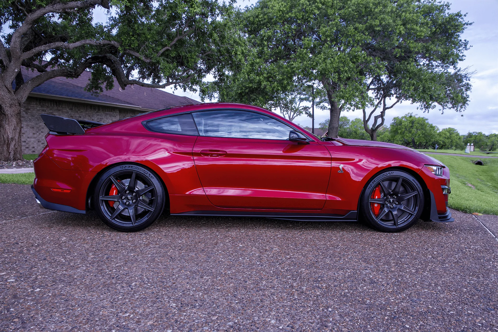

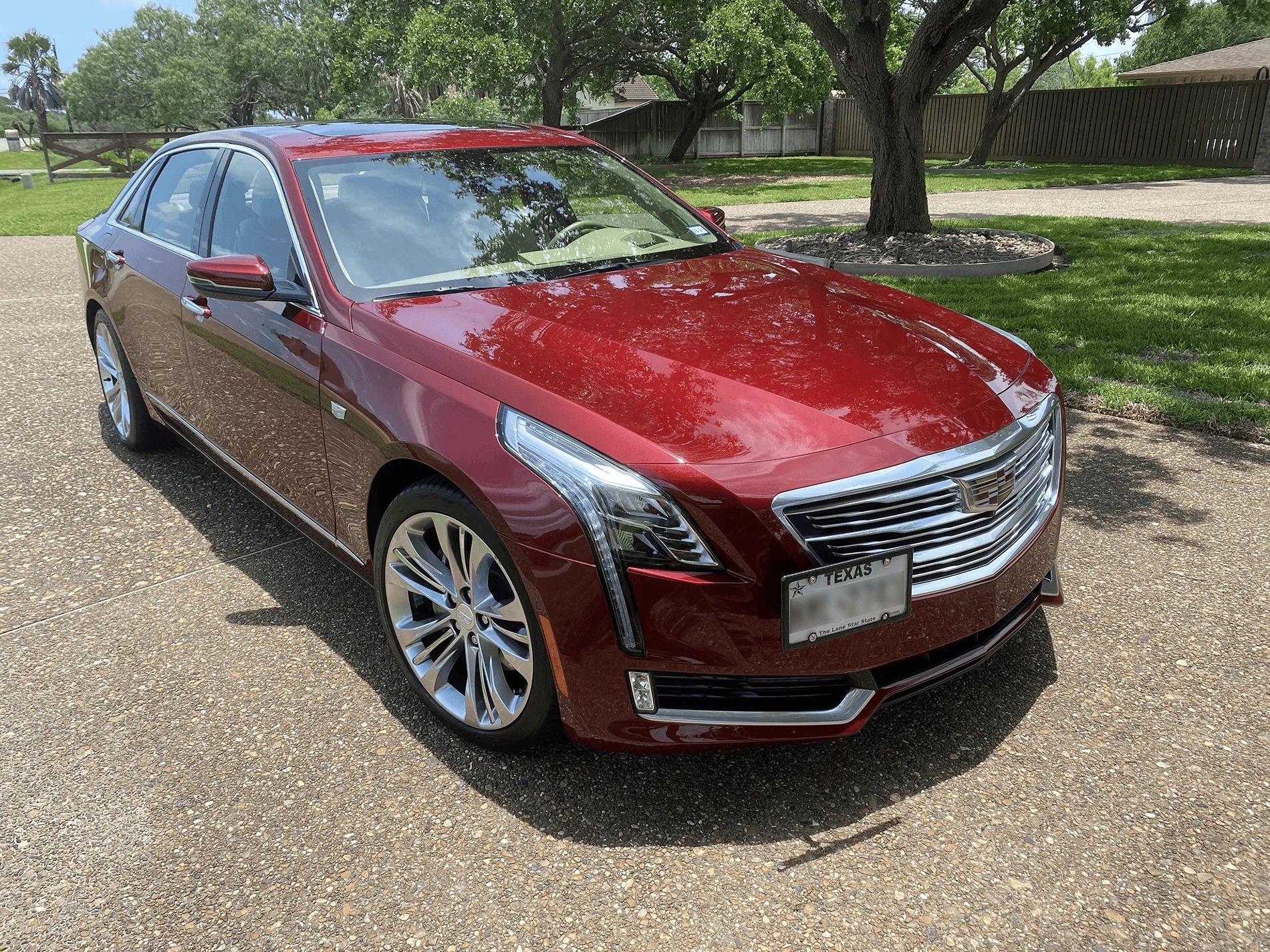

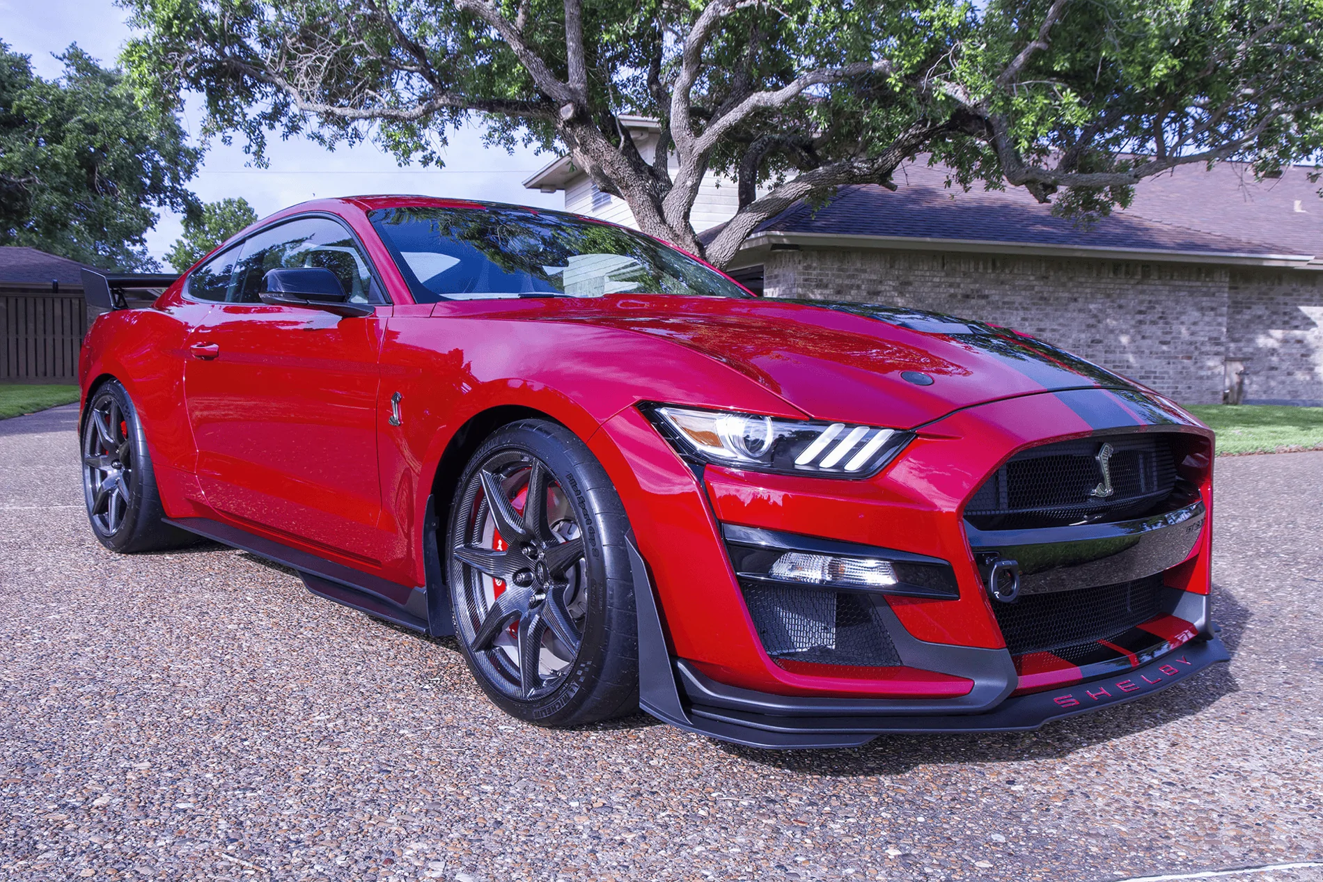

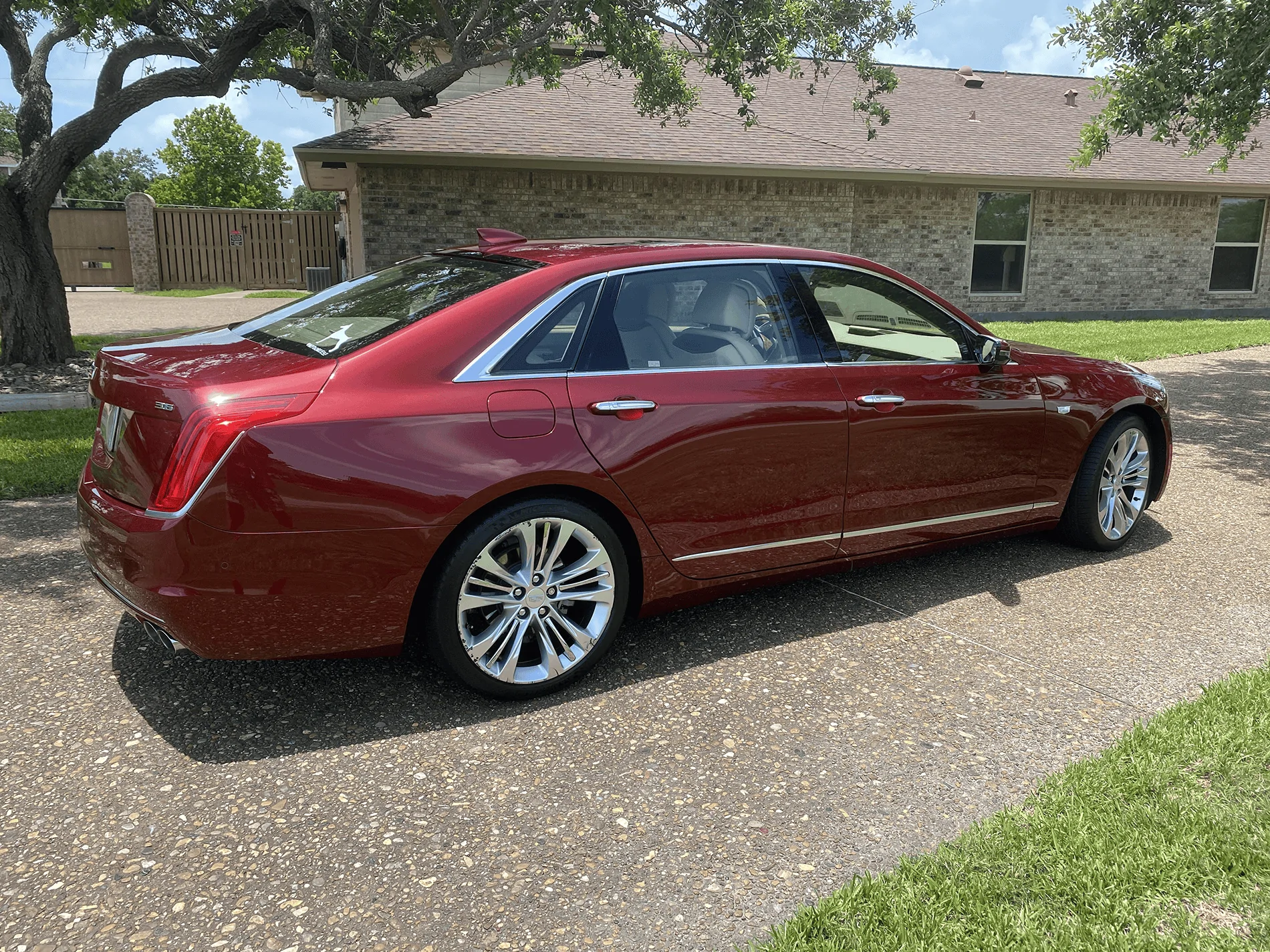

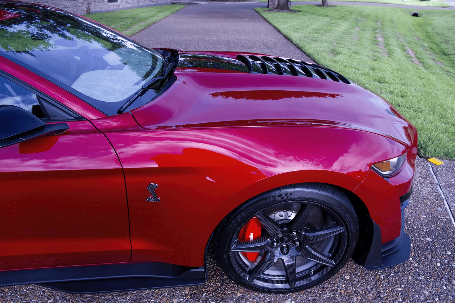

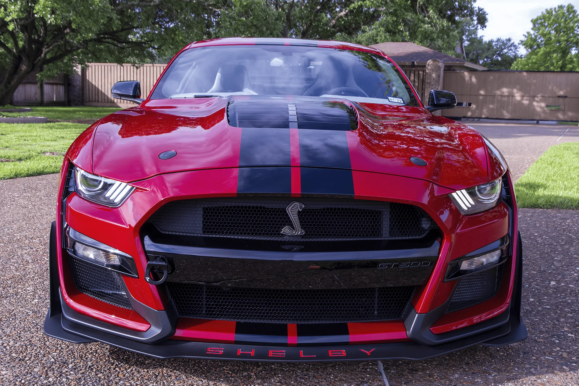

Despite a forecast of more of the same, it was a beeyooteeful morning and thought I should take advantage of the good weather. Took her cozy cover back off, pulled her out in the driveway, and grabbed a few shots. Here they are..
