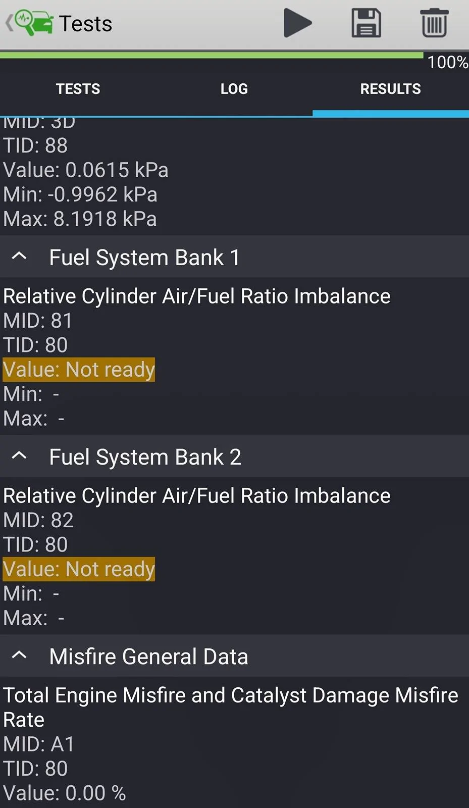

Has anyone seen this before? This particular portion of the fuel system monitor doesn't ever run so it can't ever complete. This started after flashing back to stock from the FP tune to do the recall. I'm assuming bad flash but what does anyone else think before I go down the rabbit hole?

First, what app is that?
Second, not sure where you live but if the Fuel Monitor is the only test Not Ready, then it will still pass in states like Virginia. I assume you tried all the driving cycles/conditions to get all the monitors into Ready state? I personally could never get the Fuel Monitor into Ready either and I would love to see what underlying tests are preventing that like you can see with the app.

This is forscan lite for Android. Under the tests menu, you can check the obd2 readiness monitors. But under that one there's a mode06 test that will break down each readiness Monitor like this so you can see what's hanging up.
I can still pass emissions but this still shouldn't be like that. I'm gonna try pulling the battery out if the car to reset everything, charging it to 100%, and then reflashing the tune. I'll report back. I tried all sorts of goofing around to get the Monitor to set but those tests never run or show any data.

Just as an update in case anyone else has this issue, eventually the car passed. I stopped checking on it and one day it was complete. I'm pretty certain the AFR test doesn't run until a certain number of key cycles are logged (I don't know what the exact number is). I probably drove a good 7 or 800 miles and dozens of key cycles before it finally ran the monitor. So it's definitely something related to flashing since that resets the key cycle count.
