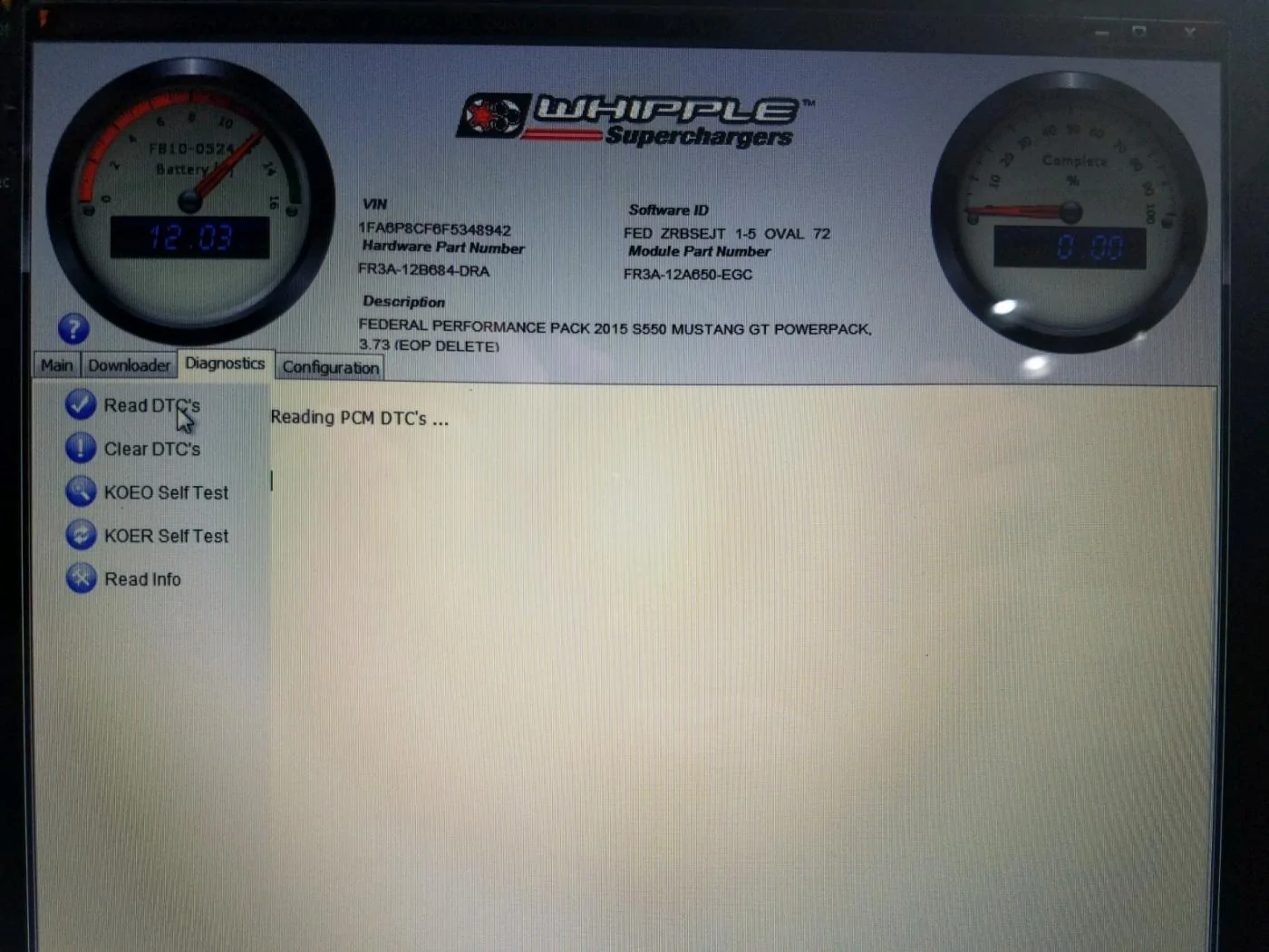

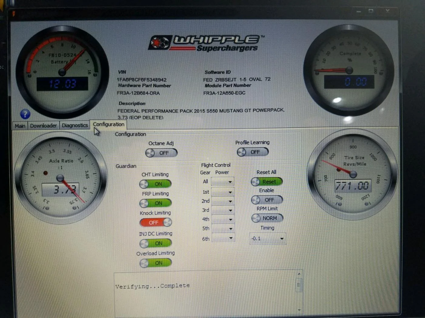

weird thing is it doesn't tell me its finished. Look at these pics. Also put the configuration page up as well

flash back to stock before every upgrade?
Why is knock off?!
Whipple will help you check flash is correct, but consider it may be something else like bad coil pack, plug, connector, air/vacuum leak, mechanical, bad gas, etc.
Strange no code... should be something recoverable.

If you can, when it happens again, don't shut it off until you plug it and check codes. Knock limiting is supposed to be off.
