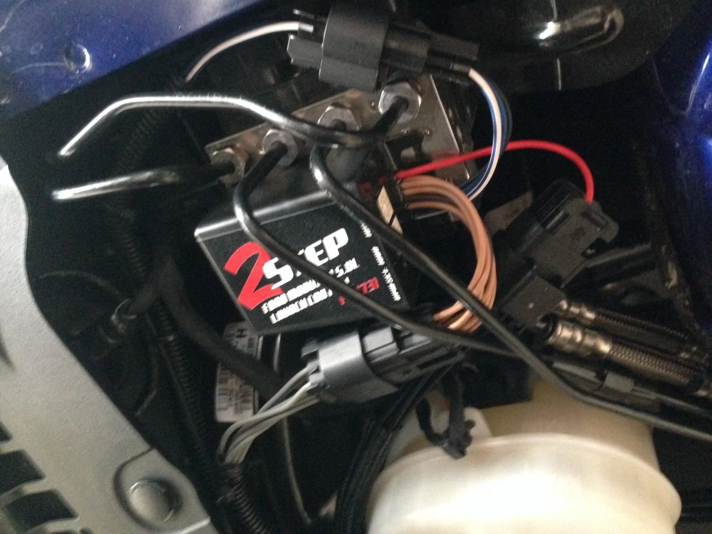

Yah, red and green led - couldn't remember lol. Take a look at my pic, left and right banks use the same interchangeable type plugs (different wires). Mine are buried in the loom so I can't tell you if red is left or right bank.

Ok it's confirmed its hooked up right as far as left to right. Swapped it around and had a horrible miss at idle and led didn't work. So that's figured out. Wonder if it's tune related? Those who have this, was your tuner aware and maybe he made some kind of change where it doesn't detect misfire?
