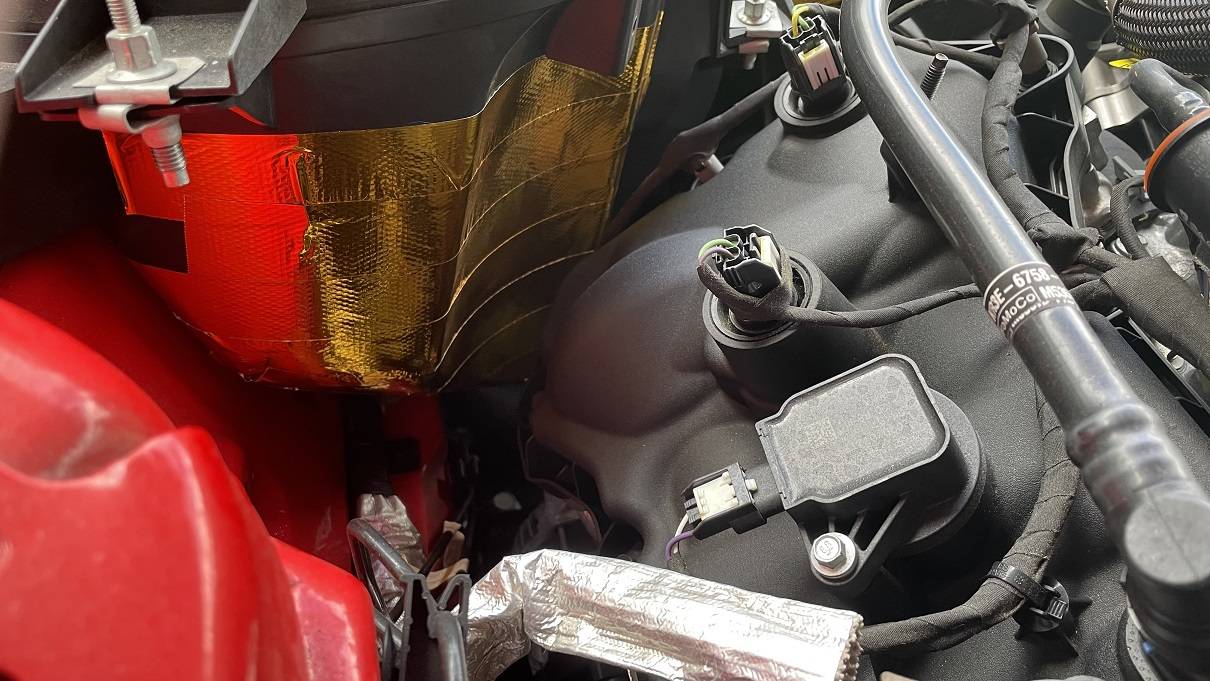

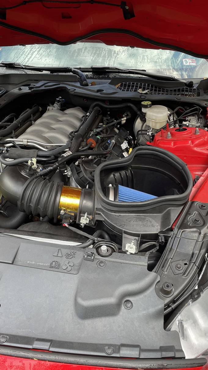

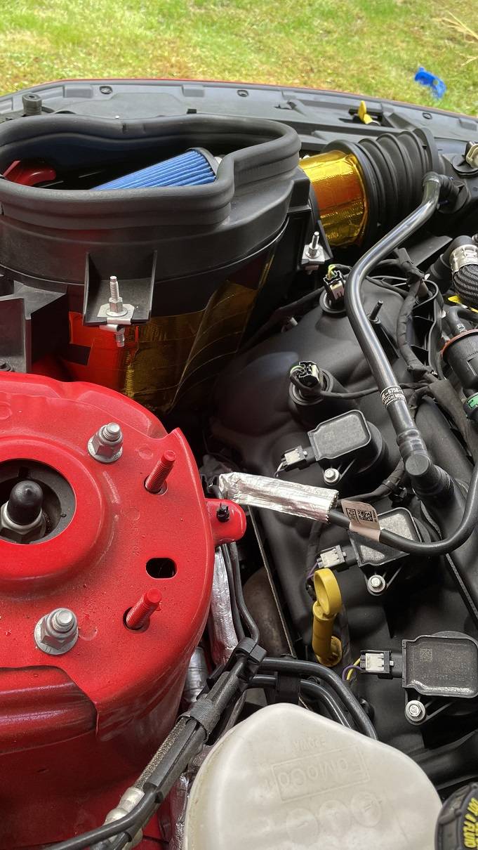

Here you go.
Thanks for the pics. What changes in IAT were you able to gain with the tape application? I see that you put it in what could be considered the spots with the highest radiant heat exposure. Do you plan to cover any more of the box and ducting?
Cruise or WOT IATs are not too different, I see 3-4* above ambient. However the biggest difference I noticed is how much slower IATs rise while I'm idling around in the pits and how much faster the IATs drop once I get moving. For the amount of effort and cost, I'm happy with the results.
For this unit, I don't plan on doing anymore. Like you mentioned, these were added strategically where the most radiant heating happened. Also since the intake is not really smooth it would look pretty terrible. Maybe if I had a charge pipe like the JLT I would do more.

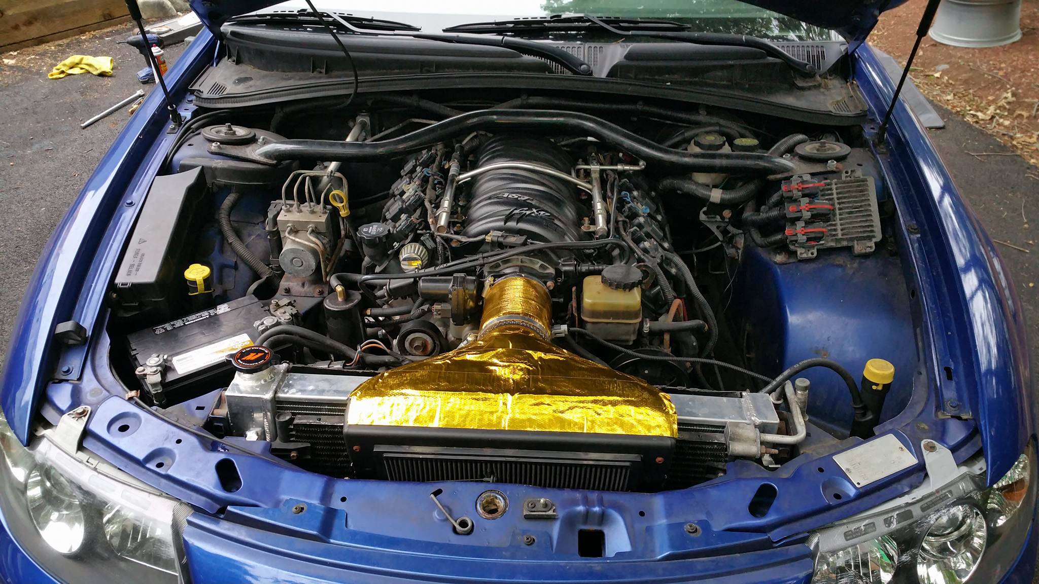

For reference, on my other car I did alot more coverage simply because it was a smooth intake so easy to apply, and the intake itself as you can see in the picture below sat directly on the radiator so it needed a radiant break.
Gotcha. Like I have said previously, I may have to take this direction. It is just that visually it has very little appeal to me. For the time being I am going to keep looking for a spray on solution and little things like the box hood seal. Failing that I may be forced to go the NASA look. Thanks for your input.

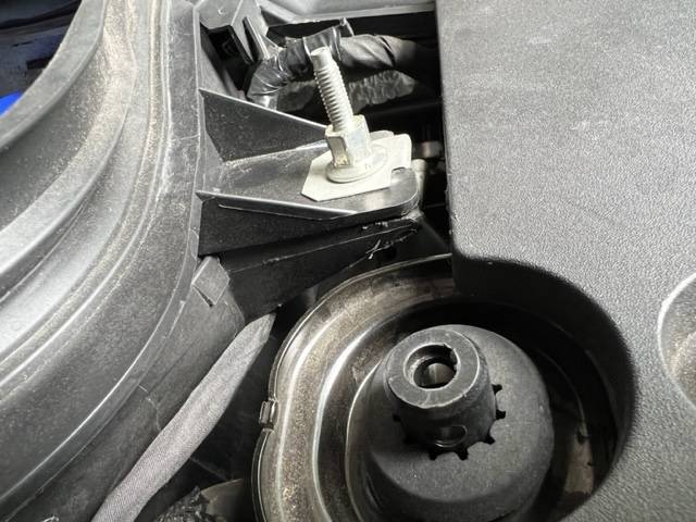

Yes, had to trim the front hold down bolt tab and drill a new hole on the GT350 box.
OK, so the seal is attached to a plastic piece that attaches to the top of the 350 airbox?
