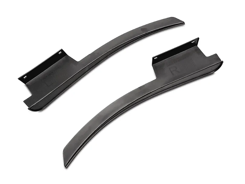

However, I just realized there are special Mach-1 wheel moldings.
  • Front (pair): VMR3Z-16268-A
  • Back (left): KR3Z-6328371-AA
  • Back (right): KR3Z-6328370-AA
Hence, questions.
  1. Do I *need* those to fit Mach-1 HP wheels onto GT PP1 car?
  2. If not need, would they do any good anyway?
  3. Will they fit?
for back ones, this kit explicitly mentions fitness to GT. Which I read, if I order the full kit, it will fit my GT PP1 no question.
but for the front ones, it says "Will fit other Non-Mach models, but modifications are required." What exactly does it mean?

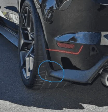

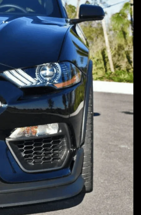

Hi Artem,
The front ones are not required but recommended to help reduce road rash from the aggressive offset these wheels have, See below
The rear ones you have listed are specific to the GT500 but I cannot confirm either if they are the same ones used on the Mach 1 models. The issue with those is I dont believe they will mate up to the GT rear valance well and may require some modifications. The area of concern is shown below

I have those guards pictured on my 2019. Those are MP designs.
There is a small gap as seen. But I do think will serve their purpose. I hope.
The screws are behind the fender liner. The same bolts that attach that section to the rear valance. The fender liner covers them up once installed.

Thanks Benny! My main concern is that your website mentions that some “modifications” are required to fit those front moldings on non-Mach1 GT. Can you please share some specifics?
Bonus question is whether I'd need any additional hardware to mount them.
I believe a few new holes need to be drilled into the fender liner for all fasteners to be installed. This is a very minor modification but should be expected.
yes, this is according to the Mach 1 parts spreadsheet thread.
This is less of concern to me, since your GT500 rear kit specifically mentions it will fit a GT. So I'm planning to buy the entire kit just to be on a safe side. (Even though it might be an overkill.)
If you buy the complete kit then the wheel arches will not be a concern as they will mate up properly.
