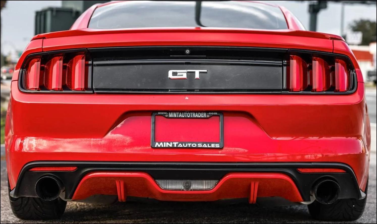

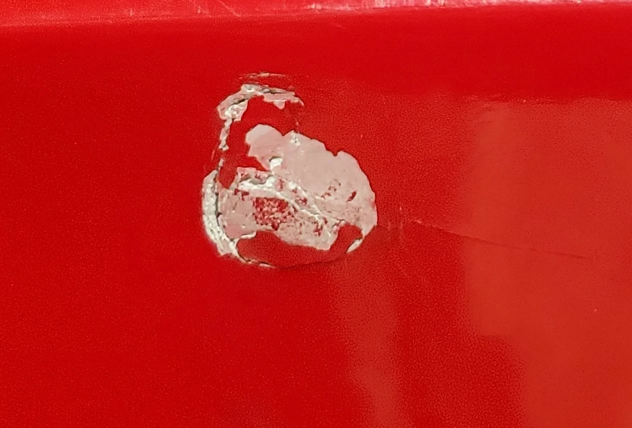

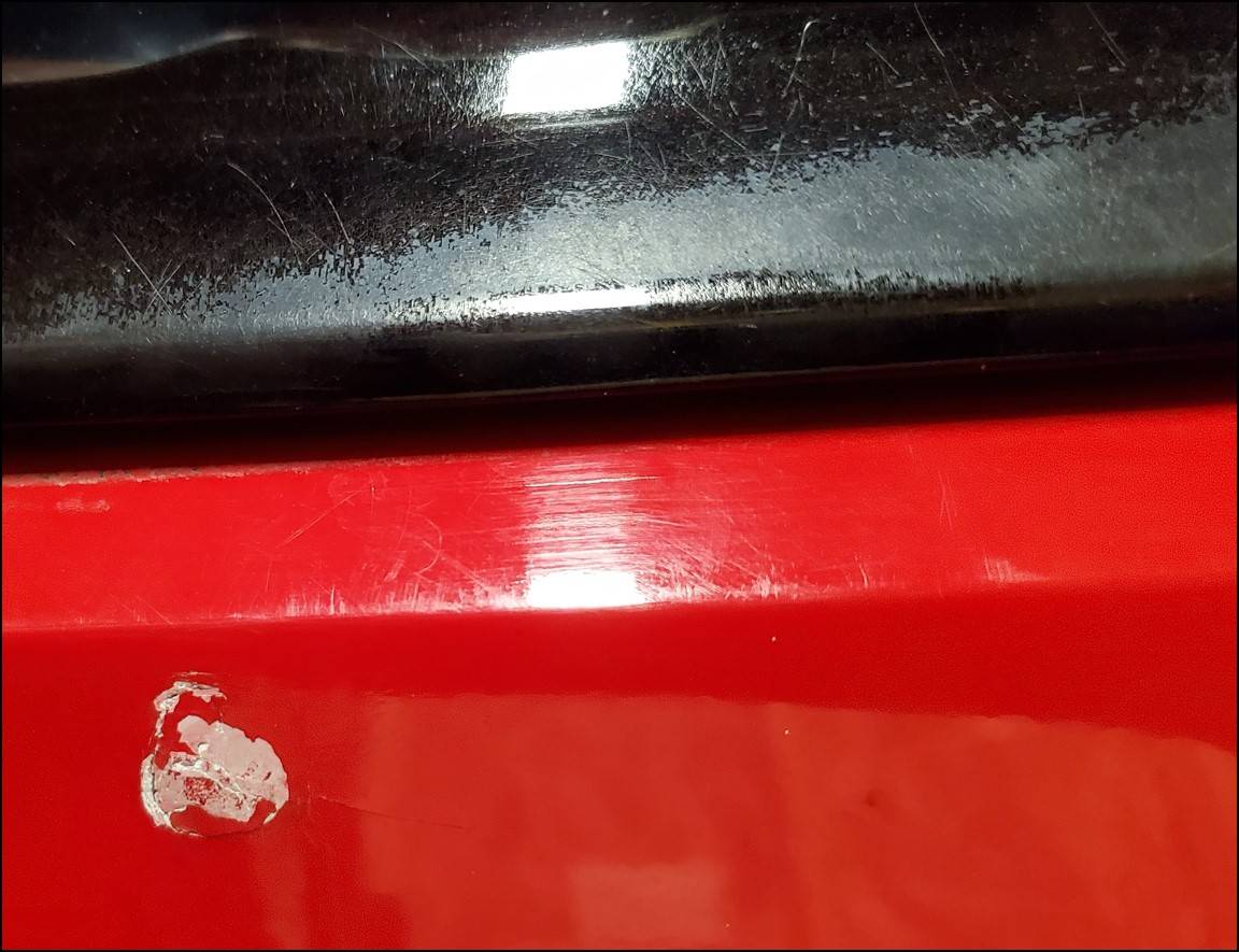

My "Mint" Auto Sales 2016 GT came with a thumbnail size damaged spot and a tail-like crack extending a few inches on the rear bumper cover. It's directly below the license plate. I have no idea what the previous owner did to cause this but in my time I've done some things to my cars that make me cringe (e.g. hung a shovel on a rack right beside my several months old 1995 Mustang GT with the predictable outcome). The trunk panel is no prize either but that's a issue for another day. Is something this size able to be addressed DIY using light sanding, touch-up paint and clear coat? I'm not looking for perfection, just make it less out-there in your face noticeable.
I'm hoping to avoid having to get the entire bumper cover professionally re-sprayed. Then of course the paint shop will say they need to blend the newly painted bumper cover into the quarter panels but then the doors won't blend nor will the front fenders or hood or front bumper cover or roof. Sorry sir, properly fixing this thumbnail size monstrosity will set you back about $5K.

Ah, screw it. I'm just going to have at fixing it myself. If I make a mess of it, it's really no worse off than it is now. No guts, no glory.

If it were me, I’d just source another factory bumper cover the same color and swap it out. Usually can find them on eBay or most salvage yards and the color would be factory so the shade of red should match pretty well.

The right way is to take it in for a respray.
I personally would take some 2000 grit and knock down all the sharp edges and then tape generously around the spots to take some 2k spray clear.
The bumper’s already beat to bits and these Mustang’s won’t be concours cars.

A few days ago I ordered the Squirt ā€˜n Squeegee Plus Kit from Dr. Colorchip. It's supposed to get here on Saturday. There are several small stone chips I'll start out trying to fix first and then move on to the pimple on Oliver's six. If I can get it to be at least less noticeable from 50 feet away, that's good enough for now. If not, I'll probably look at having it professionally corrected.
