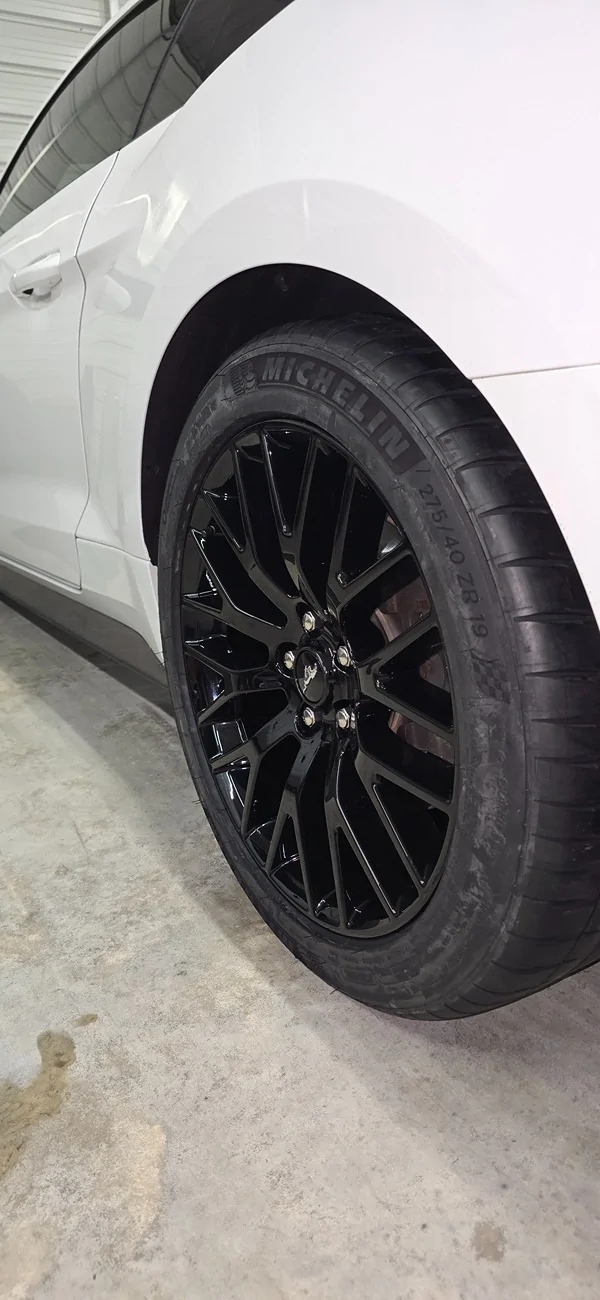

I recently bought a tire change machine and balancer because I wanted to do my own tires from now on. I was doing great but I guess I tagged the TPMS sensor when dismounting the old Pirelli tires. Now I just get a exclamation point on my dashboard. Three of them work, the left rear doesn't. I ordered new sensors from Amazon that say they fit. I hope so. I have the relearn tool in case the new ones need to be trained. It sucks to have to dismount a tire I got perfect on the balancer. These tires are definitely hard to mount due to either low profile or stiff sidewall. My skills are definitely lacking but I guess it comes with the territory I'll break one or two in the future probably.

I ordered these from Amazon and they showed up today. I was able to break the beads on the tire and use the 3rd arm on my tire machine to push down the tire's bead/sidewall around the valve stem and get a t10 torx bit in there to remove the broke one. The old one doesn't show any signs of damage though. The new one was hard to pull into the hole. I had to use the tire valve stem tool and a huge pair of chanel locks. Tire still was wet with tire lube from yesterday. Aired right up. I was disappointed yesterday after realizing I broke it but glad it was a quick fix. 40 dollar mistake.
Ford wanted 100 dollars for one tpms sensor! 😆
