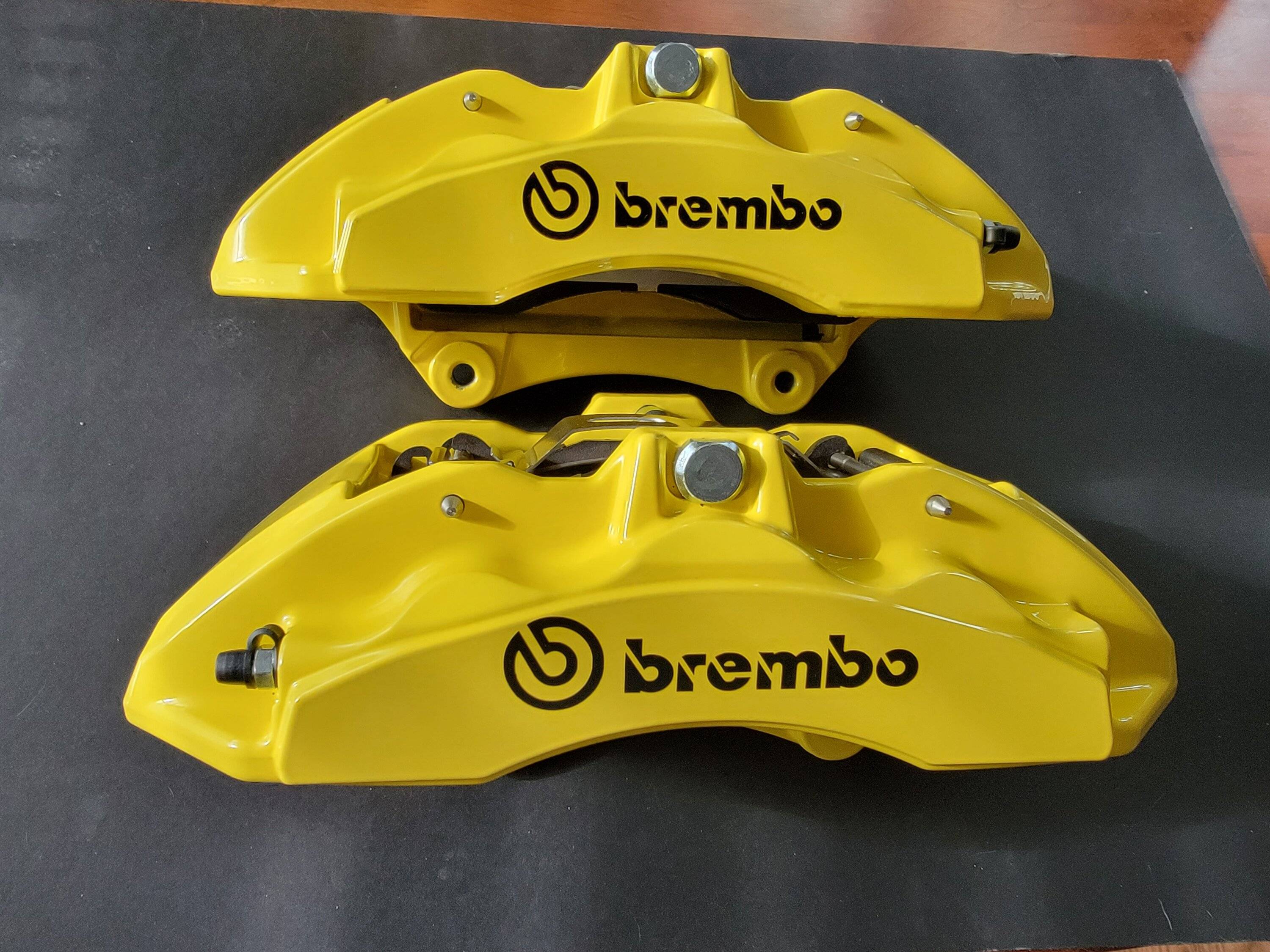

Mine did the same. In my case I believe it was the soap my
touchless car wash uses. I removed them, rebuilt and powder coated them. Now no problem.
