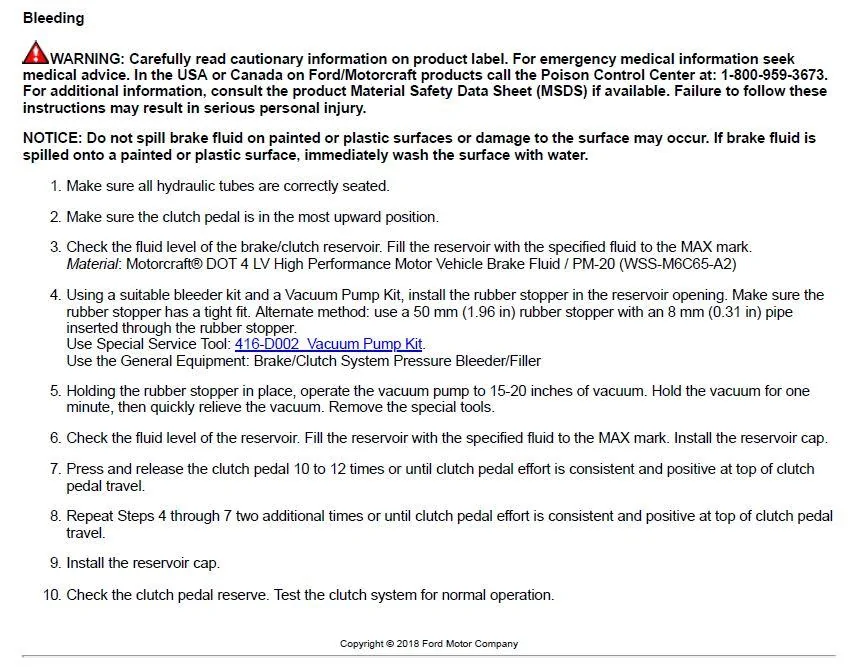

Has anybody with a manual transmission done this Brembo swap? I'm trying to figure out if I should expect to need to bleed the clutch line as well?

Wouldn't think so. Not as long as you never let the level in the master cylinder's reservoir get too low, anyway
I didn't touch the clutch hydraulics when I installed the SVT/GT500 4-piston Brembos and S/S flexible lines on my '08. No reason to expect the newer cars would be any different.

I think the clutch feeds from the master cylinder's reserve bottle, but its a different system. Same fill container, different pistons and lines.

I did the swap with a 6 speed. Used a motive power bleeder and only bled the fronts.
No clutch issues and rock solid brake feel and response.
Stock pads.
