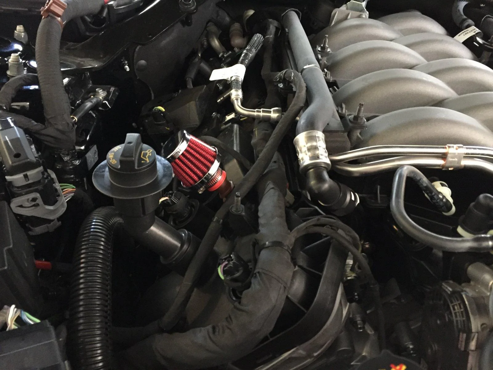

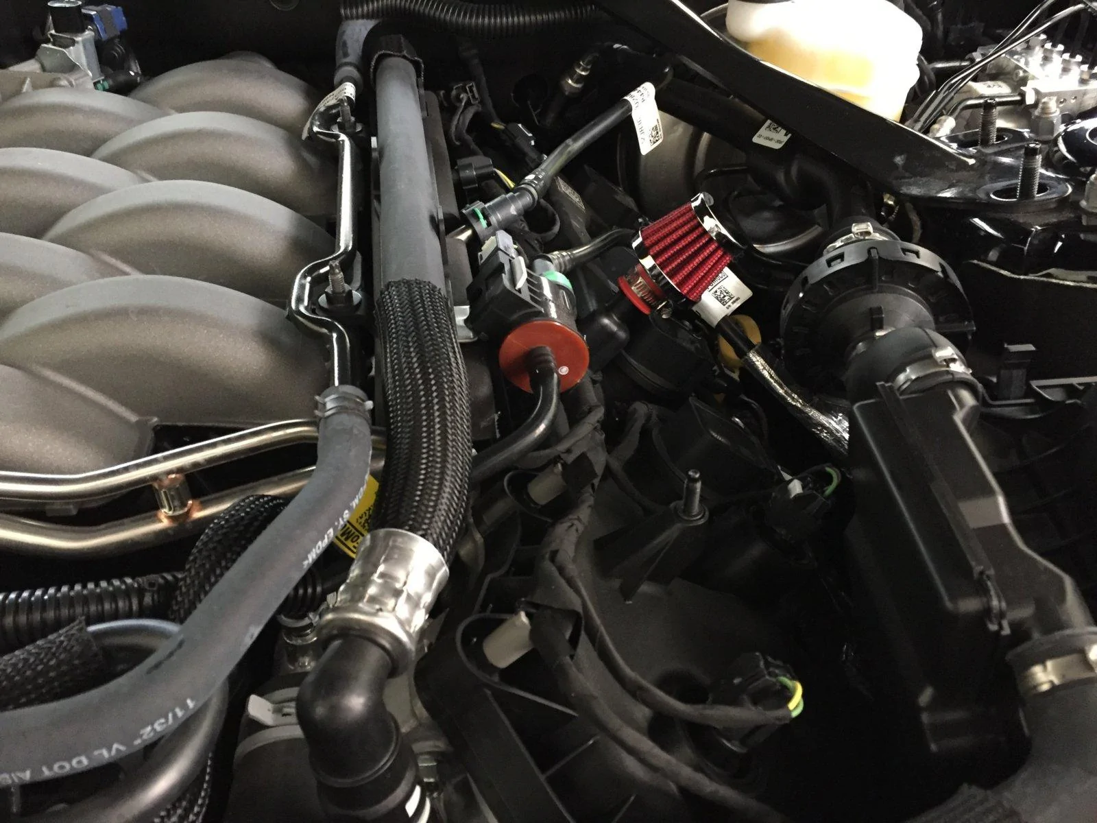

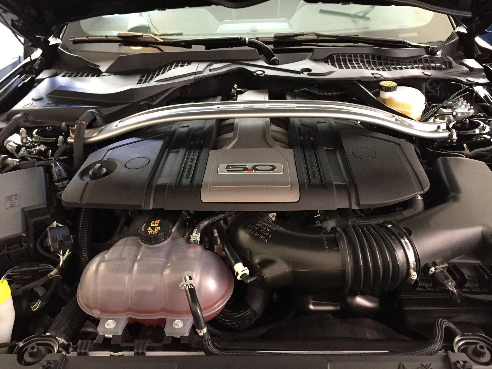

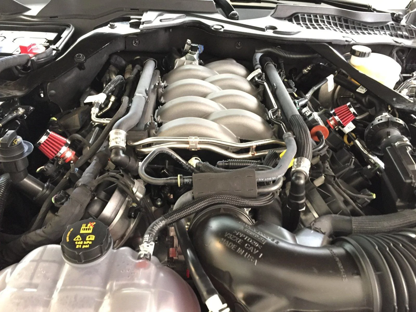

I know everyone likes the catch can, but for those who would like to ventilate the crank case in addition to keeping oil/vapor out of intake track these are easy and cheap. Autozone Edelbrock breathers plus Dorman vacuum caps 3/8 inch (2). $33 bucks and 30 minutes to put on 2018 GT PP1 car. Fits under pancake engine cover. :).

Note: Take 1/2 inch drill bit and open the rubber holes just a tad so they slide on easier. Make sure to blow/shake out the filters after drilling. Fyi. :).

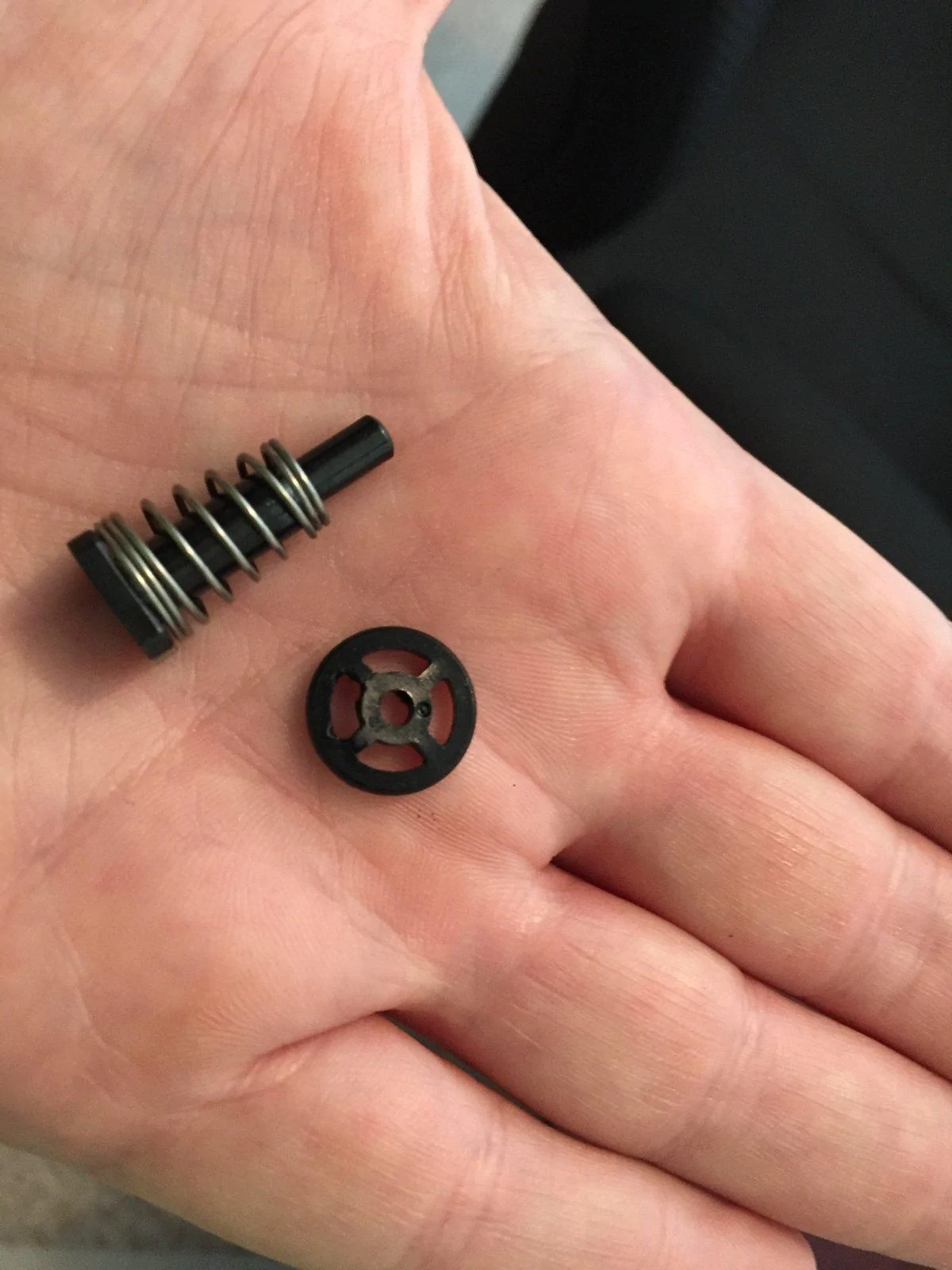

Remember with breathers you should be pulling out the check valve ball from the stock PCV valve on the passenger side so it will be open like the drivers side. passenger side only opens under vacuum, if there is no vacuum it always stays shut, otherwise you’re only evacuating pressure from the driver side.

Yes, you are correct. I did forget to mention that one small step. Just take small flat head to pop out check valve on passenger side pvc valve.
