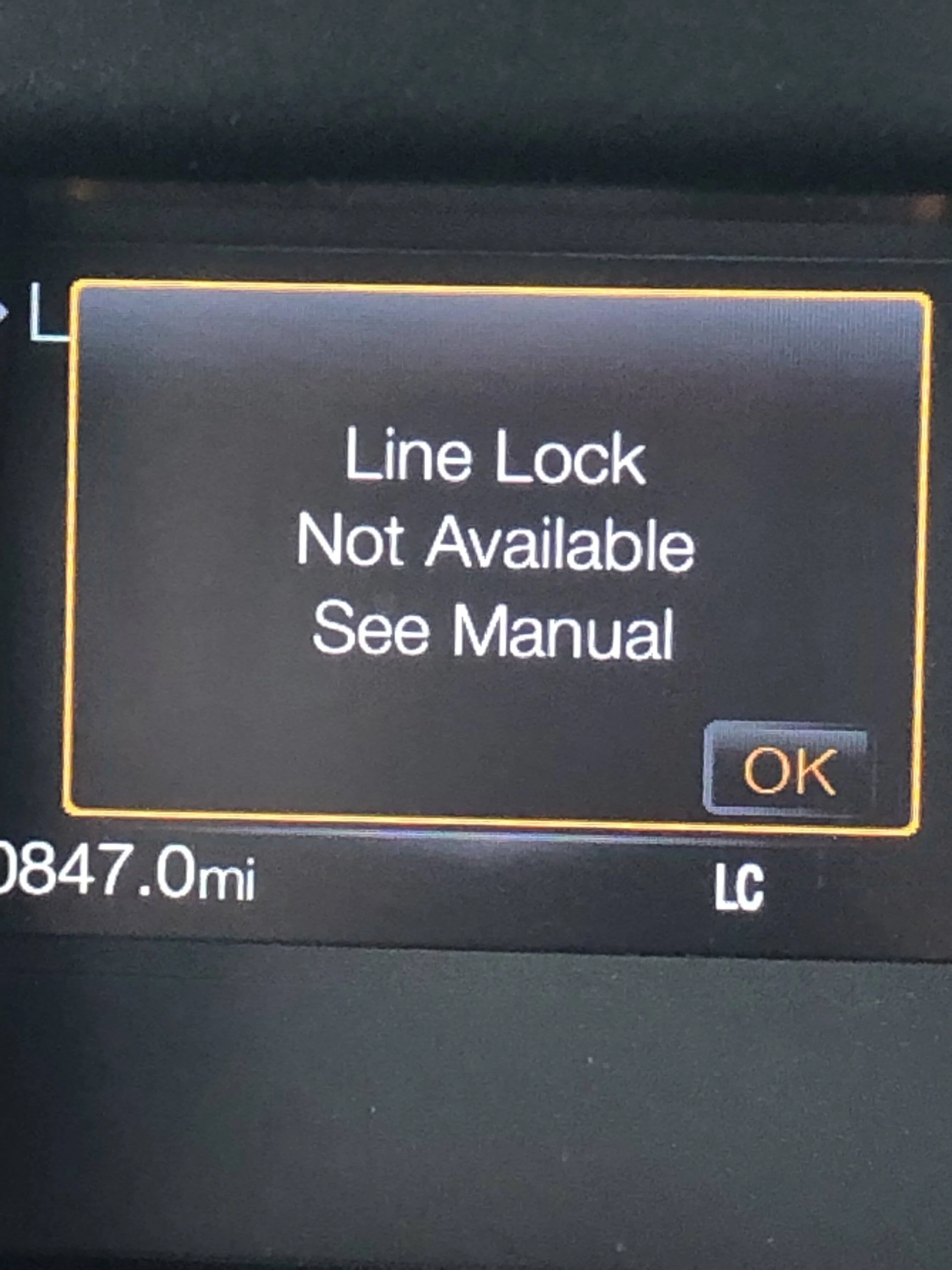

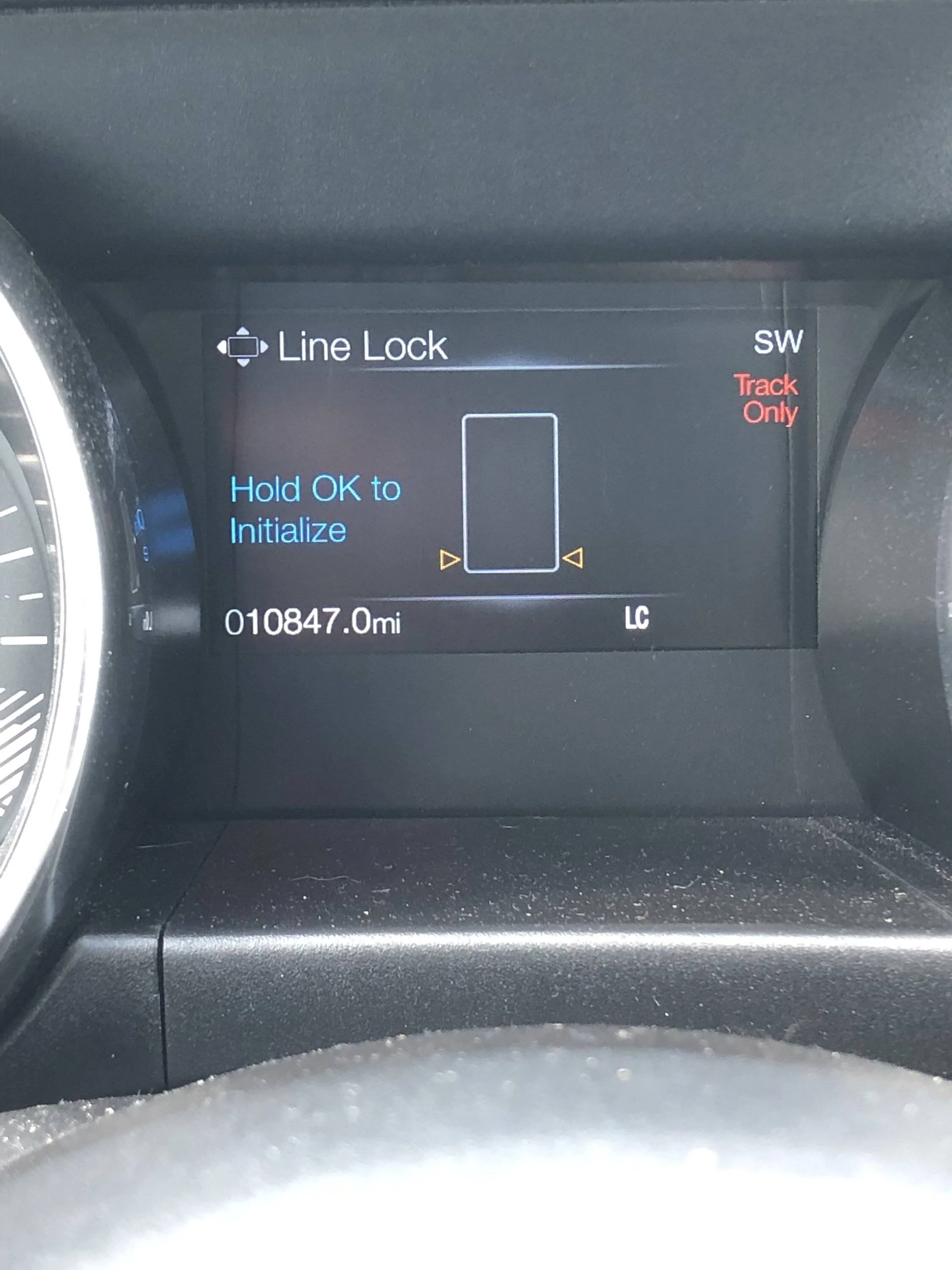

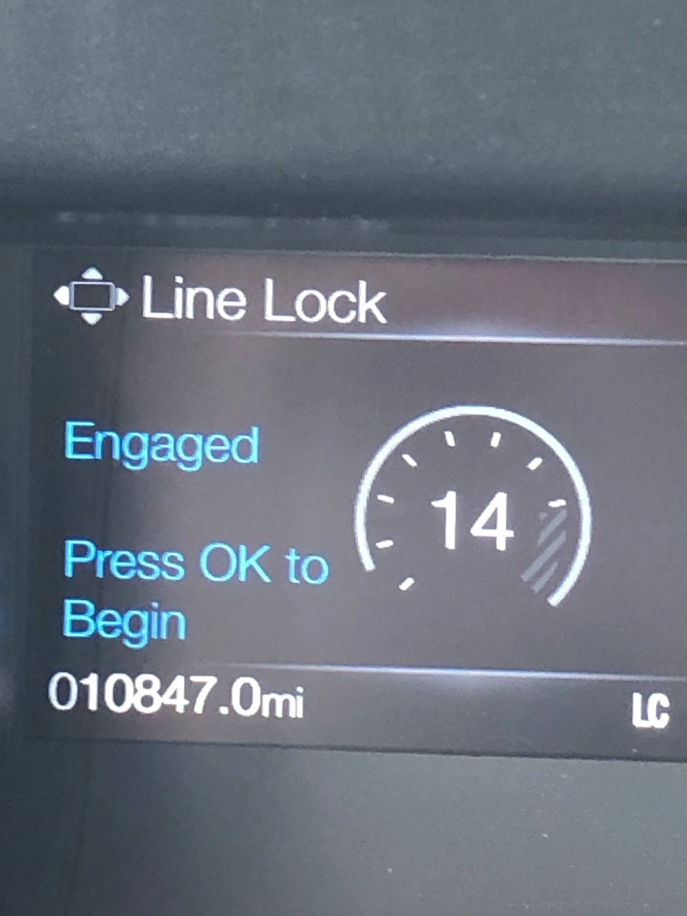

Here is the "official" how-to video from ford
I see the animation of the pedals appears to show a clutch pedal,
but doesn’t show what to do with it.
Yesterday while trying to use the line lock, I was in 1st gear with my foot on the clutch as I went through the procedures.
It went wrong the same way every time, so I started taking pictures
I got to the timer, where it gives you 15 seconds and says “Press OK to begin” and I can press OK as well as the next guy…
And I got this error message every time
We’re sure manual cars have this feature, right?
So, what could be the problem?
EDIT: I wonder if I'm making the same user error as this guy...
Was user error. I sat on side 'til I figured it out...
1) Hold OK to start line lock
2) Push hard on brake
3) Keep holding brake then click ok
4) Do burn out...
After step two I was letting go of brake then clicking ok.
I'll have to try again.
The manual could really be more explicit. Neither the manual, nor the video above, nor the prompts on the screen talk about when to let go of the clutch pedal or whether to let go of the brake.
I think this is what I needed:
Key part is after the "step on brake" step KEEP your foot on the brake while the OK screen comes up and press OK,
DO NOT move your foot between the two steps,
only remove your foot from the brake after you hit OK and hear the line lock engage.
