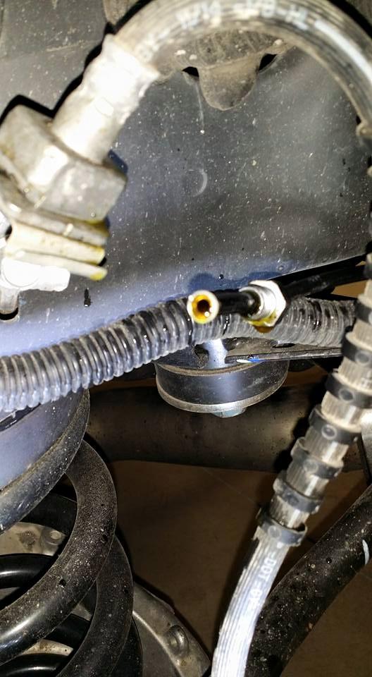

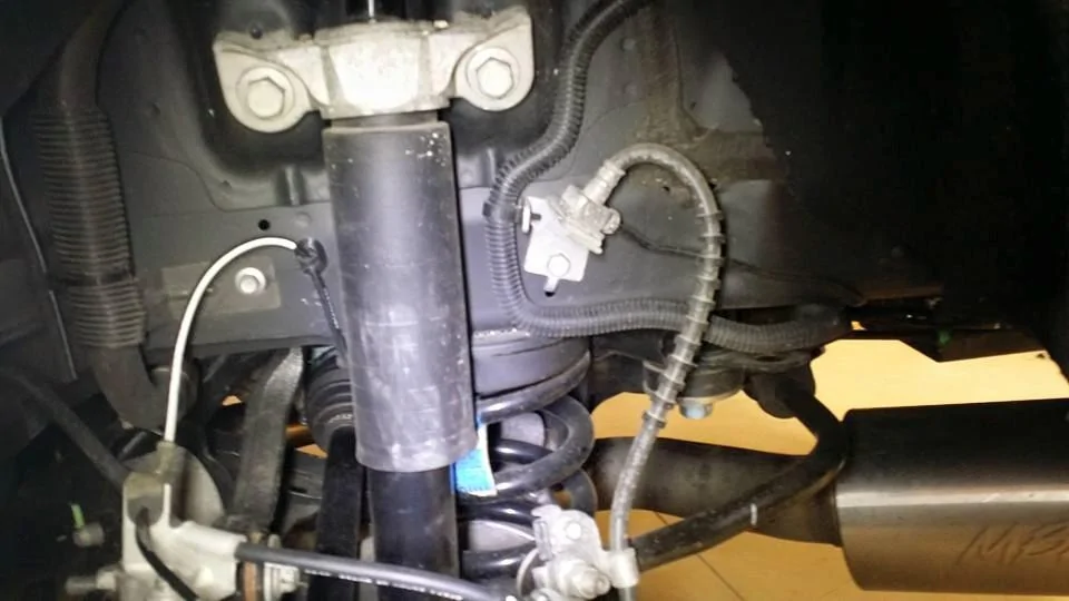

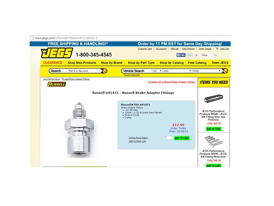

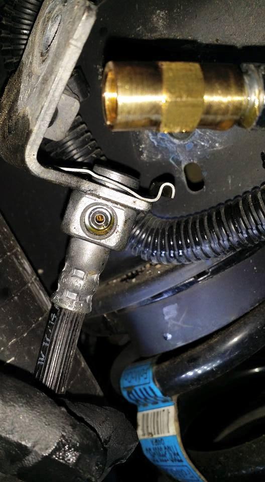

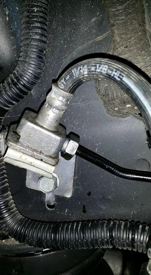

I'm trying to locate a -03 AN Male to a M10x1.5 Inverted Flare Female adapter I've found -03 AN to M10x1.25 & M10x1.0. I attached what it will look like and where I'm using it. I figured a Road Racer may know. If I could find a M10x1.5 union I could get it done, it'll be one extra connection.
