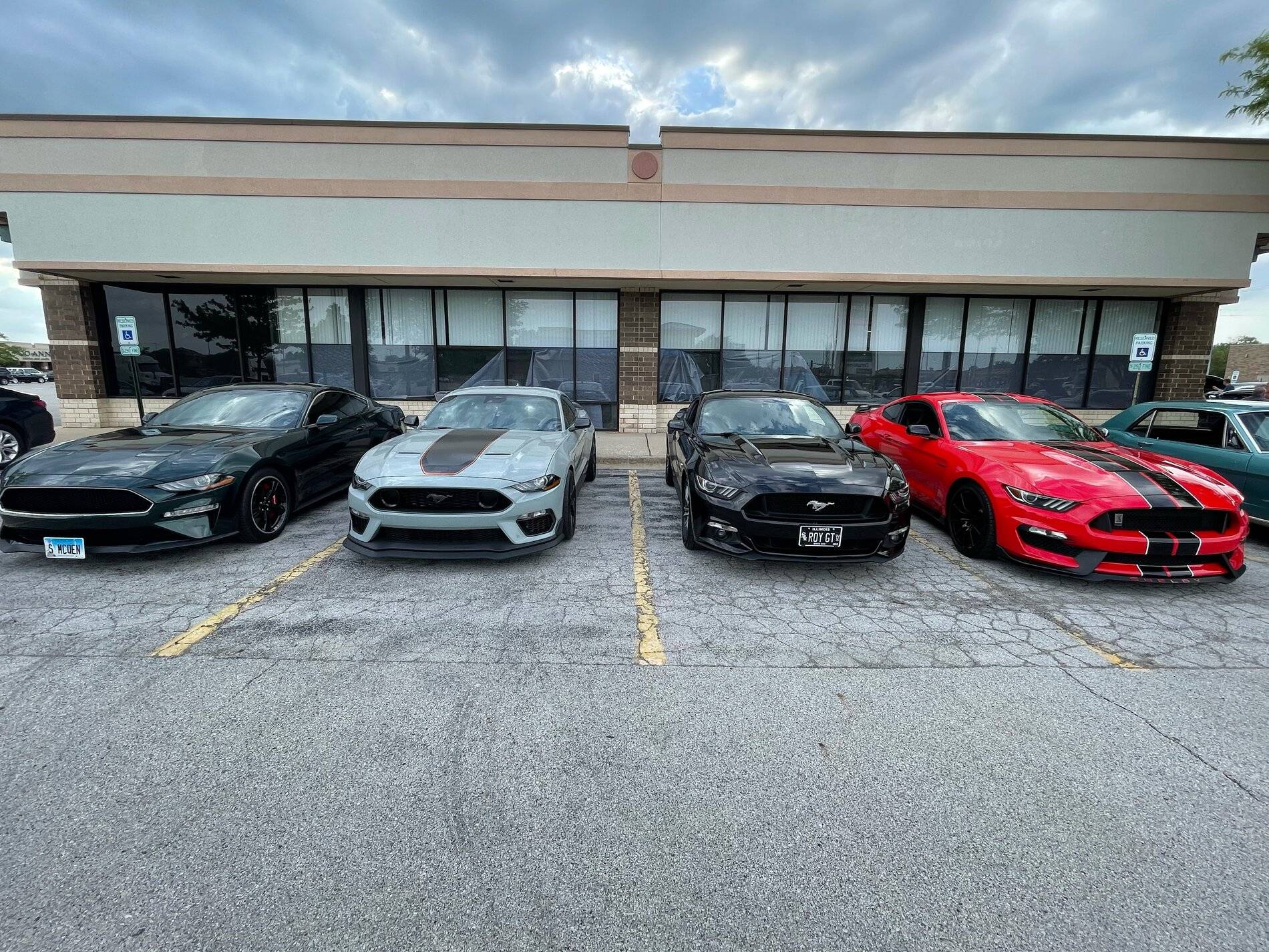

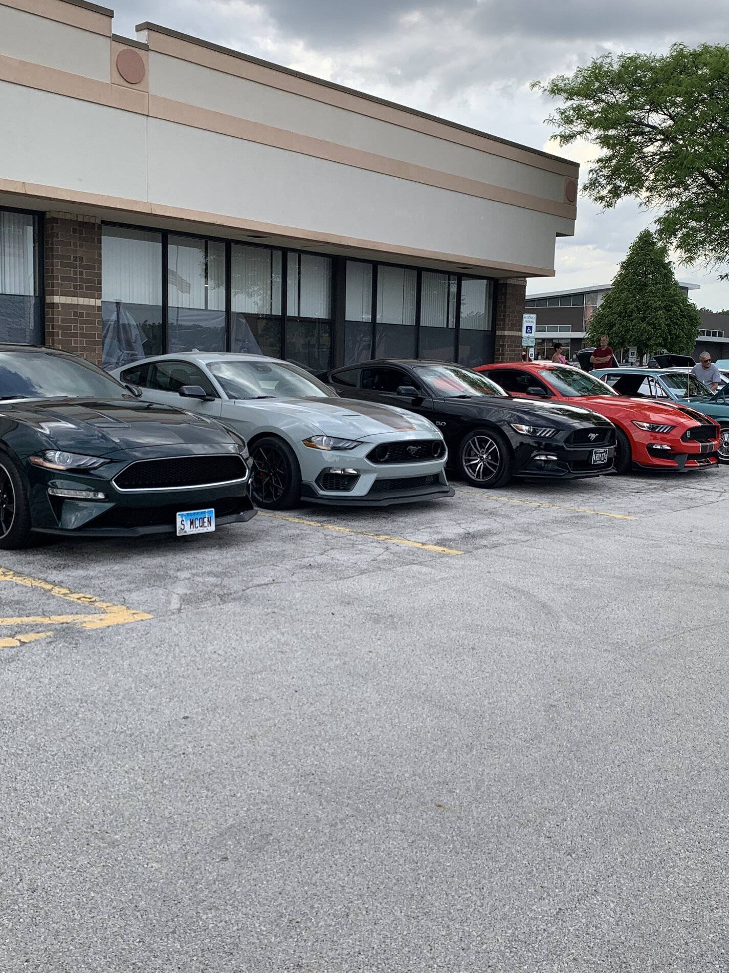

I hate my car came with the continental 4 pistons brake calipers. All my buddies cars (Bullit, gt350 and Mach 1) came with the Brembo 6 pistons brake calipers. I know all of their cars are high end mustangs compared to mine. So my question is how hard of a conversion job and expense will this be? Here’s a couple of pics of all of our cars together.
