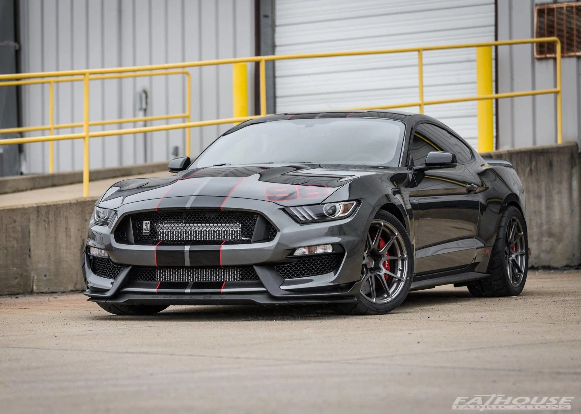

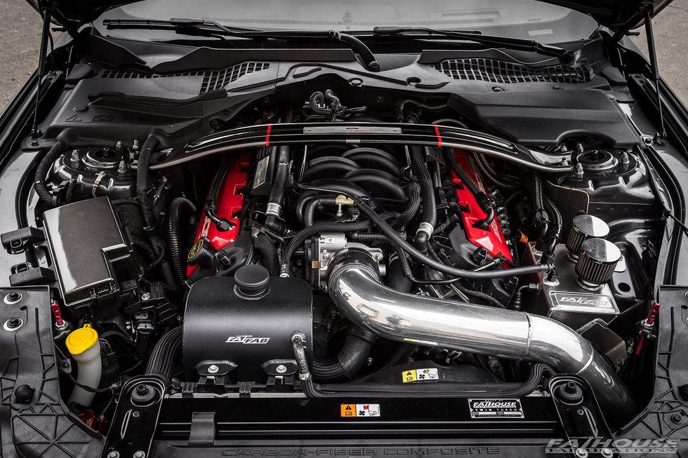

Hey Guys,
Seems like there are numerous 350's that are supercharged. Since I plan on doing the same, I'm interested to see what brand your running, boost level, fuel type, supporting mods if any, hp levels, how long you've been running the kit & mileage and if you experienced any issues.
Here is my girl (The new system of uploading photos is fantastic) 1348 HP, Fathouse 1200R package with Motec..

I've got a GT350 that Fathouse Twin Turbo'd for me. The car is simply incredible with 1318 whp. I would highly recommend Fathouse to anyone that it considering Turbo's or supercharging their car. I went back and forth with the Whipple before deciding on the turbo route. I have other TT cars and a Demon, Hellcat and Cobra Jet with Whipples and they're also big fun, and high quality. Definitely, at a minimum change out the OPG/CS.
Holy moly.

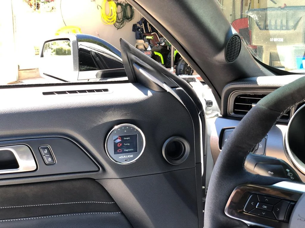

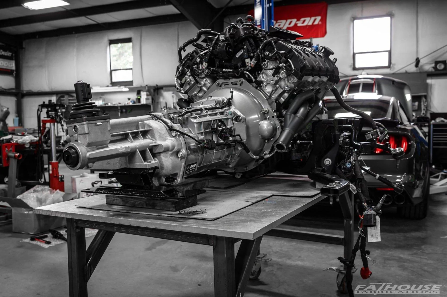

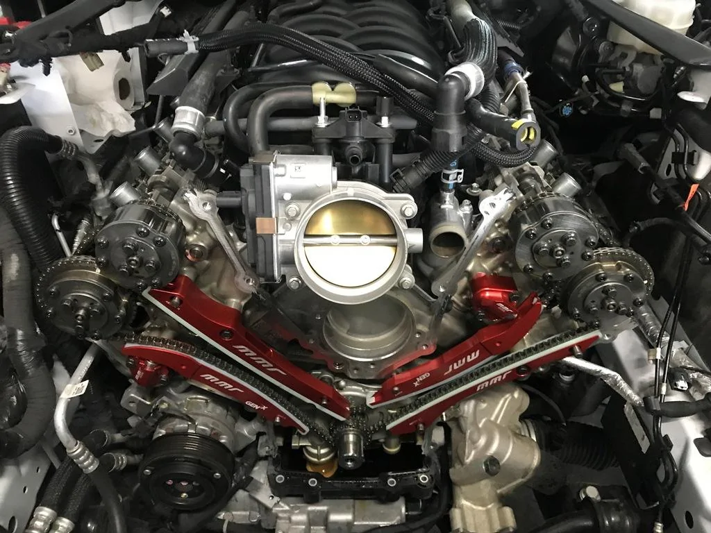

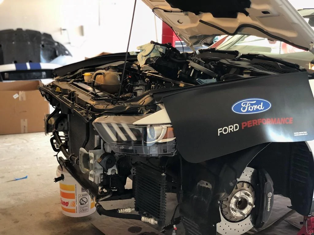

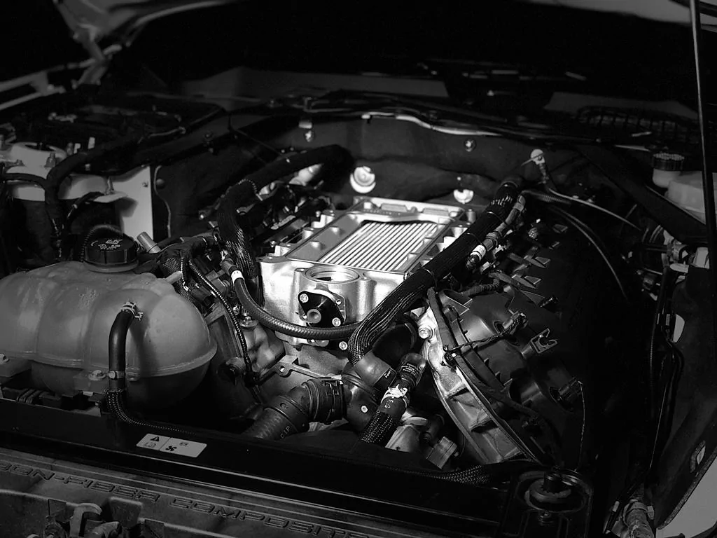

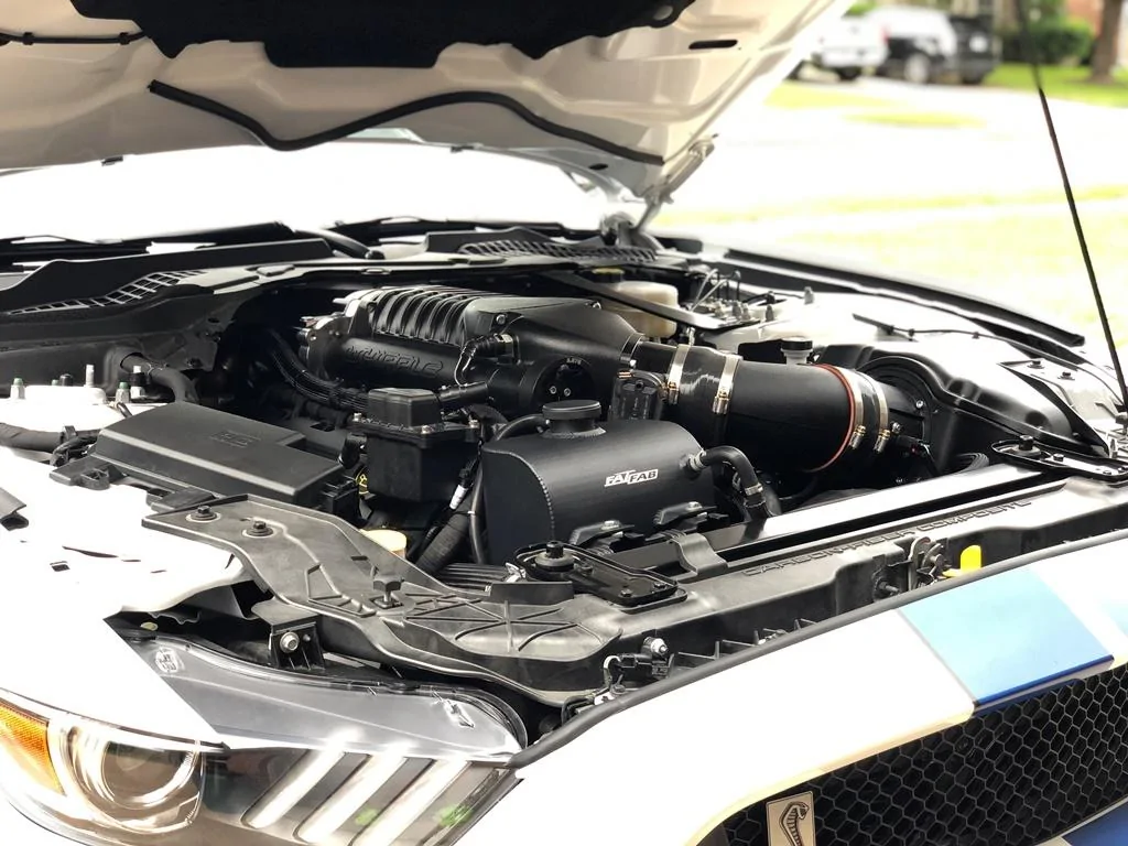

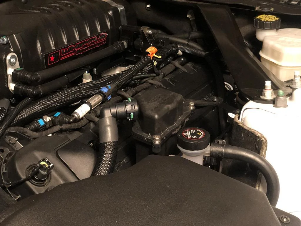

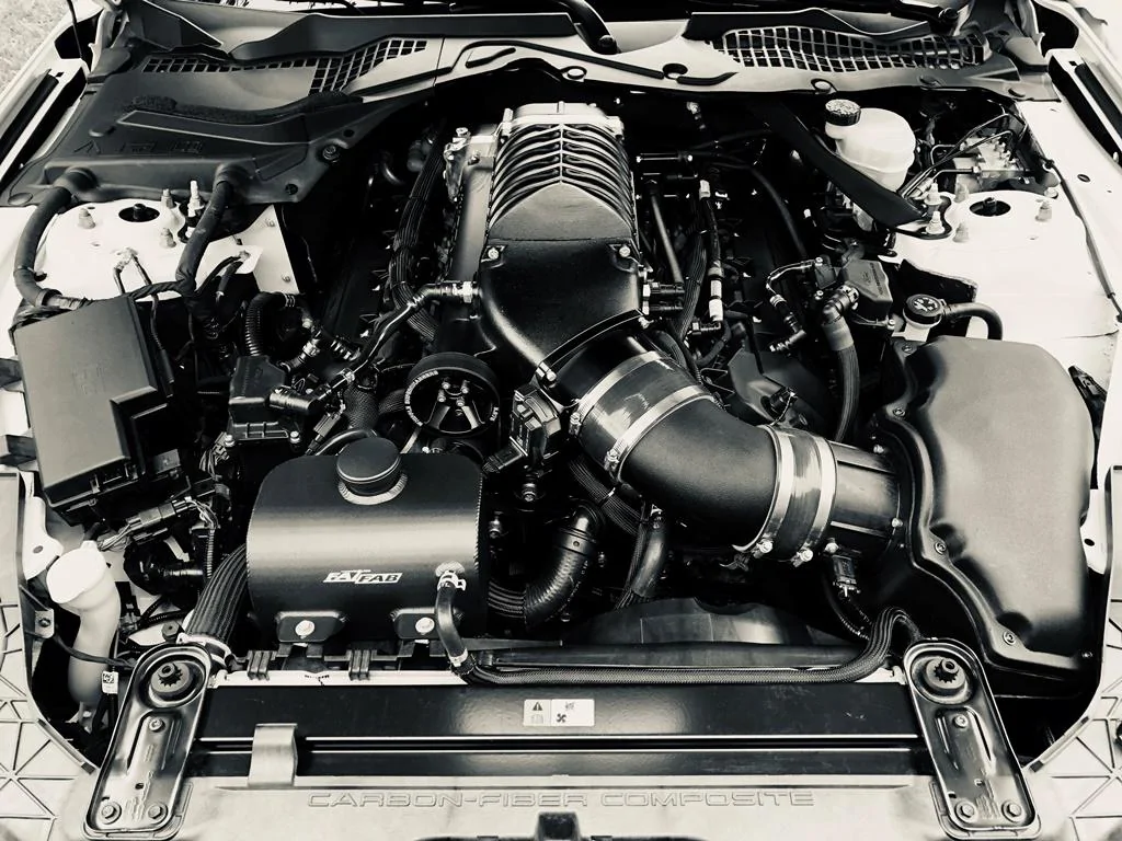

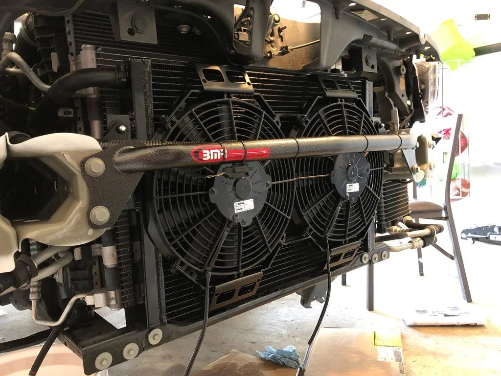

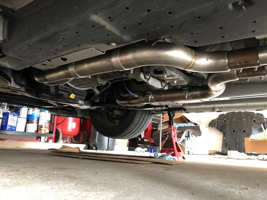

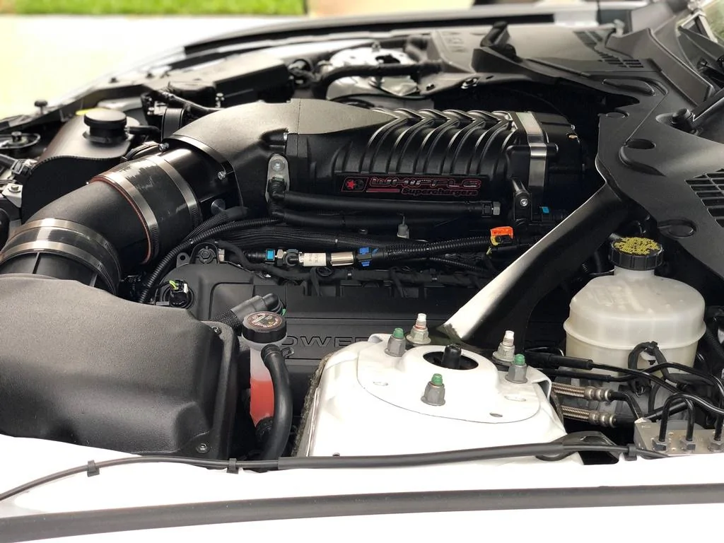

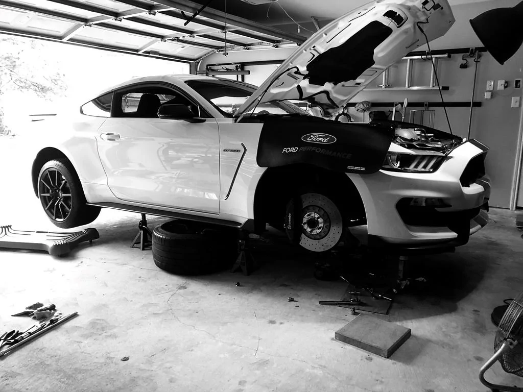

Hey gents,
I recently went forced induction via a Whipple Gen 4 Supercharger and supporting mods. Figured I'd post this on the forum...
Chris @Heideman Racing Dynamics installed the following components....
MMR Billet Oil Pump Gears
MMR Billet Crank Sprocket
MMR Billet Tensioners
MMR Billet Timing Chain Guides
The day I received the car back from HRD, I took her back apart and installed the following mods over a 4 day weekend....

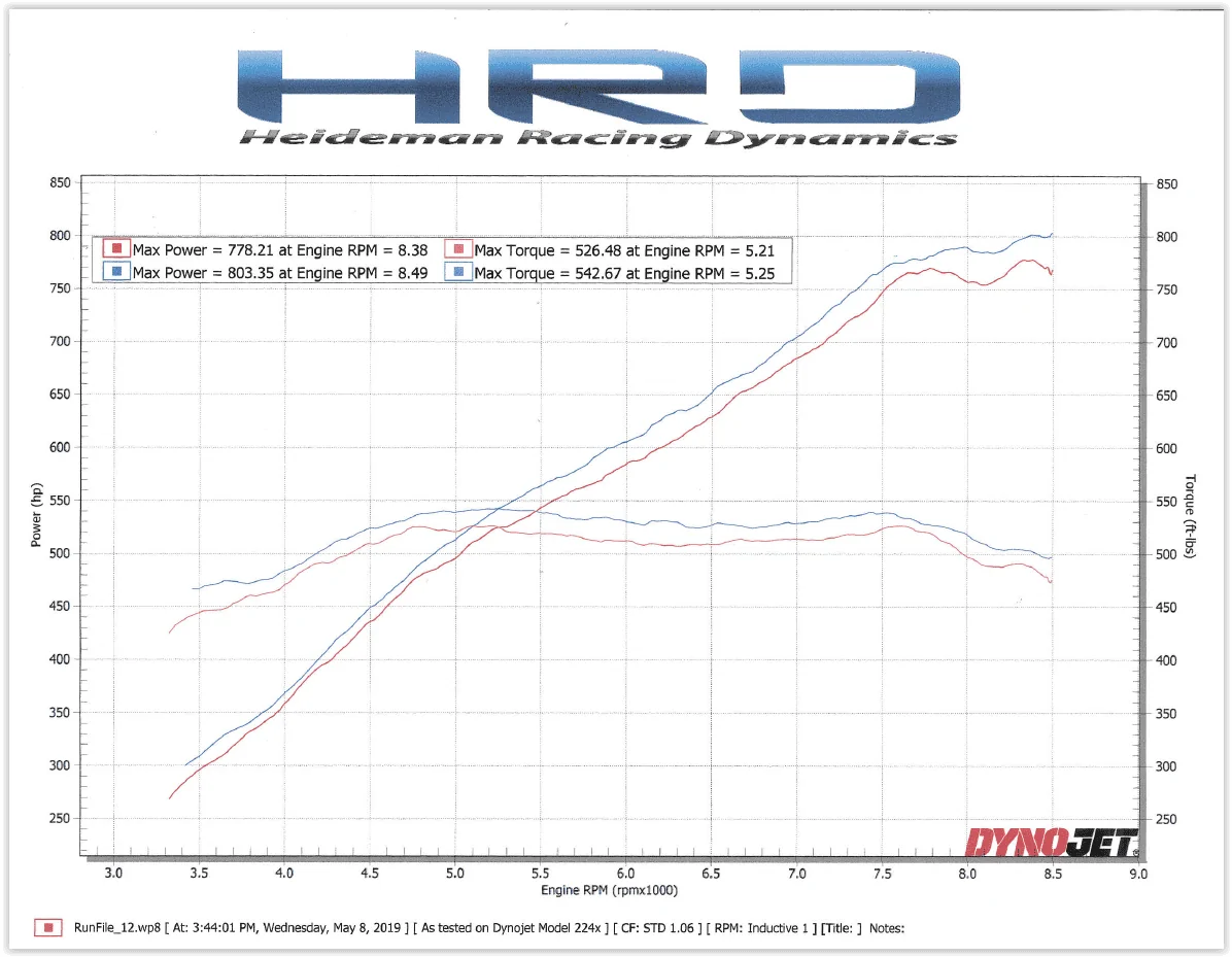

Whipple 2.9L Gen 4 Supercharger Kit w/ 3.875 pulley
Stainless Works Long Tube Headers w/o Cats
Shifteck H-Pipe w/ FM Resonators
BMR Chromoly Front Bumper Support
Lethal Performance Dual Fuel Pump Boosters
Fathouse Fab Coolant Reservoir
Ford Performance Driver & Passenger Oil Separators
Tuned by Rob @Palm Beach Tuning via nGauge
Initial tune netted 787 whp & 526 wtq on 93 octane.
I'll be tuning once again this Wednesday with a 3.750 pulley to complete this 93 Tune. (E85 may come later this summer.)
EDIT: Tuned on a 3.750 pulley netted 803 whp & 542 wtq on 93 Octane
