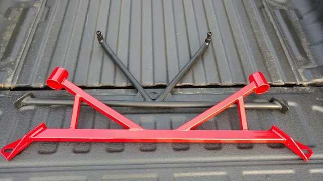

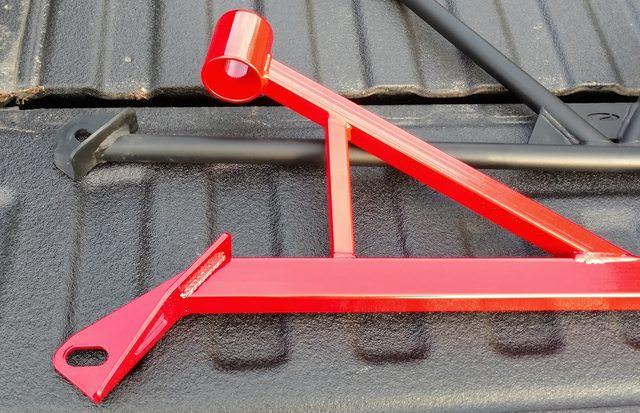

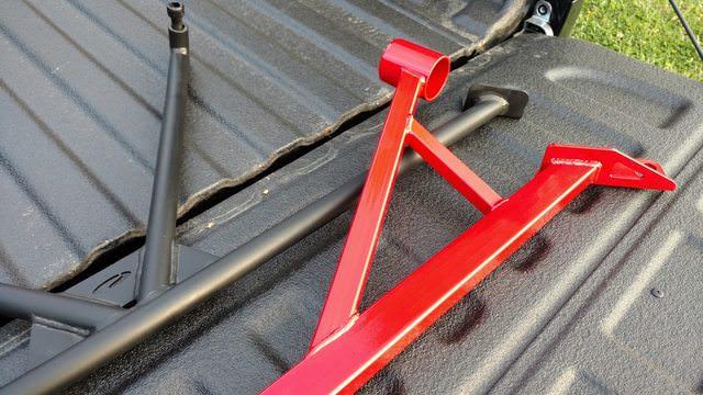

[MENTION=13317]Coaster[/MENTION]. Nice!
Ah so that is what you sold the G trac brace. :)
Yeah side by side there is no comparison. The BMR part uses thicker stock, beefier hardware, is properly triangulated, and uses a much stronger front mounting location.

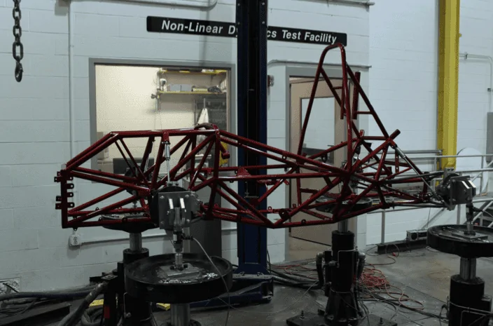

These are the real questions that need answered and this is what is important to design for. Most OEM operations have a target stiffness that they have deemed acceptable after years of correlating stiffness data to real world testing. The way in which the OEM manufacturers test this differs but there are a few basic ways that it can be done. Below is a picture of a hub to hub torsional stiffness test on a race chassis. In this case the dampers are replaced by solid links, and two rear hubs are held in position and one front hub has an upwards force applied while one front hub has a downward force applied. Strain gauges and linear potentiometers measure the force and deflection occurring in order to measure how much twist occurs per how much force is applied. This can also be done simpler by bolting the rear of the car to an I beam, supporting the car down the centerline on a razor edge object and then hanging weights from the hubs and continuing to measure the deflection as weight is added.
