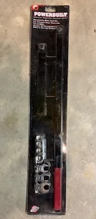

2 tools that help tightening the inboard arm bolt: 1) a shallow/low profile allen wrench and a Serpentine belt 2-piece breaker bar with crow foot socket. ( it helped with removal also)The bar I bought has a few crow foot open end wrench sockets but did not go up to 18mm so you have to buy that as well. There are other ways to tighten that nut but I found this to be the easiest given the limited space, especially if you want to get to the 105 ft/lbs BMR recommends
