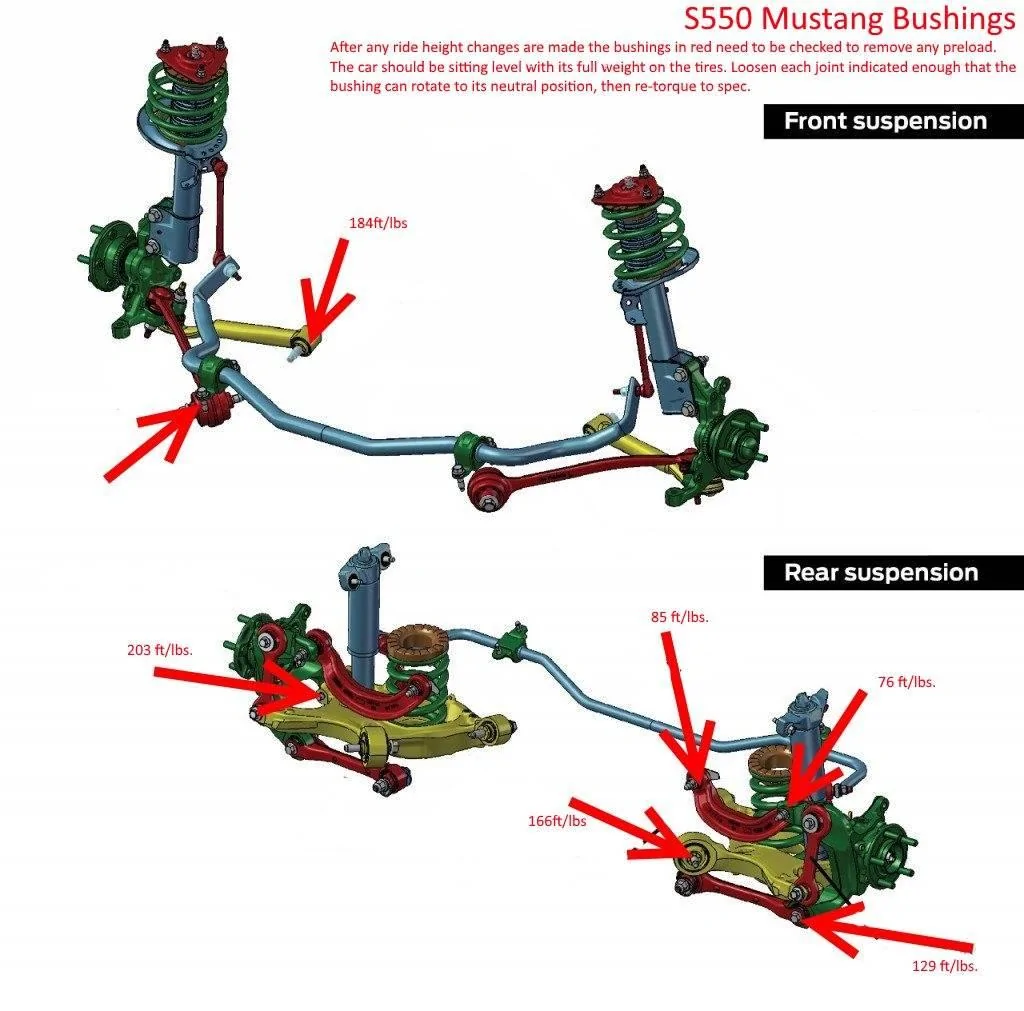

This s550 suspension is a ton more complex then the 11-14 cars. Its critical to get it right. Mine will be installed next week and you can bet im going down there with this diagram:
