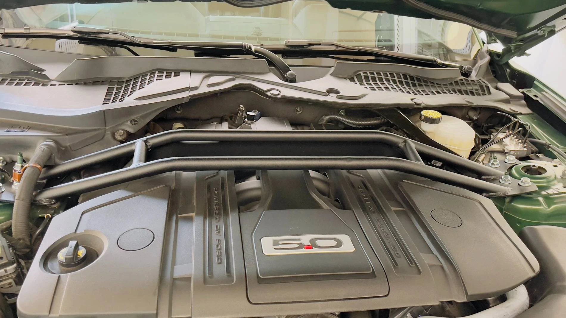

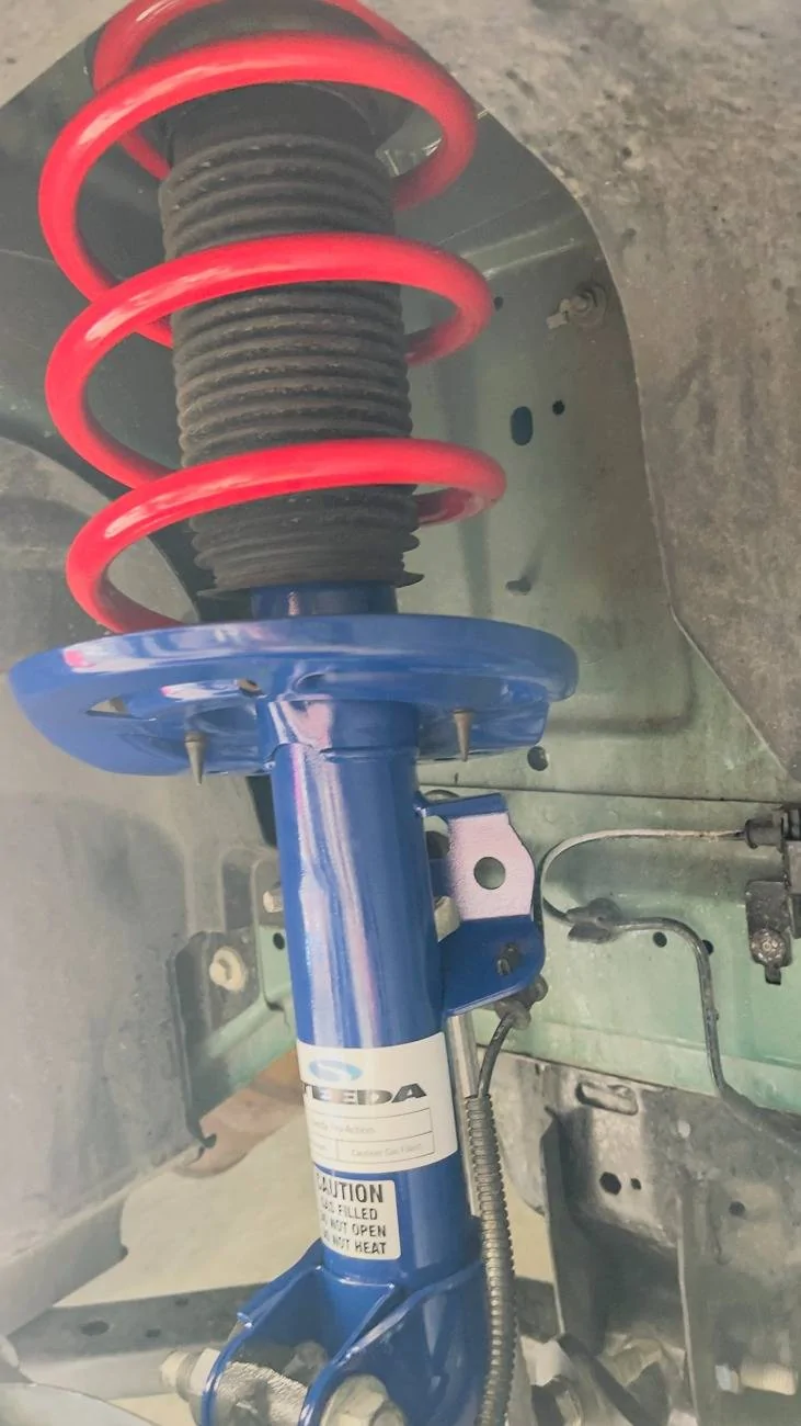

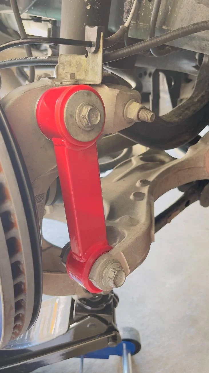

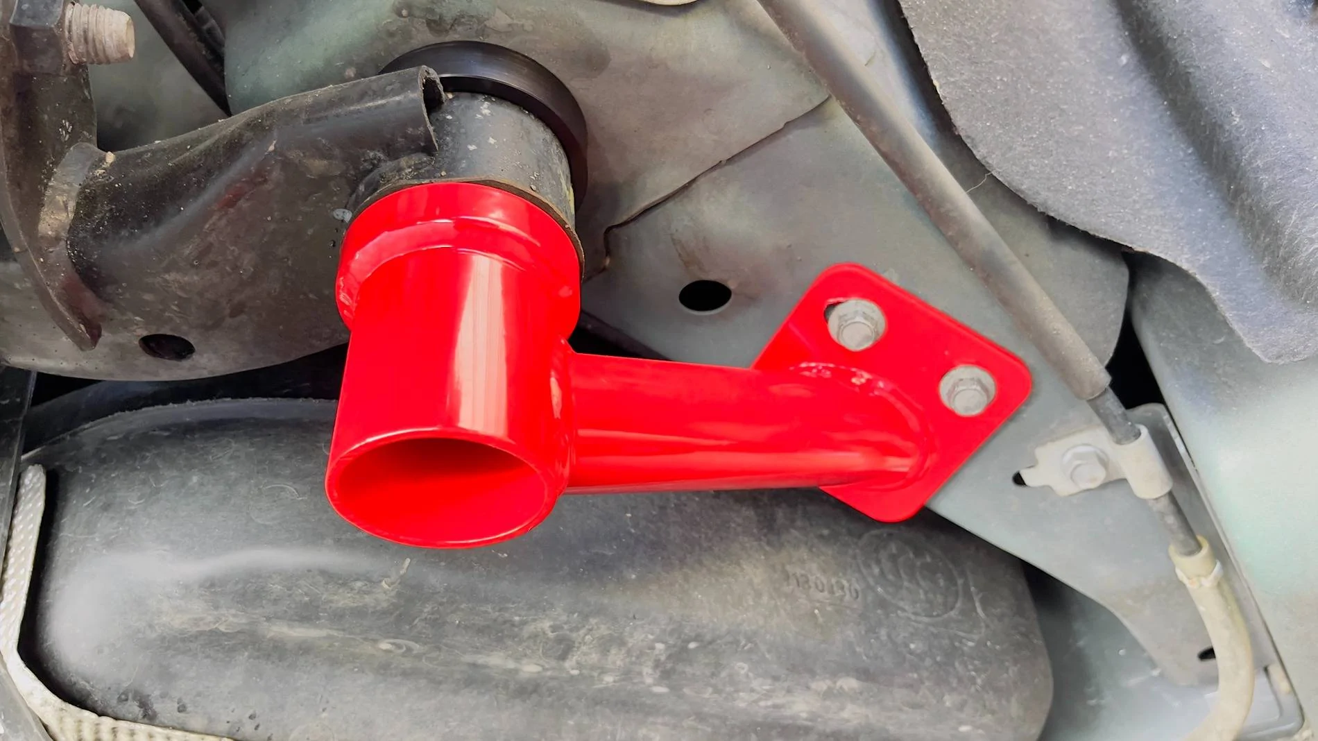

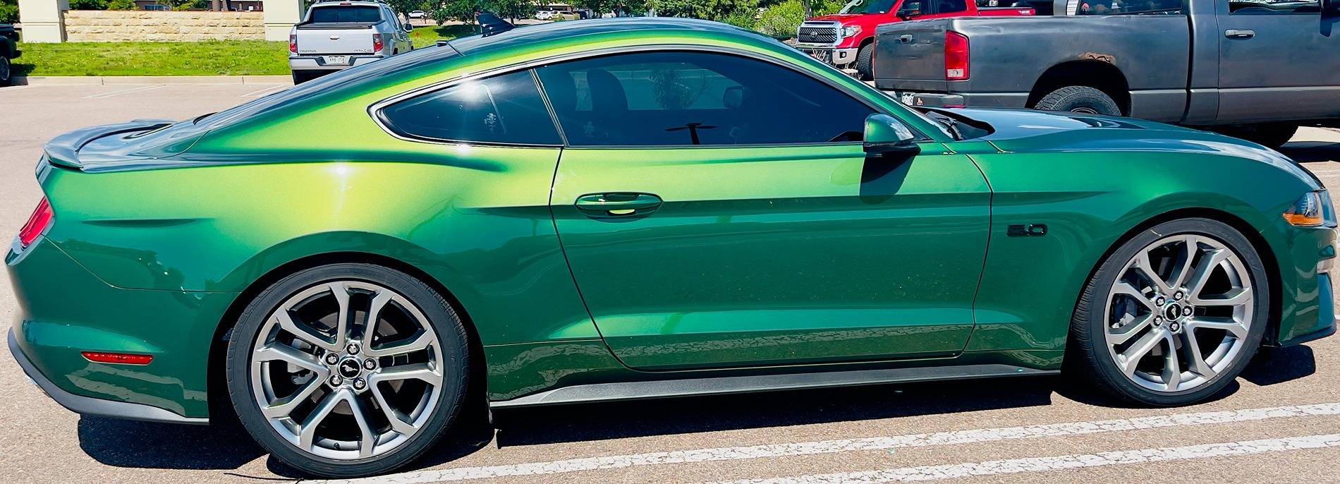

Last weekend I installed:
BMR SP763 springs
Steeda Pro-Action shocks/struts
BMR TCA048 vertical links
BMR cradle lockout level 2
SR Performance strut tower brace

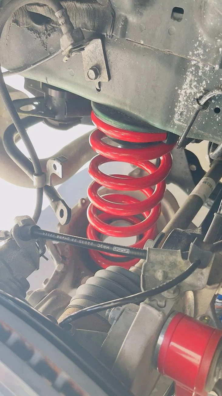

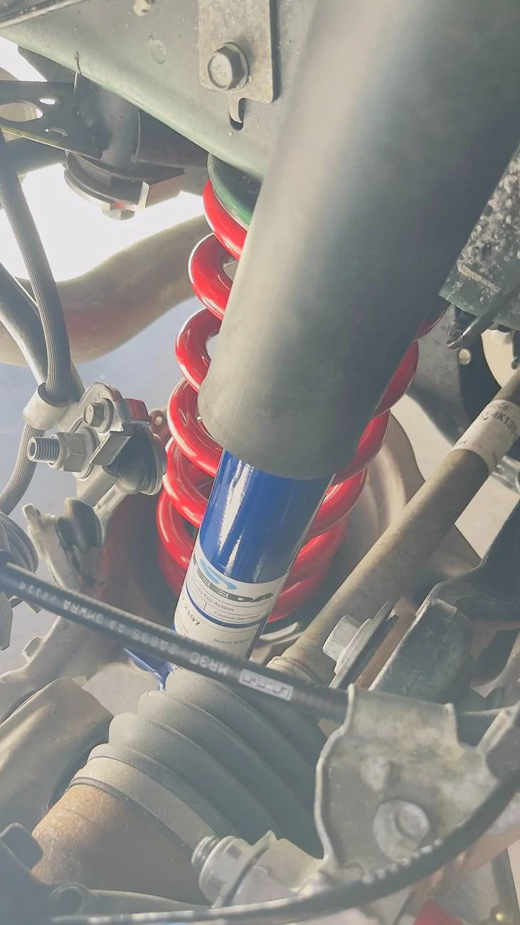

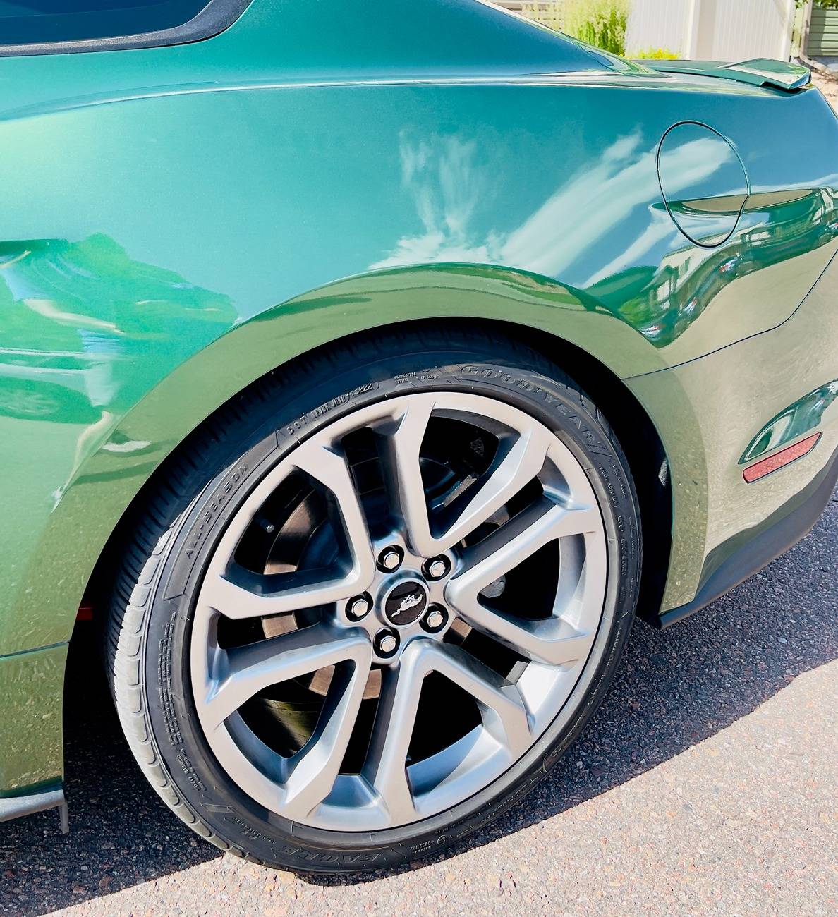

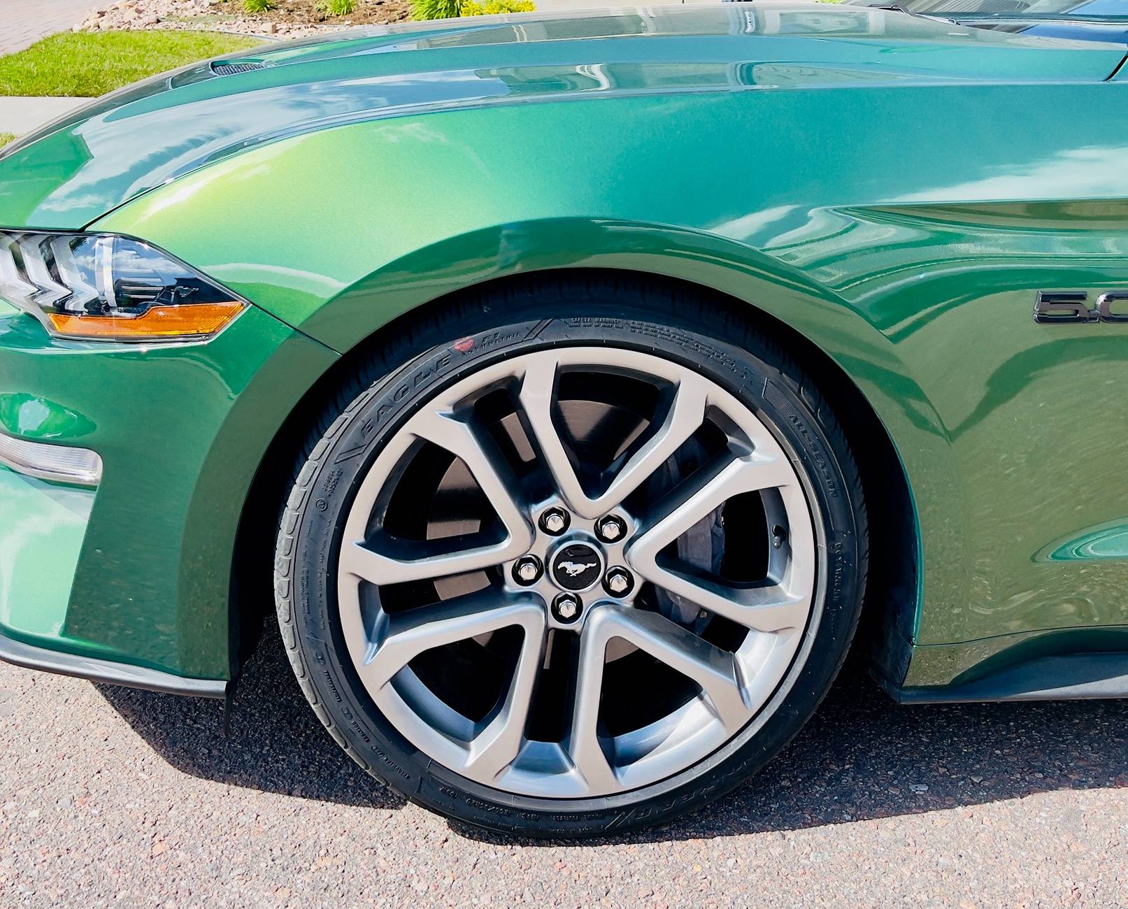

Now that I've had a week to get some miles in on the new suspension upgrade, I thought I'd give my thoughts. My goal for the car is pure street handling. I doubt I will hit a track or go to the drag strip. I just want something confident in turns in the mountains and the occasional full throttle blast from a stop light. I think I'm heading the right direction.
Installation was pretty straightforward. I watched Steeda and CJPony Parts videos beforehand. I could NOT get the rear cradle to drop low enough to wiggle the rear springs out like shown in the videos. I had to have a friend help me pry them out using pry bars and good old fashioned ugga duggas. Other than that, everything was pretty simple and went as was shown in the videos.
Ride quality is dramatically better. The crashiness from the stock shocks/struts is gone. It's smooth and just absorbs impacts now. The new springs are just a tad stiffer than stock and I feel they paired extremely well with the Pro-Actions. I wanted better handling without sacrificing ride comfort. I got that. Turning is noticeably flatter and the squishiness from the rear end is gone. The car feels confident now in a turn. I have done a few full throttle pulls and the car just hooks and goes. The vague 'what is it doing, I hope there's no crowd nearby' feeling from the rear end is gone. It's planted and I can feel it. I have not noticed any increase in NVH.
All in all, I am extremely pleased with the upgrades. This is exactly what I was looking for. I'm planning on adding sway bars, toe rods, BMR 4-point subframe brace and k-member brace in a few months. I think that will do it for the suspension at that point.
