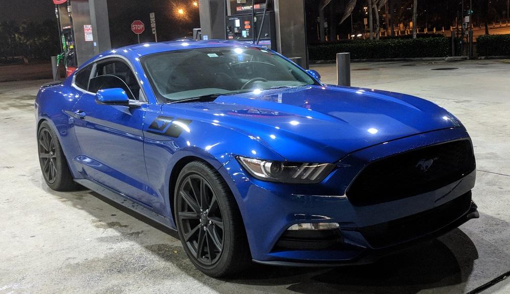

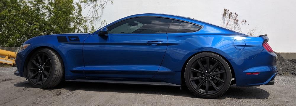

I've got Sport Linears instead and prefer the ride of these although the front could be a bit lower. Here are two pics of my car from the past week, one has the wheel turned so you can't get a perfect idea of the front.

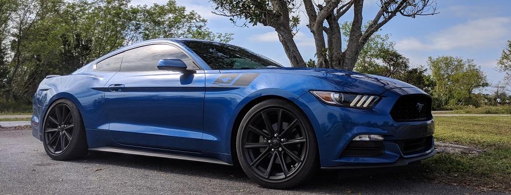

I think this shot is a pretty clear one to see how the Sportlines looked, I have a box with two subs in the trunk so it might be lower than yours, but good as a comparison to the Steeda Sport Linear springs on the same car.
