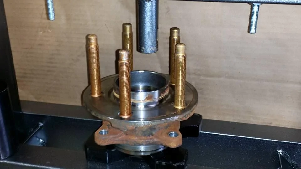

Yes they are, they are ARP, Rehagen Racing sales them RR-1107-S550F & RR-1107-S550R. Somewhere I have thread on here when I did the work.
Thanks! I've got a set of Welds on the way and I was looking for something like that.

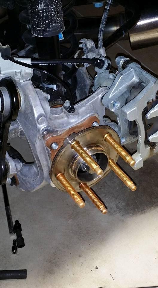

It Was easier to remove the hubs and press them in and out, but many people do it different ways. I will post pics when I get home tonight.

On old Chevy's I've always just knocked the studs out with a baby sledge and then pulled them back in just cinching up a lug nut.
Appreciate pics!

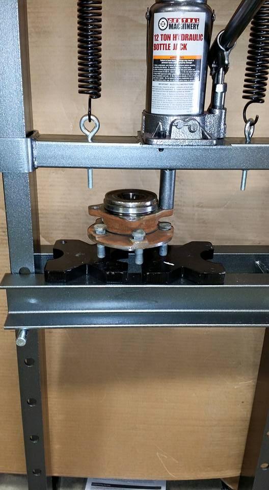

I mean, I have a press...so if I need to be gentler.
I'm probably over cautious, if I were to do the draw through with a nut, I'd use Never Seize on the threads and the face of the nut, to ease the stress on the threads.

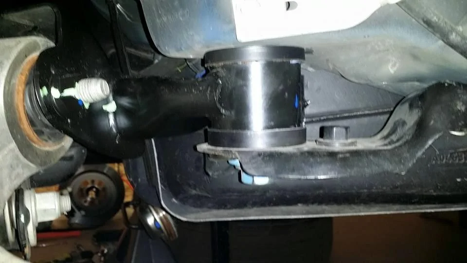

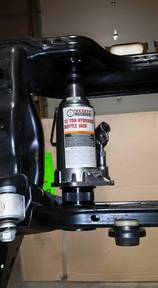

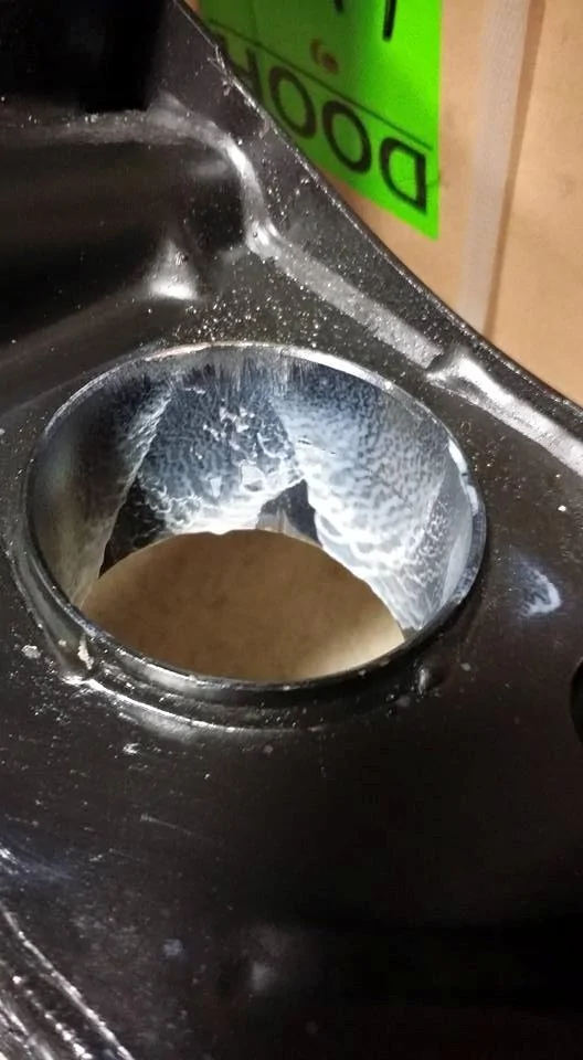

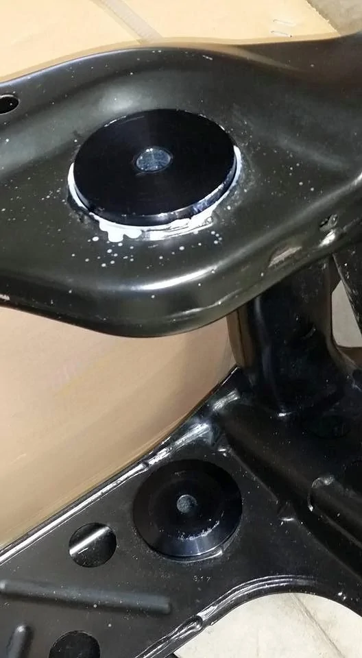

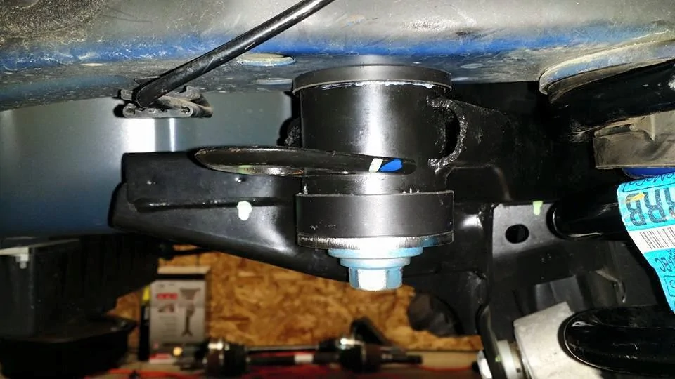

Press bushings in not hammer in

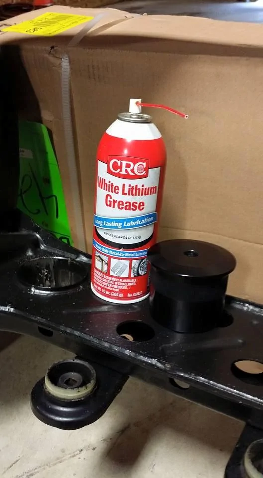

I used a simple bottle jack to press the bushings in, this way they don't get all beat up with a hammer plus I'm at the age if I can use leverage I am. Now keep in mind a bottle jack can produce a lot of pressure....watch it go in and when it's in stop! Now on the Derlin bushings pay close attention to their placement as there are different sizes for specific locations.

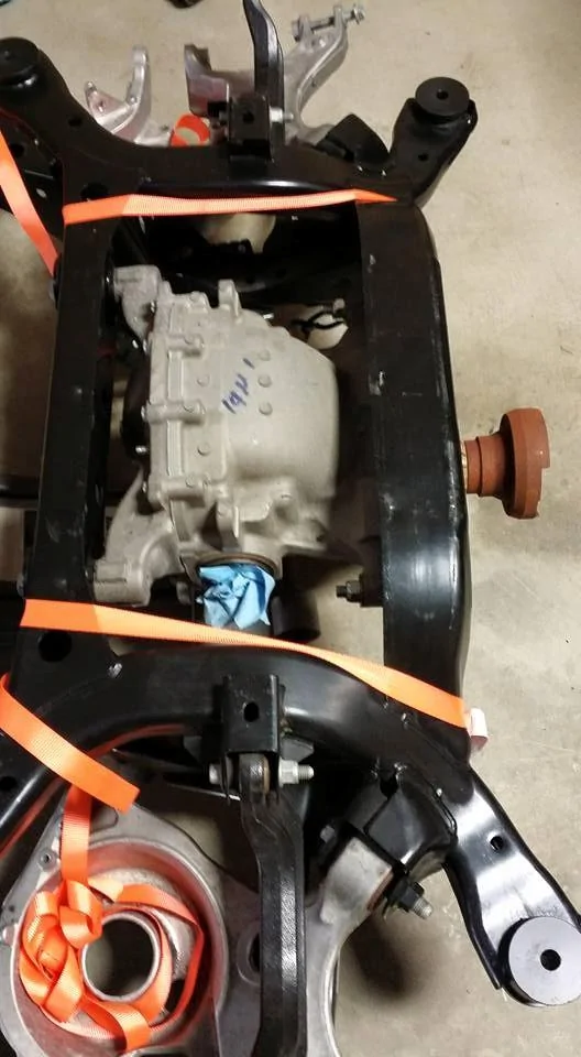

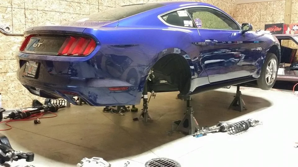

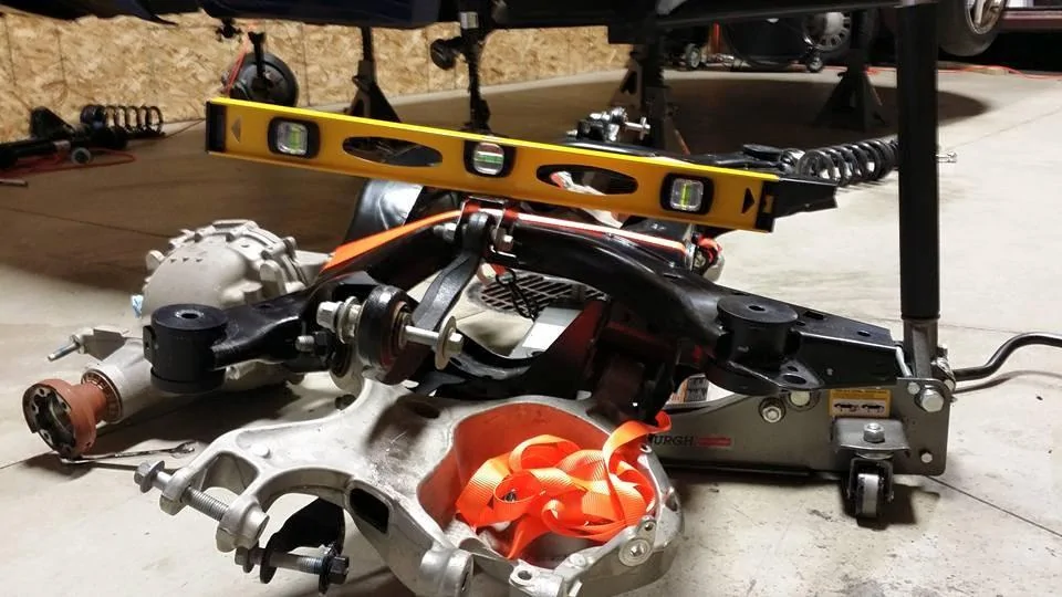

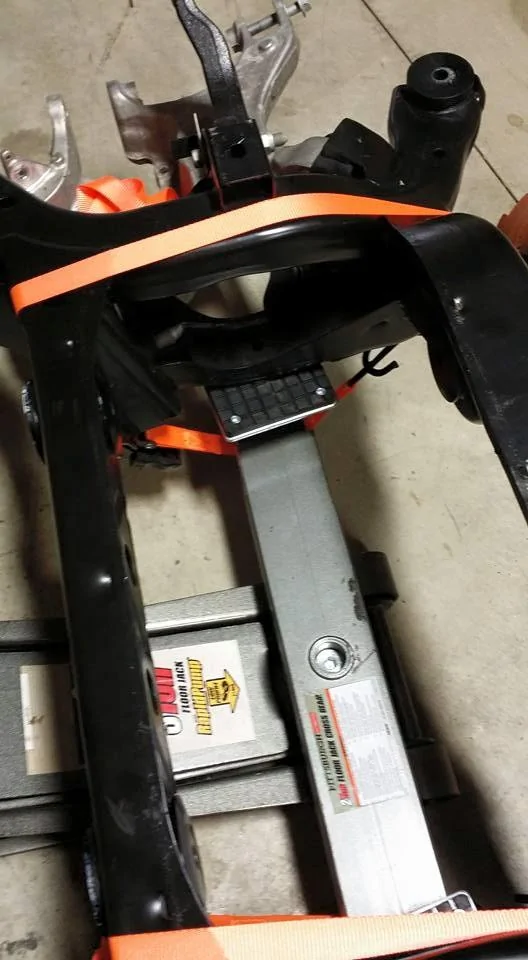

Jack and car angle
Depending on your jack setup....during lowering the cradle down it seemed to be heavy in the rear, when actually the cradle doesn't sit level on the jack, so I had to raise the front of the car higher than the rear (I have the stands 2 notches higher in the front than the rear, more might be even better), this way the car was on a similar angle as the cradle on the jack. I was doing a dry run without the diff to make it easier to handle.

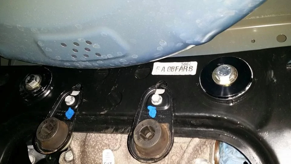

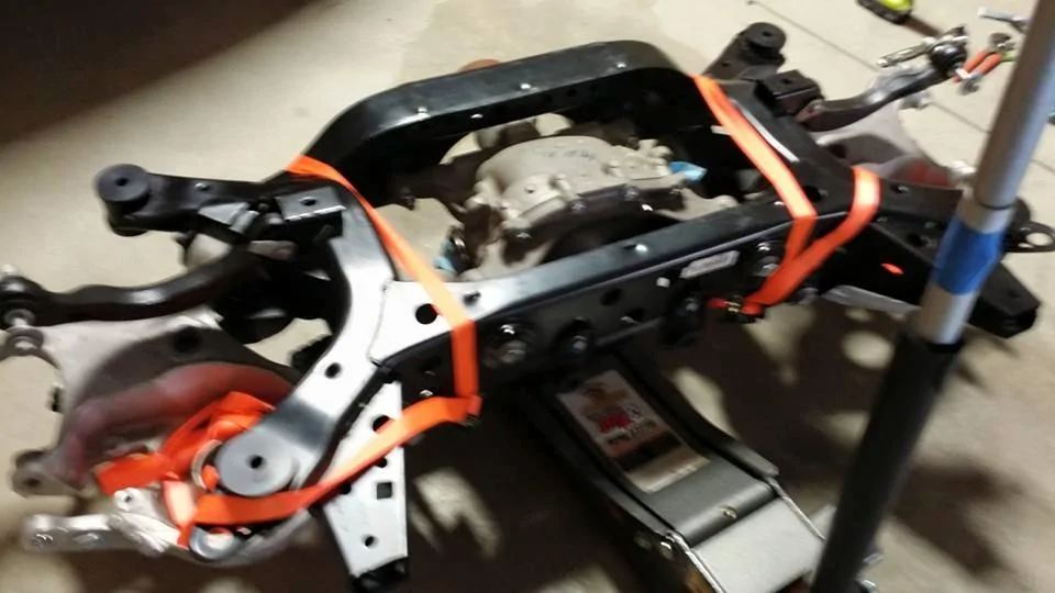

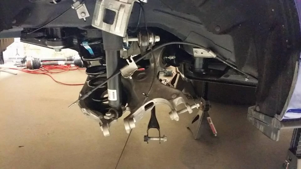

Cradle Install

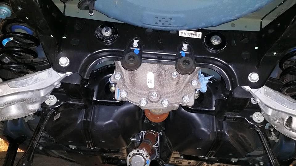

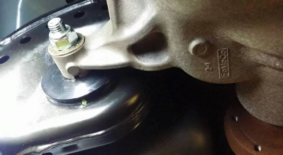

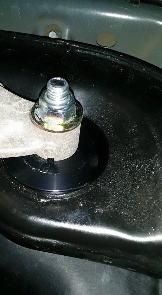

Good Lord! The hardest part of this whole job is the springs! I tried raising the cradle with the springs, but because the springs are at the rear of the cradle that keeps the rear of the cradle from seating against the car, the springs are stiff enough that the car starts lifting off of the jack stands. So I took the springs out, no problem at all seating the cradle then. But now you need to get the springs in, I had to lower the cradle a good inch to do this. Now remember I'm 48 and doing this by myself. So on both sides put the top of the spring in first, after that each side requires a different method due to coil direction. Passenger side pry down on the control arm till it bottoms out then I was able to get the very end of the spring to catch the a control arm by the sway bar link mount, after that some prying with a long pry bar through the spring and through the hole in the control arm where the spring seats and a dead blow hammer and got it in.
Drivers side I pried down on the control arm then spun the spring like a bolt(I think counter clockwise) around the sway bar link mount, then some more prying through the spring and control arm and got it in.

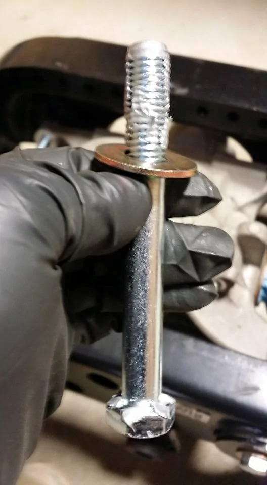

Extra hands will definitely be a big help. Be careful, you'll see I strapped my cradle to the jack. And torquing on your back is no picnic. I use Never Seize as I know I will be taking things apart now and again, this helps to keep the threads healthy. With any kind of thread lube your torque values lower due to the less resistance, so if you choose this route do some homework on this, as different lubes have different resistance values. The pic with the bolt has TOO much under the head to give you an example. And if you get it on your clothes DO NOT wash them in the washing machine that your wife uses! It will get on her clothes load after load!
