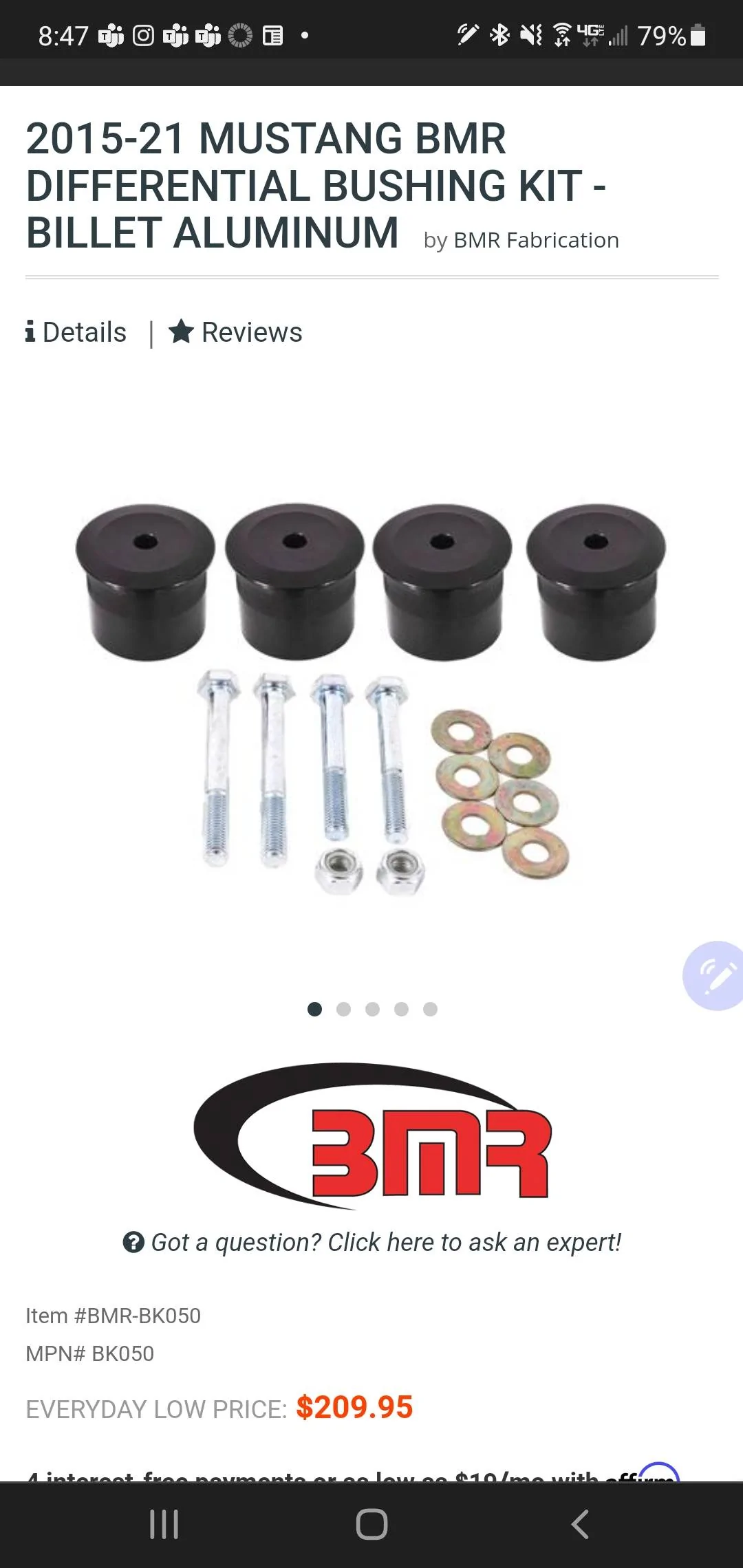

How bad is the NVH? Does anyone have these installed ? Have you broken a diff bolt with them?

sounds like a in the trunk, of course I had the cradle bushings as well and did them at the same time (also took all of them back out at the same time) so not entirely sure if it was them or a combo of them.

Lol damn.. it was that bad

Yep, radio had be turned way up. I was semi Ok with it, drove my wife crazy. So far the gforce have held up and no notice whine. My car does rattle and pop from all the other crap (on bumps and things); that is tolerable, the whine not so much. Hopefully nothing breaks. I was considering the steeda brace as i could take that on/off for the track. I'll probably do it when I get a built motor in. Best so far is a 1.4 60 and 6.1 /8th. It has a bit more in it, hopefully that isn't enough to break anything.

Are you referring to the Steeda differential support bracket? If so, fyi, I have one on my car and it’s not harsh at all. I drove from Kansas to Florida with it and the ride was nice and smooth.

Correct, saw a video too and didn't notice the rear-end whine that I had prior. My concern is the tabs breaking. The gforce bushings have a little give, but not much (and no voids), also the big Bertha bolts going through rather than threading in I think should be ok; but a broken diff tab could lead to many other broken items if it occurs on a launch. I've been looking at the steeda support but don't really want to drop the cradle again.

Which g force diff bushings do you have? I didn't know they made diff bushings. I've broken the BMR/lethal big diff bolt bots twice smh. What are the big Bertha bolts?. I'm not overly concerned about the NVH I know it comes with the mod process but I don't wanna feel like I'm riding in a nascar lol

I like that you can take it off if it was too loud vs the aluminum solid bushings are here to stay. Do you track your car alot? What's your setup?

If NVH is a concern, don't touch the diff bushings.
false. use White-line replacement bushings. The diff growl is not at all obnoxious and you can have a conversation at normal volume just fine.

Dude, I have the whiteline bushings. Everyone has different thresholds for acceptable NVH, and a surefire way to increase it is to mess with the diff bushings in any form.

sure, but the NVH is downright minor. Unlike the Steeda/BMR 'puck' systems which sing something crazy.

I put in the Steeda soft inserts (don't remember the color) and had no NVH issues. And I'm an NVH freak. I'd have preferred the whiteline bushings but they weren't available. I think the issue is the combination of mods. I took out a Steeda stop the hop and replaced it with Whiteline subframe mounts.
