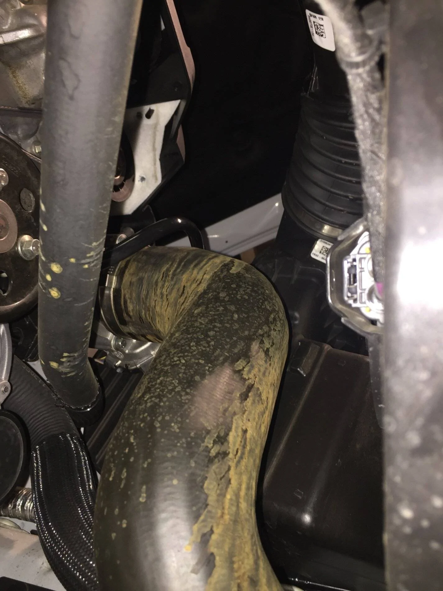

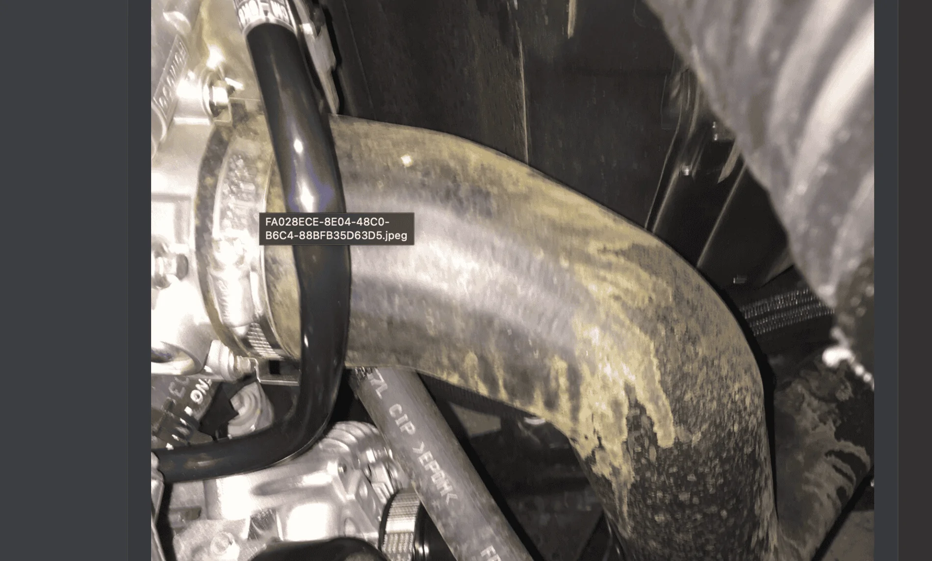

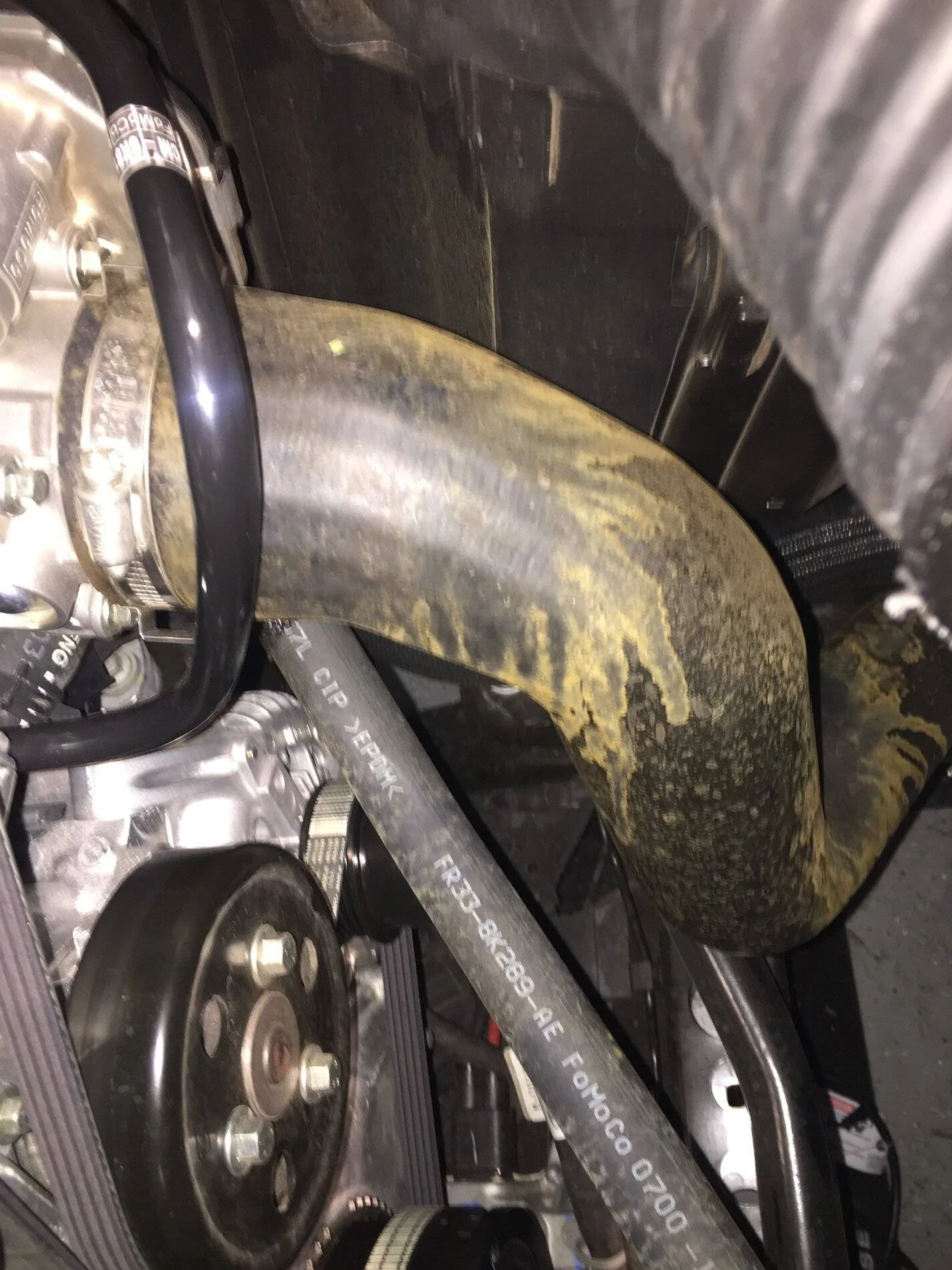

Ease off on the throttle there hoss, there is a lot you haven't taken into consideration. He just came here for help and there's no need to go all playground on him.I bet they’ll find the leak under cover
- It's not coming from the intake tubing, that much is for sure.
- I doubt it's coolant as these run the ethylene glycol orange coolant. Also, when it's coolant that shit goes everywhere.
- I also doubt it's coming from under the engine cover as that would cover the front engine cover, pulleys, etc and leave residual where you could see it from above.
- It is that Arizona tan color and it is located right underneath the hood vent on a 2018+ car. OP, did it happen to rain a lot in the recent past? The pattern seems to wrap around on both hoses that you can see it on and drip off the bottom indicating it came from above and wasn't blown around by fans or belts. And being in AZ I could see a lot of dust buildup in the vent getting washed down by one of your famous sudden rain storms.
