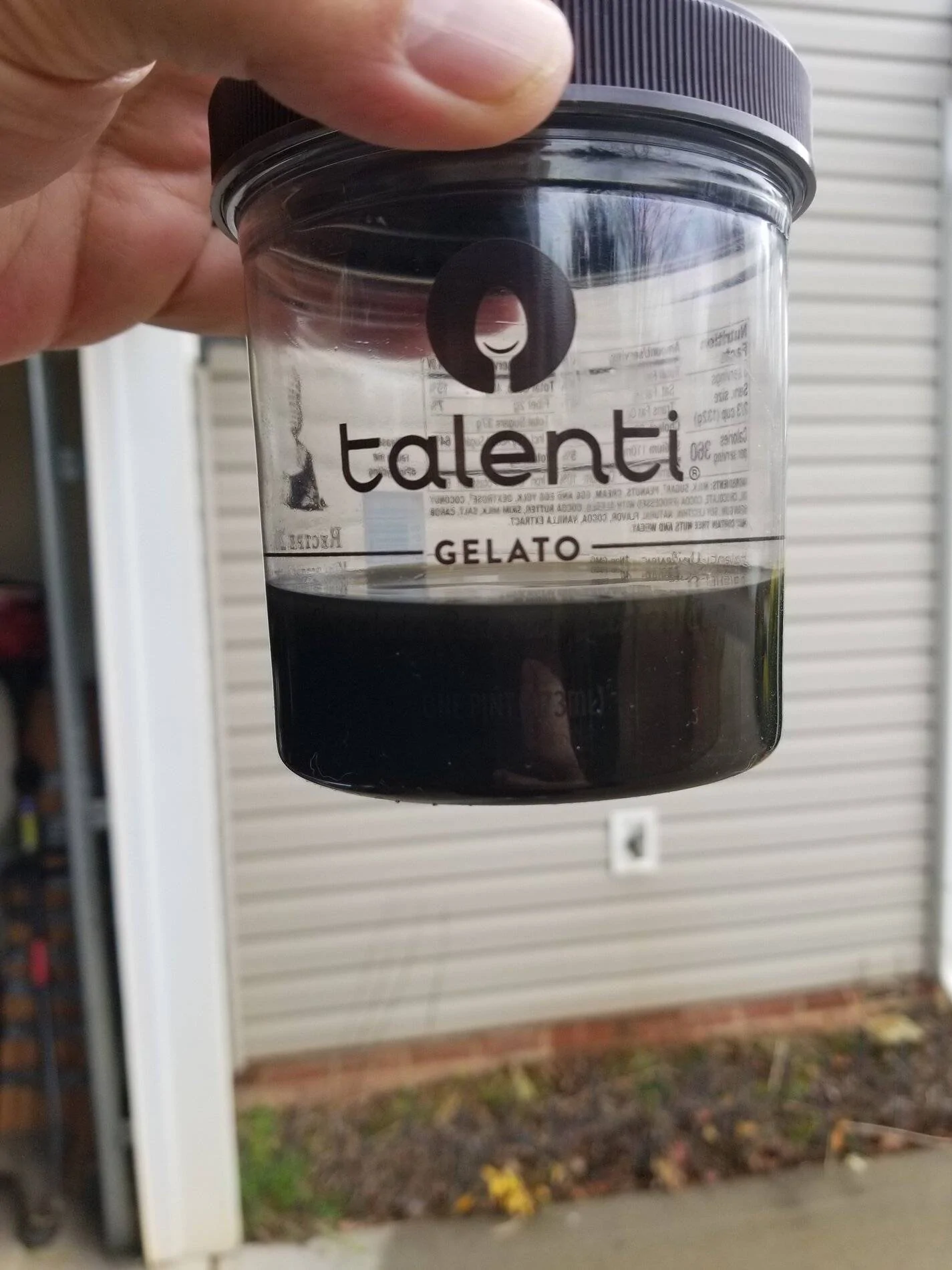

The amount will obviously depend many factors. I ran a simple test on my EB and kept all the oil sludge from my JLT oil separator for a few thousand miles and it came out to over 3 ounces. I ran with a tune for 600 miles and without a rune for 600 miles (round trip) and noticed the amount of sludge reduced by about half. I then installed a valve cover breather and noticed a reduction in the amount of sludge being collected.
Here are my results for the EB for about 2k miles with a JLT oil separator. My car was bone stock for 5 years and 40k miles before installing the ECU flash and oil separator.

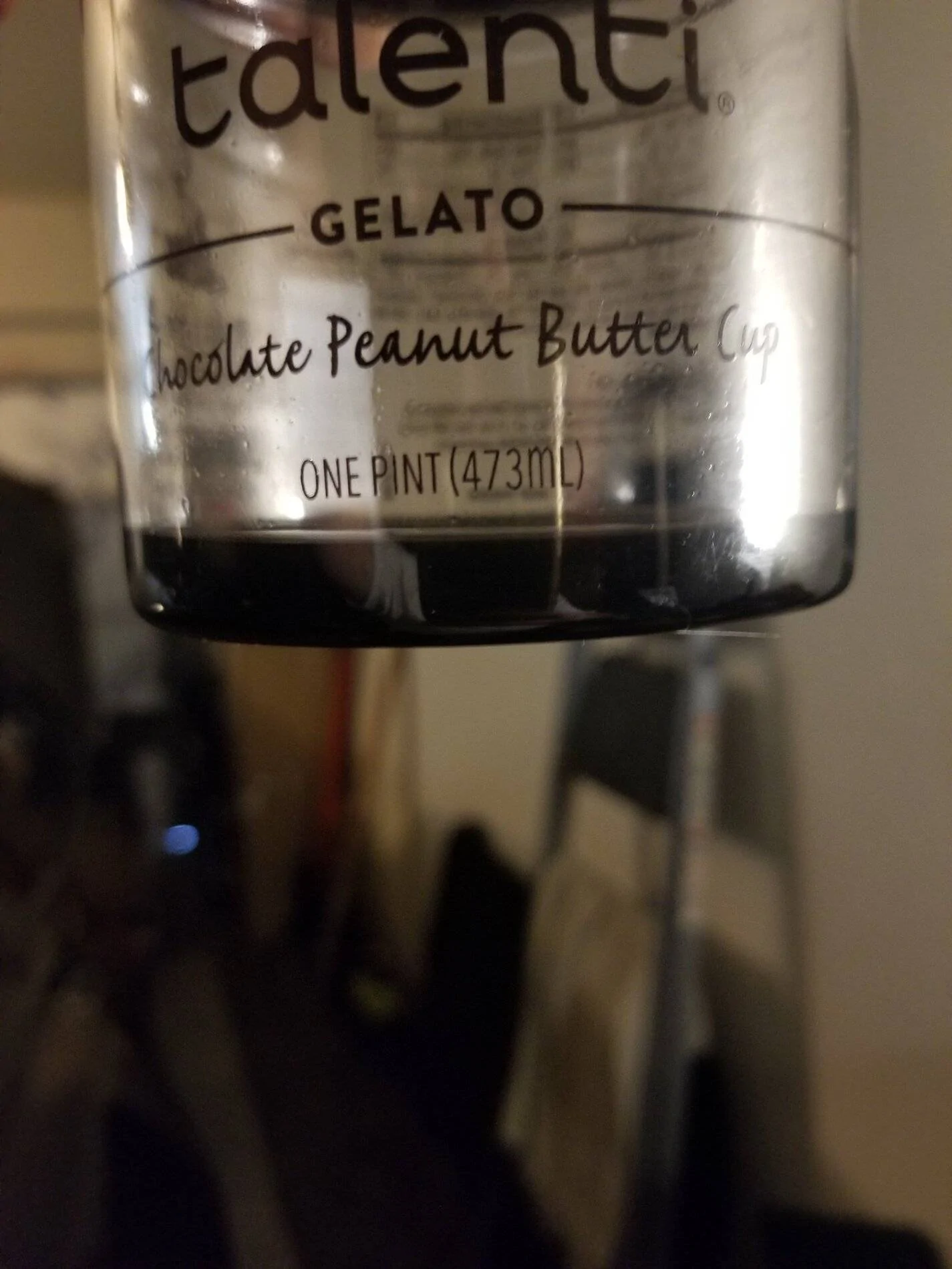

Florida road trip ECU flashed:

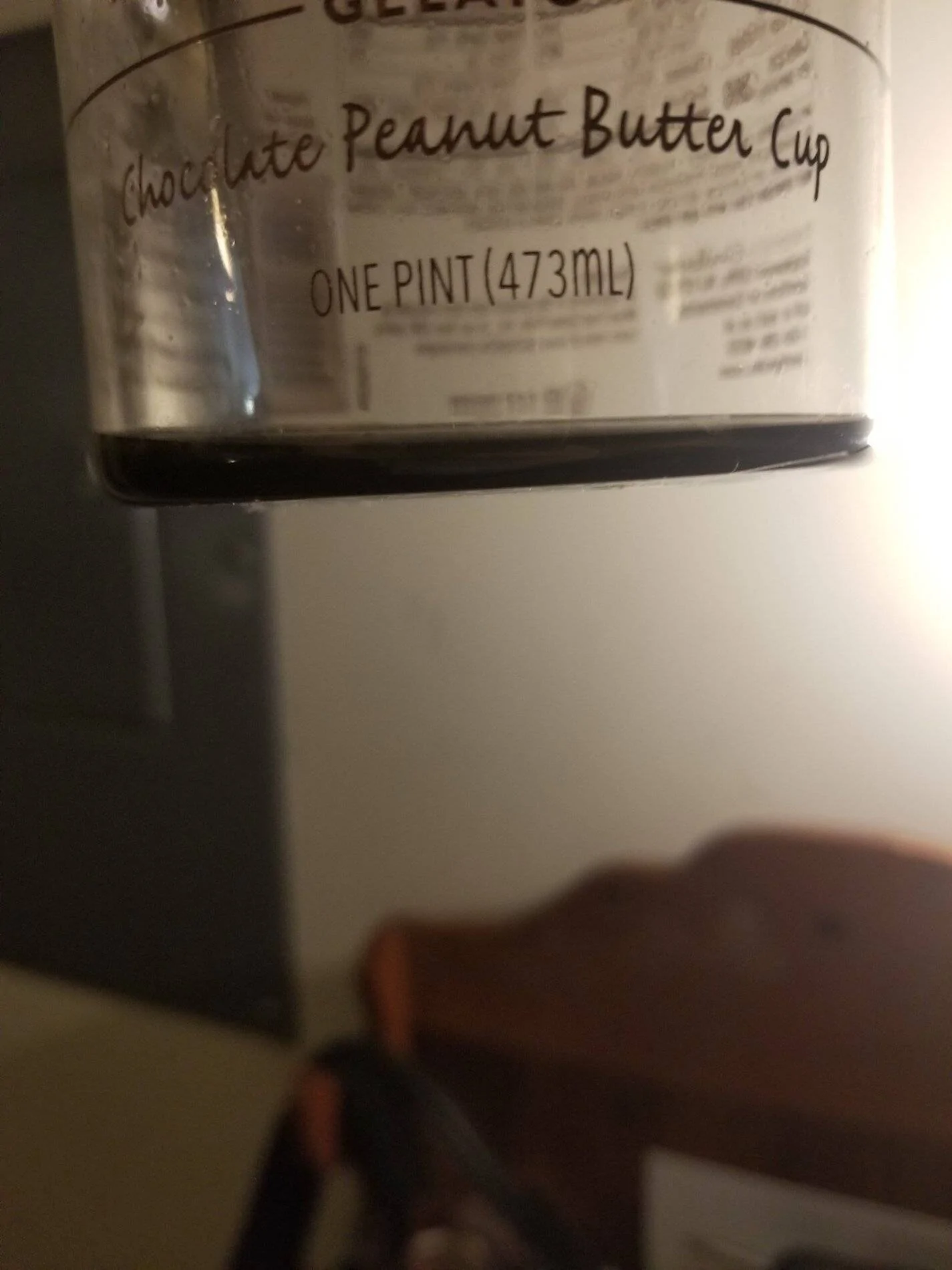

Florida rood return trip with the OEM ECU.
