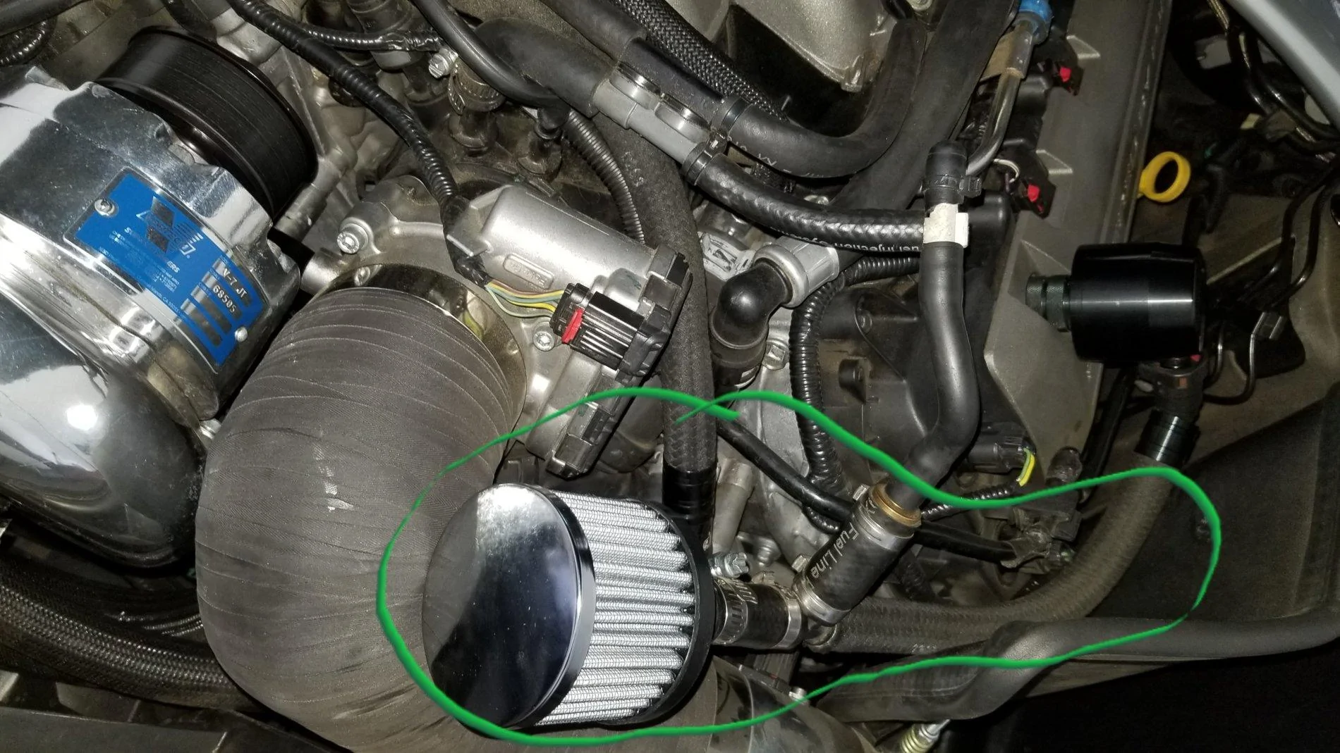

I have a vortech V7JT blower .I just did like probably 4 hard pulls on the highway racing a friend of mine. I took the jlt cold air pipe off and put my turbo guard on. First time I ever did it. I also have the upr catch on the passenger side and the clean feed on the driverside. I spoke to Steve at UPR and he sold me a filter that connects from my clean side (driverside) to the end of the line that plugs into my JLT cold air pipe. I noticed alot of oil all over the engine bay coming from the filter. Car still runs good no check engine light ,no smoke, no knock. Is it normal for the driver side to shoot out oil like that? I thought only the passenger side shoots out alot of oil. I hope this make sense. Here's a pic of what I'm talking about

Looks like you have the filter on the “wet” side of the connections. It’s hard to tell with
the picture since I can’t see all the connections.
The catch can needs a vent to allow only combustion blow by gasses to escape not oil vapors. Looks like the vent is on the crankcase side of the vent lines which will have oil vapors in them. Especially under high loads. Also check to make sure your check valve or PCV to the intake manifold works so you aren’t inadvertently pressuring the crank case with boost.
Study the pluming based upon light load and high load conditions and you will figure it out.
Is the wet side the driverside? That's the side it's on

Any air that leaves the valve covers can have oil it regardless of the passenger or drivers side of the engine. Some catch cans are made for the pcv system. Meaning the intake manifold vacuum draws in the crankcase air through a catch can then the PCV valve in the passenger side cover.
But what happens to your car when it’s in boost? If the catch can is not vented to the atmosphere, then it hopefully does nothing. If does allow boost to flow passed it then you are blowing back into the engine which is bad.
So now the only place the crank case gasses can escape is the drivers side Valve cover when you are in boost. I’m not sure if the clean feed and the baffles in the cover the drivers can separate the oil effectively.
Most high hp applications need at least two large vents for crankcase blow by.
On my 2018 roush it vents under boost on both the passenger and driver’s side valve covers. Under vacuum it draws filtered air from drivers side through the engine into the top of the blower from the passenger side through a PCV valve in the pax side cover.
I built catch cans for high hp small displacement engines. With the high cylinder pressures they had a lot of blow by.
I would weld extra vents on the valve covers. The better you can evacuate blow by the less windage you will have in the crankcase.

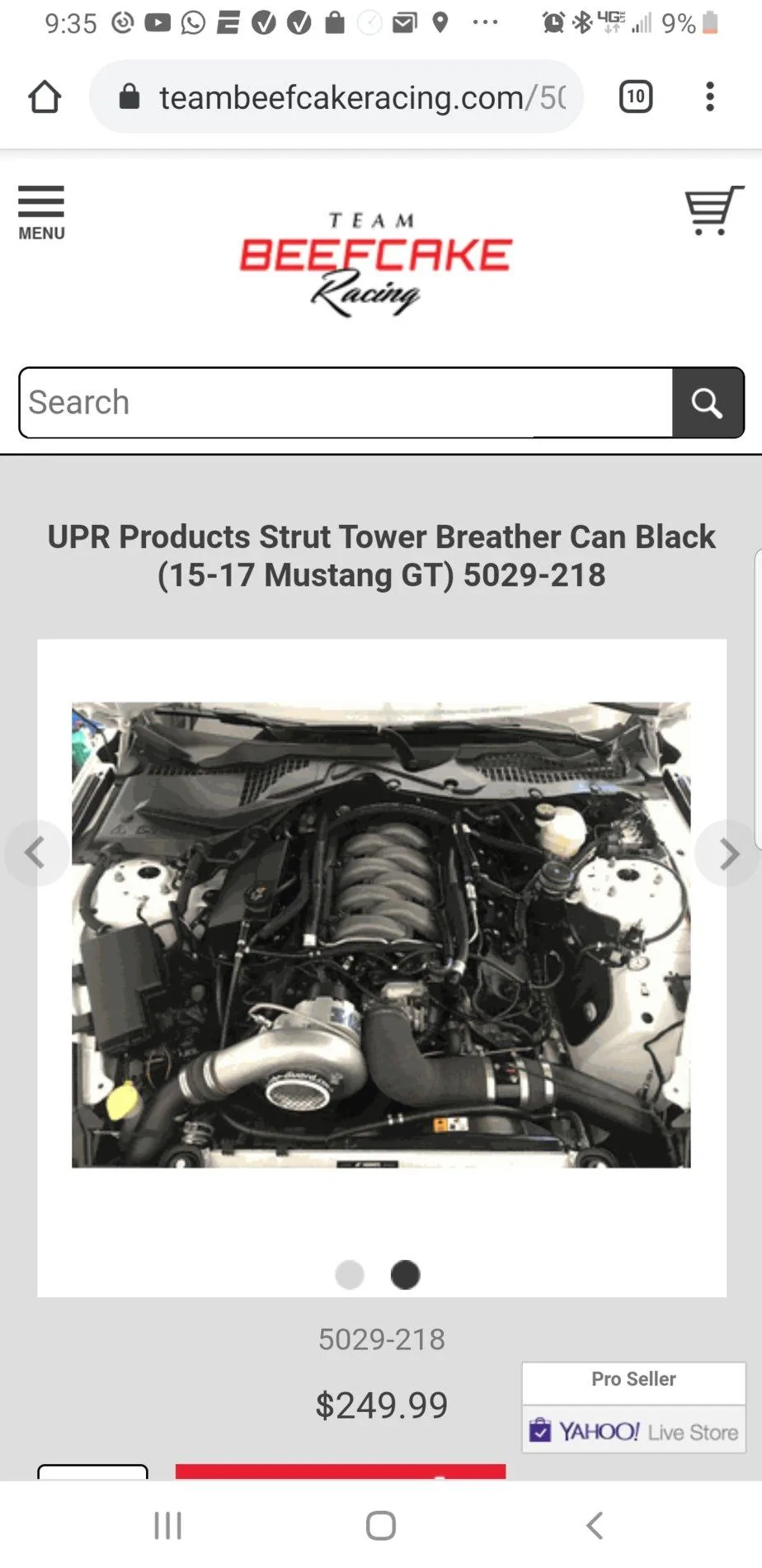

Is this a good one? Is this what I need? It has the breather on it as well
