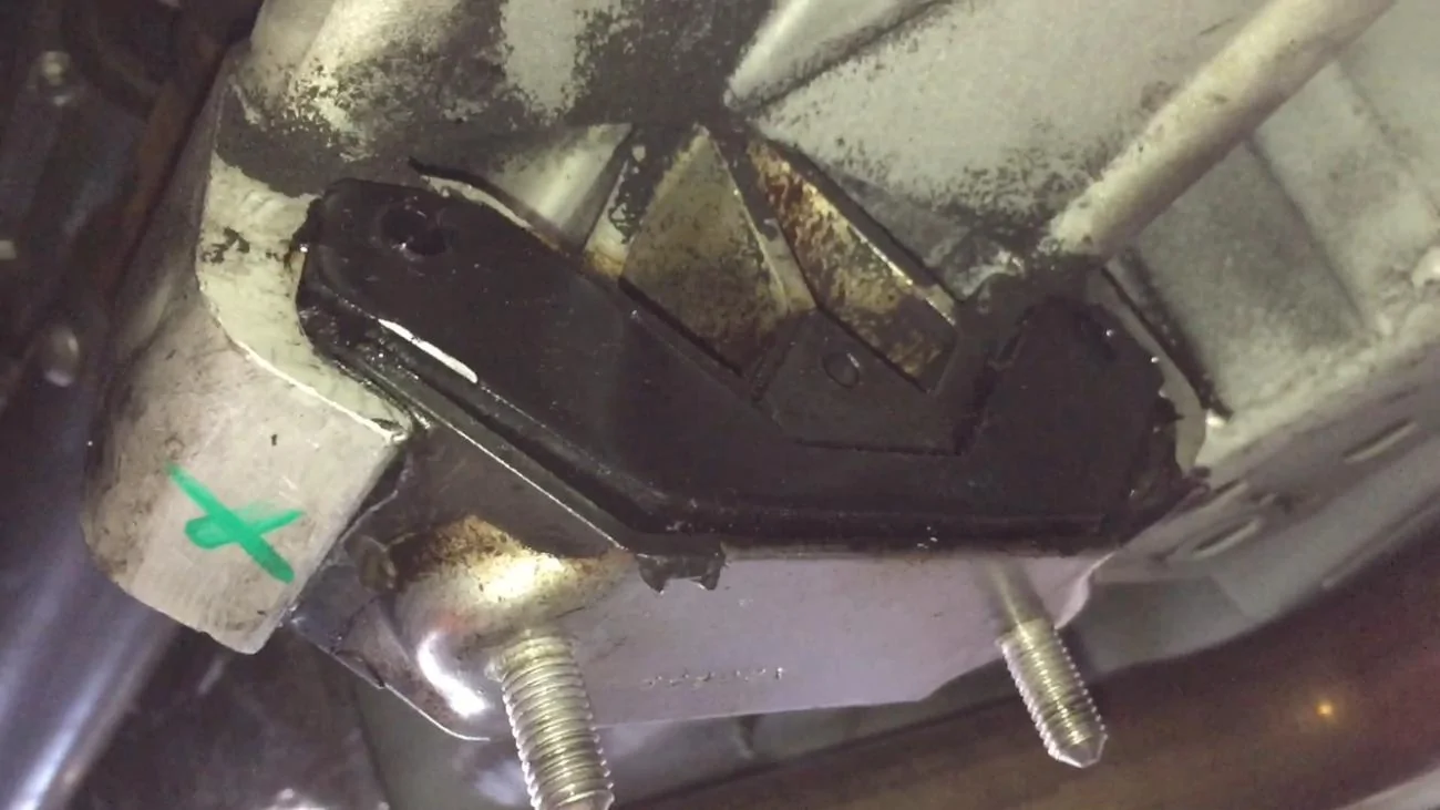

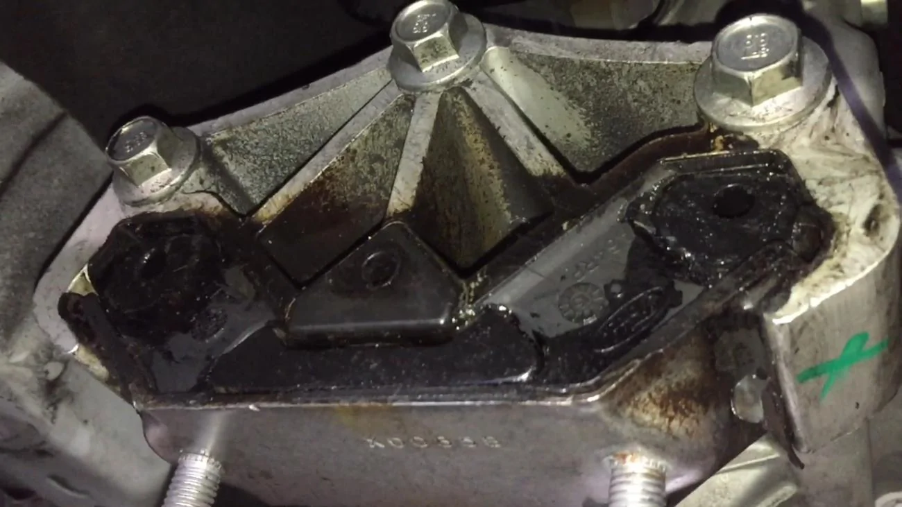

More parts more parts!!!
Steeda transmission bushing insert...
no real evaluation on this part solo.. but i did get an increase in some vibration and I'm gonna pull it to see if its this or all the parts I've put on. I can live with a little vibration since the car feels solid now when shifting.
Install straight forward and easy, about ten minutes of your time

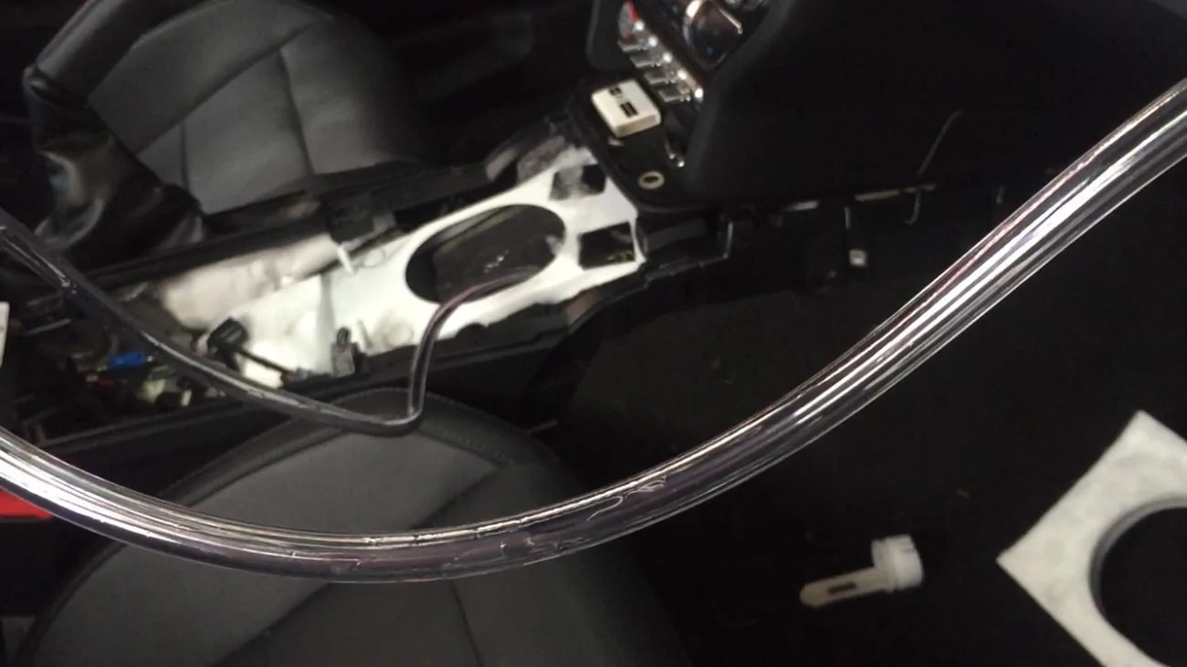

transmission fluid swap!!
heard it does wonders... it does... tranny noise is mostly gone!!
easy to do since i was already planning to rip the shifter out!
