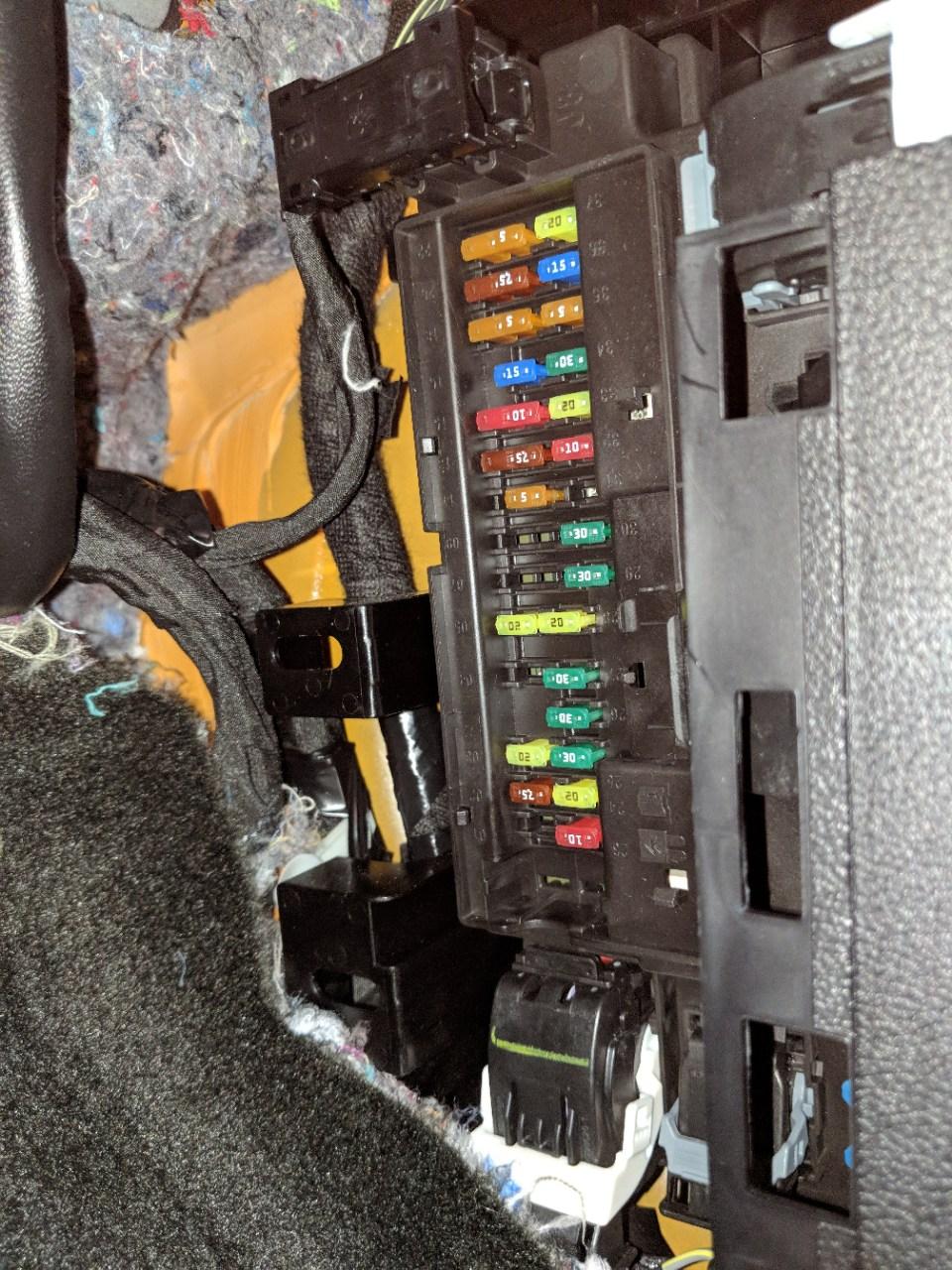

Here's a pic of my passenger fuse box

Figured it out. Turns out that in the 2018s the lights for the trunk, glove box and vanity mirrors must use a capacitor, as their power slowly drains and will only power back on once accessory power is restored. What made this hard to figure out is that this DOES NOT APPLY to the map lights as they are on a separate circuit.
I guess that's a good idea, just wish there was documentation of it. Oh well, hope this helps other 2018+ owners when they are replacing their interior lighting.
