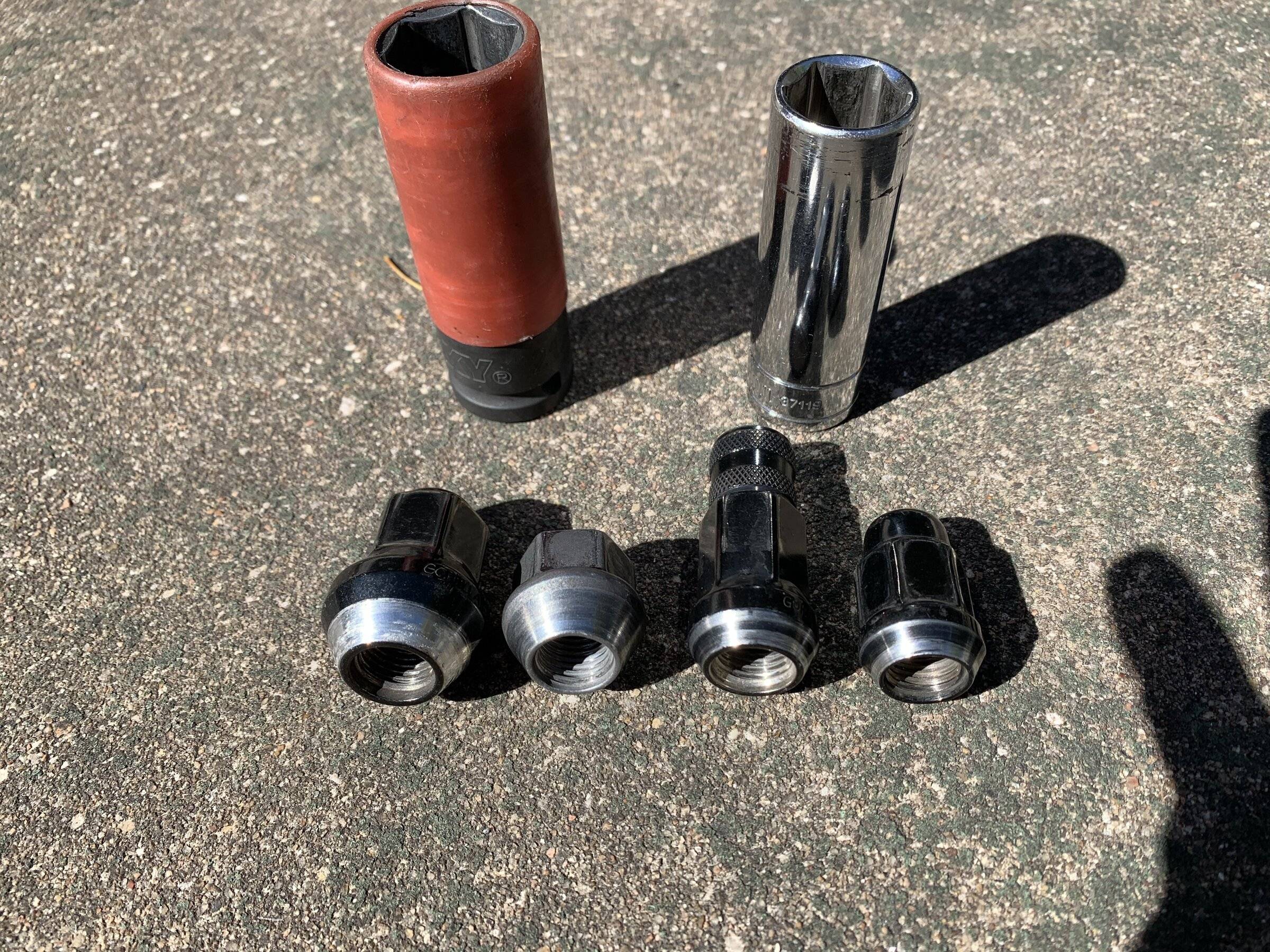

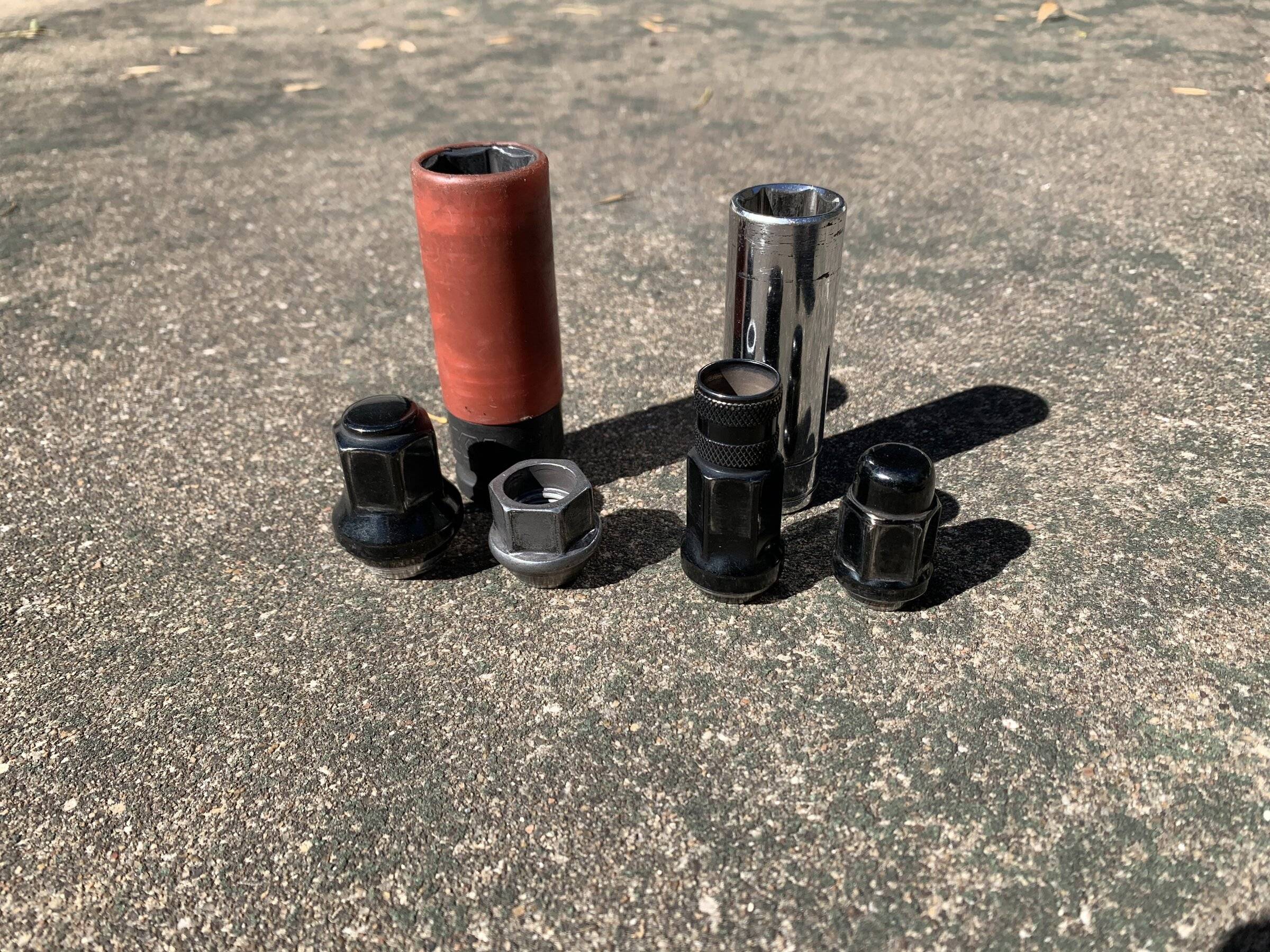

Only reason to use 19mm is if you can’t fit 21mm.
FWIW the contact area isn’t as different as it sounds. The seat on the 21mm may be bigger than the mating surface on the wheel. Check the wear on these 21 and 19mm lugs

Yep, agree on wear surface contact patch between the two and also if not enough room for 21mm lugs in wheel pocket on aftermarket wheels which is why I prefer the 21mm lugs. I have 19" premium wheels so happy with wheel but think black lugs would complement the silver wheels on my car.
