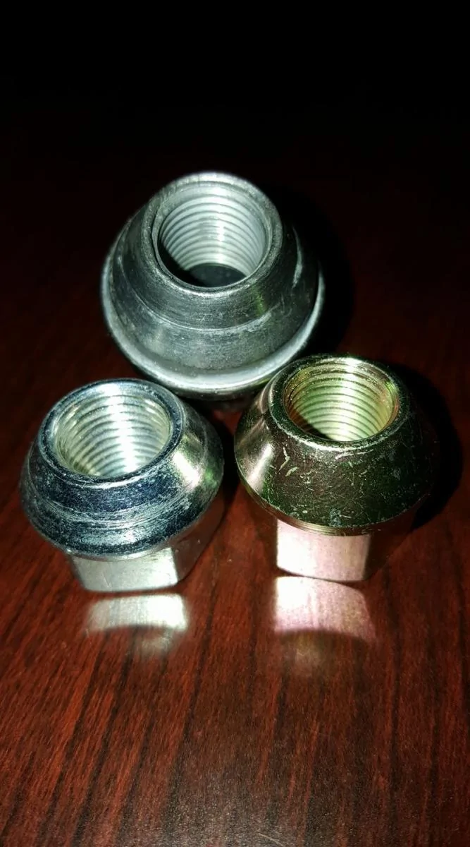

Acorn and Bulge both use the same seat (60 degree) You can run either on the OE Wheels. The smaller hex just allows the socket to fit in tighter recesses on some aftermarket wheels. You are good to use them.
The OEM at top, 14mm left and 1/2" right. The effective part of the seat is the same on all of them.
