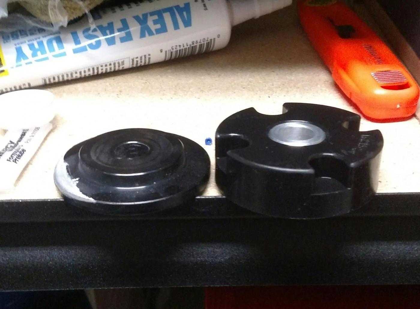

I bet yours is doing exactly what mine was doing ,it really did it at low speeds and only got worse the longer of a drive I would do. I switched it out for Steeda's rubber black diff kit. After seeing their design and its obvious BMR in this case was plain and simply beat , after driving on the rubber 90 durometer pieces from steeda i get 99% less noise from NVH , 0% metal on metal noise , and overall same performance, I was skeptic of how this would do, after seeing the pieces and testing it....STEEDA TO THE RESCUE, here is why we were getting that noise,
You can clearly see the BMR piece rubbing metal, only a little bit, but enough, the Steeda piece is solid, like a rock, after you insert the metal cylinder in the new rubber its a brick , my wheel hop is 99.9% gone still and now my GF thinks i took my car back down to stock, no NVH, no metal rubbing.

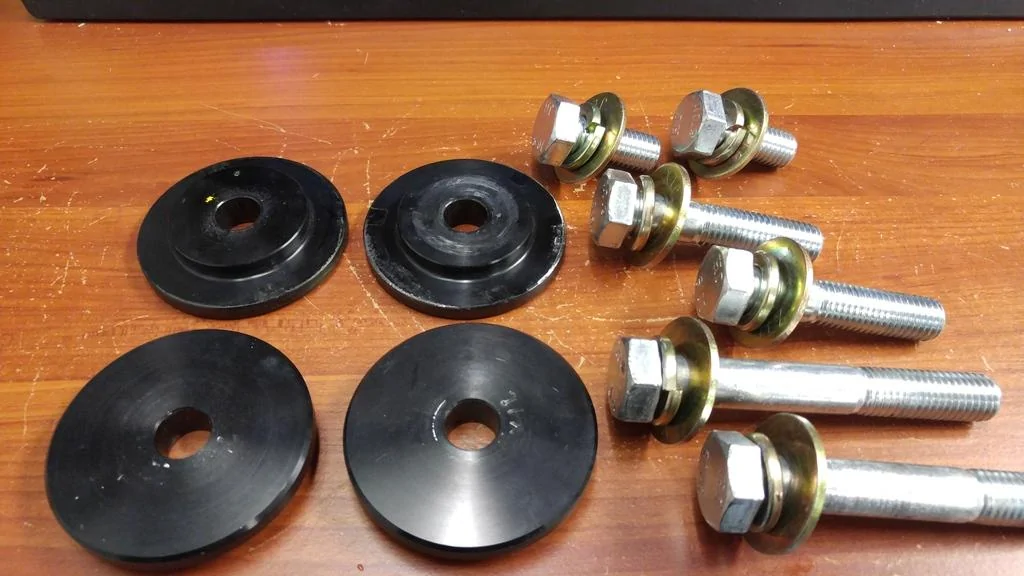

From BMR's own post http://www.mustang6g.com/forums/showthread.php?t=34814
You can see how their pieces also have metal on metal rubbing clearly in the picture, they have many great products , wish they could tell us when a mistake was made in their own design or at least a warning. BK054 performs well but is not good for $40,000 car.

In that case, yes, the Poly in your pic should be much thicker.
I would not call it a mistake - I would call it a trade off.
I am not sure how many times I can post why we chose the thinner pucks for this specific application, but here is just an example of why we choose specific designs.
All 3 are from different cars - the bolt that isn't broken is, well, you go it. The thin lockout design.
I DO have some other designs I am still testing, like I have mentioned several times on this forum.
If anyone is unhappy with their kit, then I will assist them in any way I can.
We have shipped over 400 of these kits out with about 3-4 issues thus far. ;)
Enjoy your new parts! That Poly should be much more comfortable than the aluminum.
:cheers:

In this case, you were better off with the Steeda pucks. They are not lockouts like the BMR pucks, but they will help stiffen up the diff mounts. And yes, any sort of research would have told you that there is increased NVH with the BMR diff lockouts.
