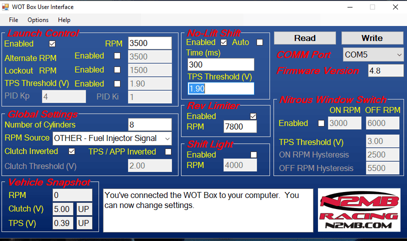

I’ll try and take a screen shot of my settings. It’s a 2018 idk if that makes a difference. I don’t know how to upload a video, and I haven’t added the clips to YouTube. But my IG has a rolling 2 step set at 3500 RPM, I’ll include a screen shot. To do rolling 2 step, just have to let the revs drop under 1100 I think and then clutch down then gas pedal down lol. There may be other ways but I haven’t messed with them. If you watch the IG video you’ll see I have no reason to play around with the settings as they work perfect for that.

i got your PM, im charging the laptop to grab a screen shot. Ill post to you my settings and i can post on here. I know there isnt a ton of info around.

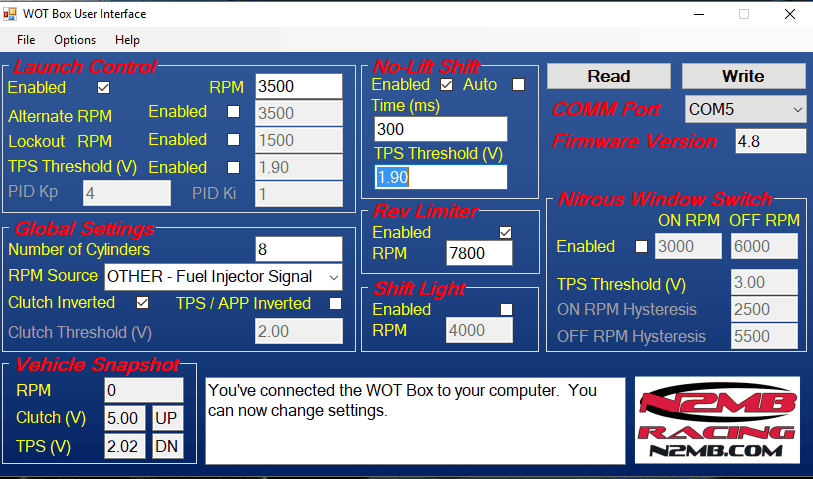

screen shots with throttle up and throttle down
