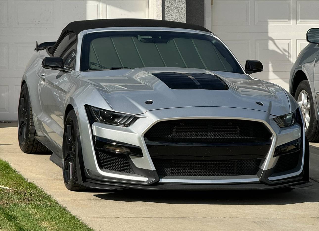

What Bumper/Fender/Hood manufacturer did you go with?
My friend who owns i5AutoHaus, dropped about $40K into the car so far, new body, interior, suspension, tires, and just refreshed a lot of the engine too.
