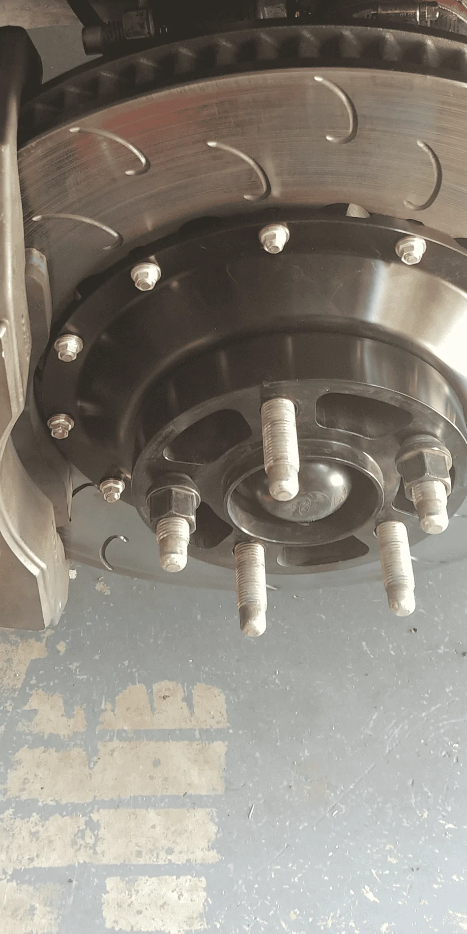

There are 2 type of spacers.
1. Wheel centric. The one with the bolts on it.
2. Hub centric. Slide on spacers. Required longer wheels studs (1" longer)
Adding 5 bolts you add weak points so i would suggest HUB CENTRIC.
The best spacers on the market are the OPMUSTANG.COM
Those are what the race community use.
I run 28mm spacers
Hope this help
So what should I buy? The spacers plus longer studs?
