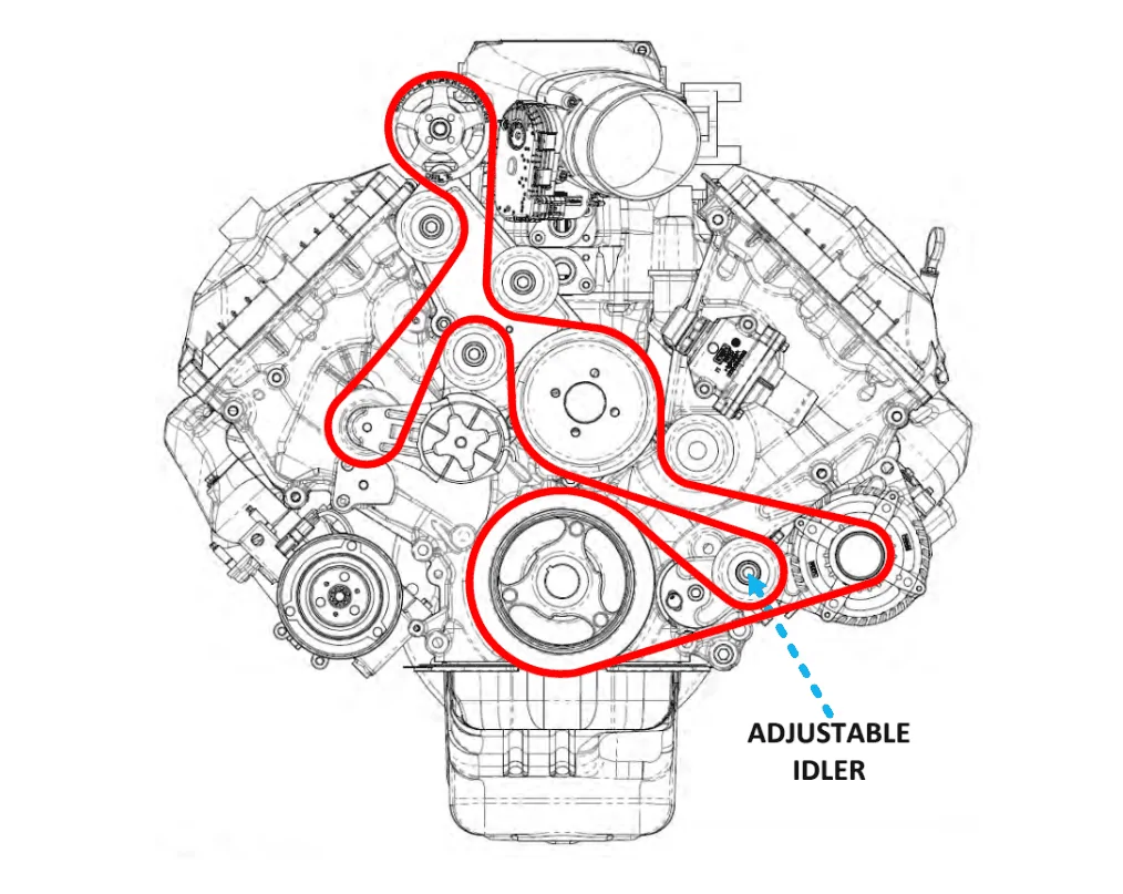

Can you tell me where your tensioner is located? Like 9 o’clock or 10 o’clock... and where is your slide bearing location?
Thanks
Ruiner46
Aug 12, 2016
492
291
Colorado
2016 CO GT PP
Thanks
Mine looks just like this routing diagram. Tensioner is around 9 oclock. The adjustable pulley is around 75% of its max position I think. It's wherever I set it the first time because I've never had to change it. My belt is Gates Micro-V K061066.
