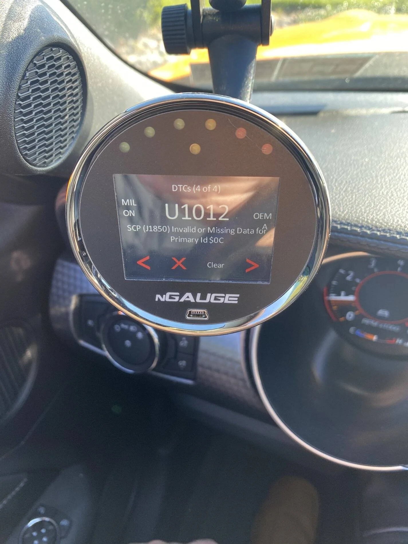

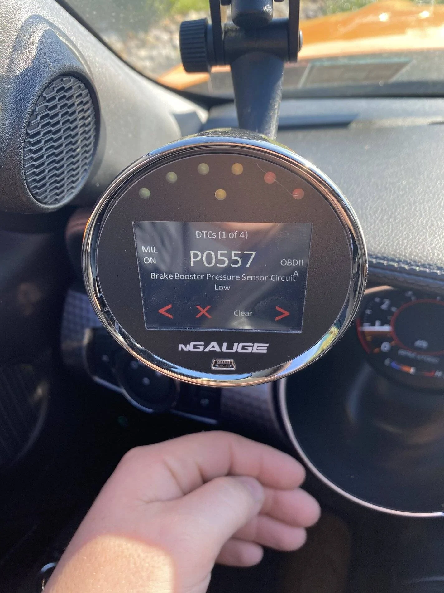

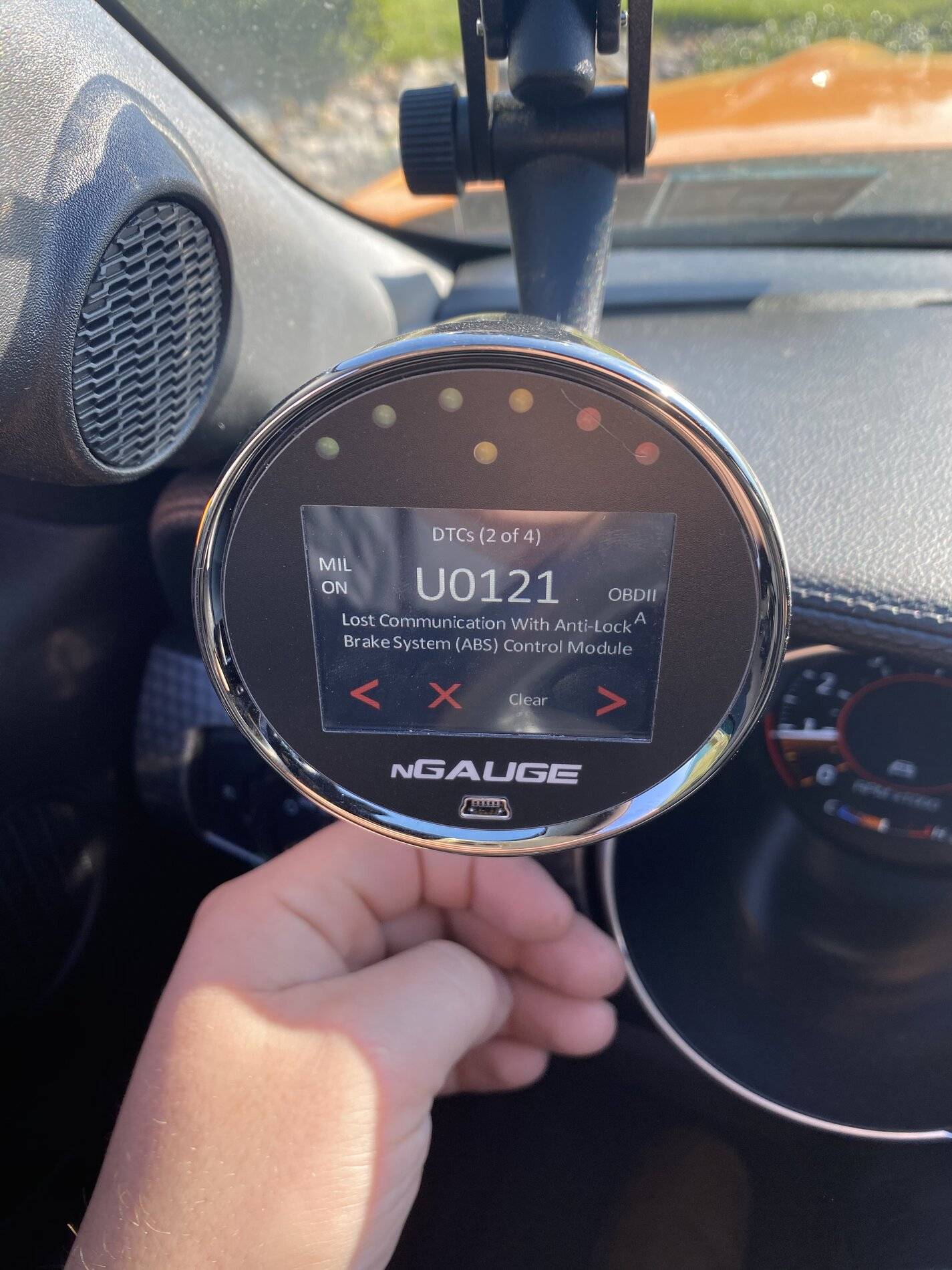

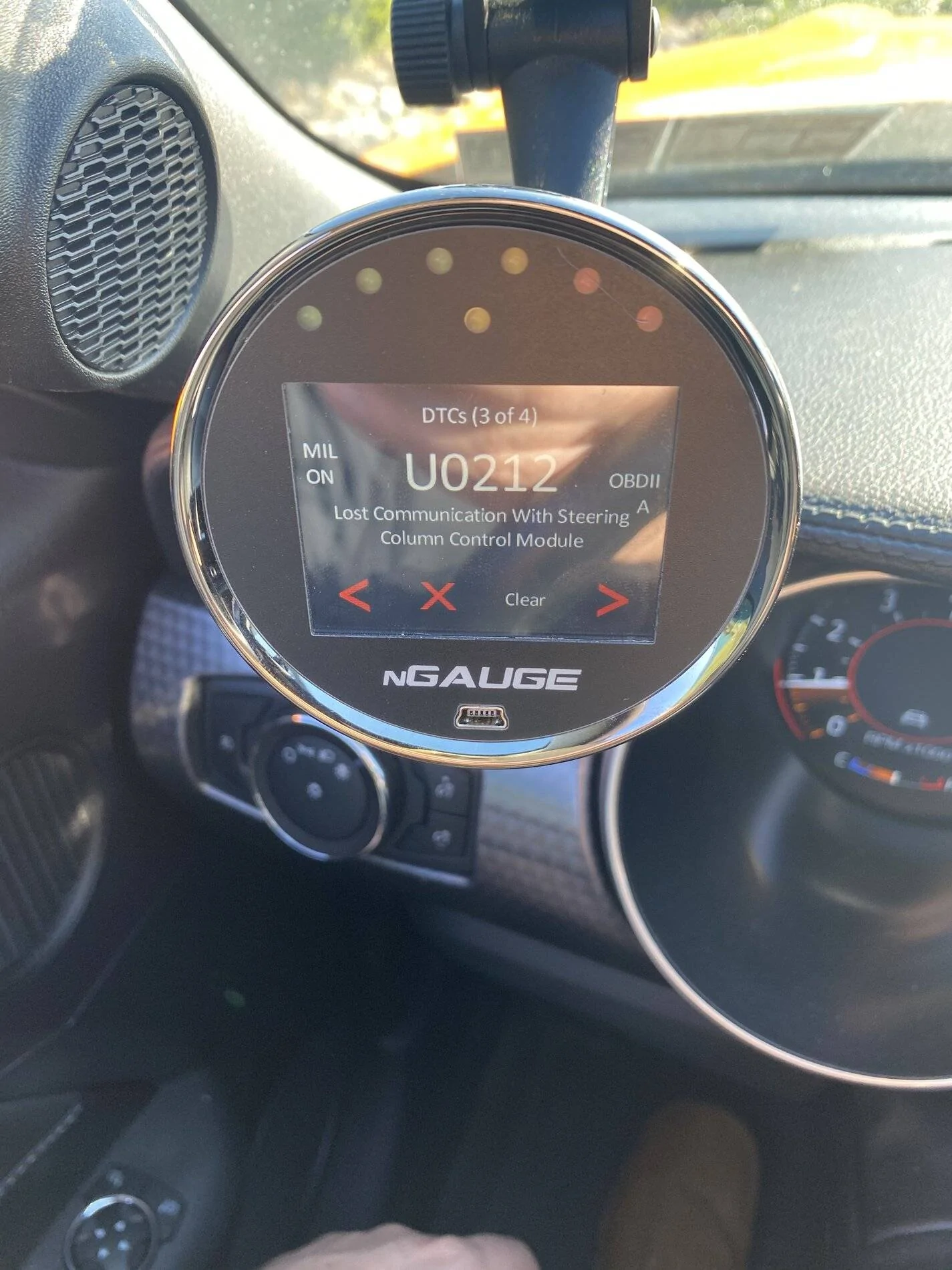

I need someone’s help. I have a 19 GT with a gen5 whipple. Car has been fine for months. It’s tuned by Lund. So 4 weeks ago I went to Ford and had my sync updated. Left the dealer and driving for a few miles all of a sudden the dash starts going crazy. Look at the codes on my ngauge and I have p0557, u0121, u0212, u1012. I turn the car off and everything goes away until I start driving for little. It’s even went off after driving then came back on. I know the dealer so they took it in and started chasing. Checked grounds. Even installed a new apim. The hard part with the car is that they can’t drive the car with IDS connected because of the tuner locking then out so only way to do it is to load stock tune on and read modules nothing with ignition on. Like I said we have been chasing this for 4 weeks and I’m lost at this point. Honestly thinking about putting car back to stock and telling for fix it or buy it back

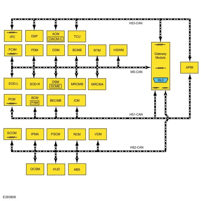

Here is the network topology of all of the modules on a 2019 Mustang. It's going to be very hard to help diagnose from here, but i'm trying to find a common link to the codes you are getting, what the programming did exactly, and how the network is aligned.

The U1012, U0121, have to do with ABS module communication. And the P0557 may have something to do with it as well. (the brake booster pressure sensor in line with the vacuum line from the booster to the manifold.) It's a shot in the dark, but make sure that connector is plugged in. It shouldn't be causing a communication issue, but it's something simple to check.
Also check the fuse for the ABS module. I'm not sure which one it is currently, as i do not have service data in front of me, but no power to that module will set these codes for sure.

I will definitely try to think about your problem some more. I am mostly concerned as to what is causing the no communication to the ABS module, and if it's also affecting the steering column control module.
Does anything else in the car not work? turn signals? hazards? wipers? horn? any little details like that help to try to pinpoint the problem.

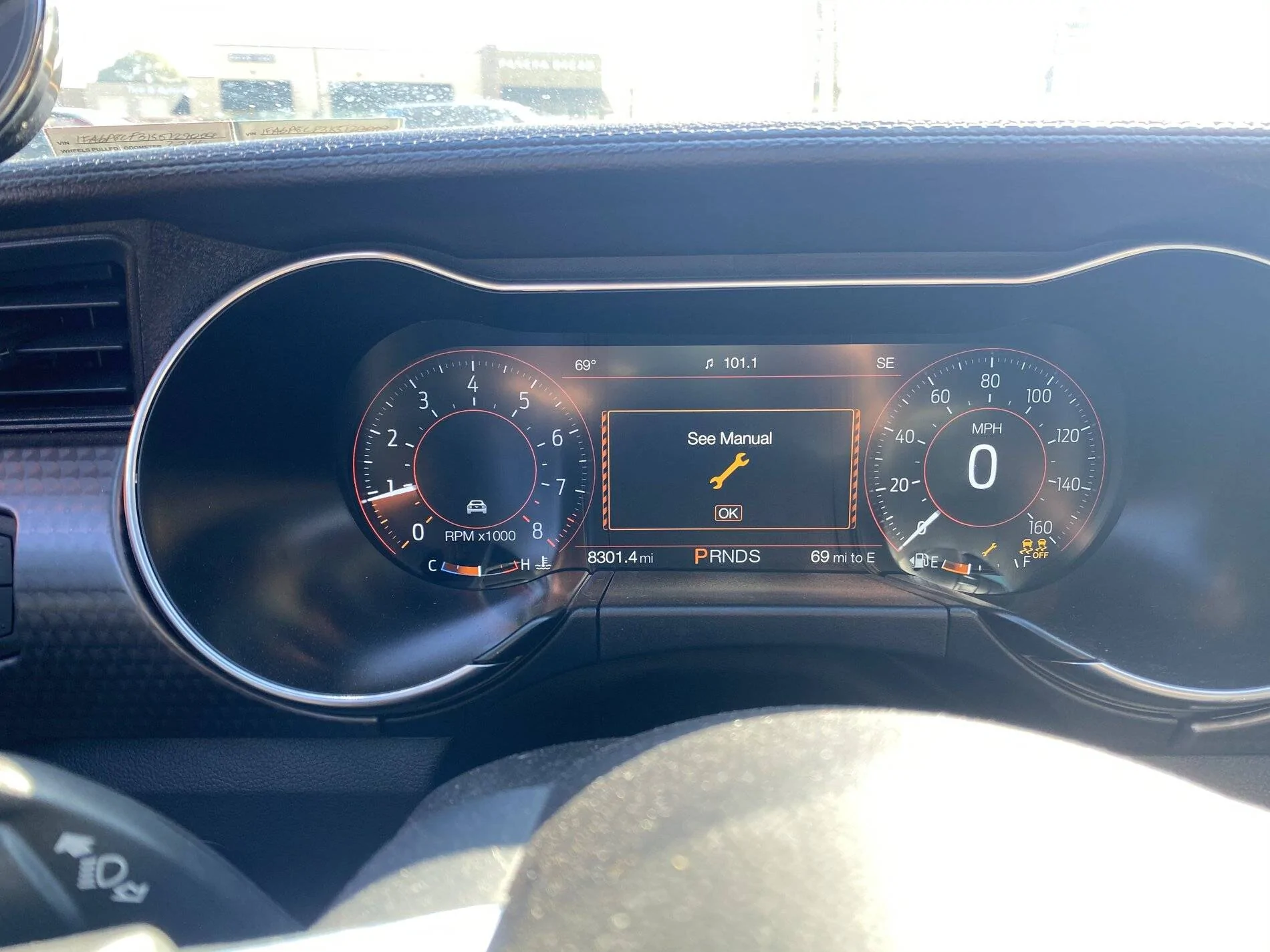

i also noticed that it’s not reading tire pressure censors and it Locke me out on drive modes
