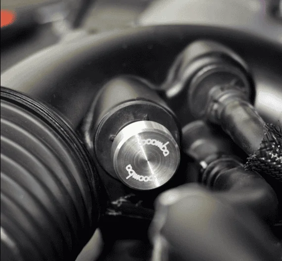

i dont have my sound tube(breather tube the same thing?) installed on the stock cai i deleted that, that could be the cause ? and i guess thats what you meant when you asked did i uninstall any parts lol my bad

Do you have the plug in the intake for the sound tube delete? No, the valve cover breather tube goes from the intake pipe, to the drivers side valve cover fitting

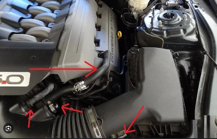

Check all of these locations for correct installation. There are O-rings insde the fittings, make sure they are intact and not broken or pinched. Make sure the MAF sensor is sealed properly against the intake tube and of course the clamp and intake tube section at the throttle body
