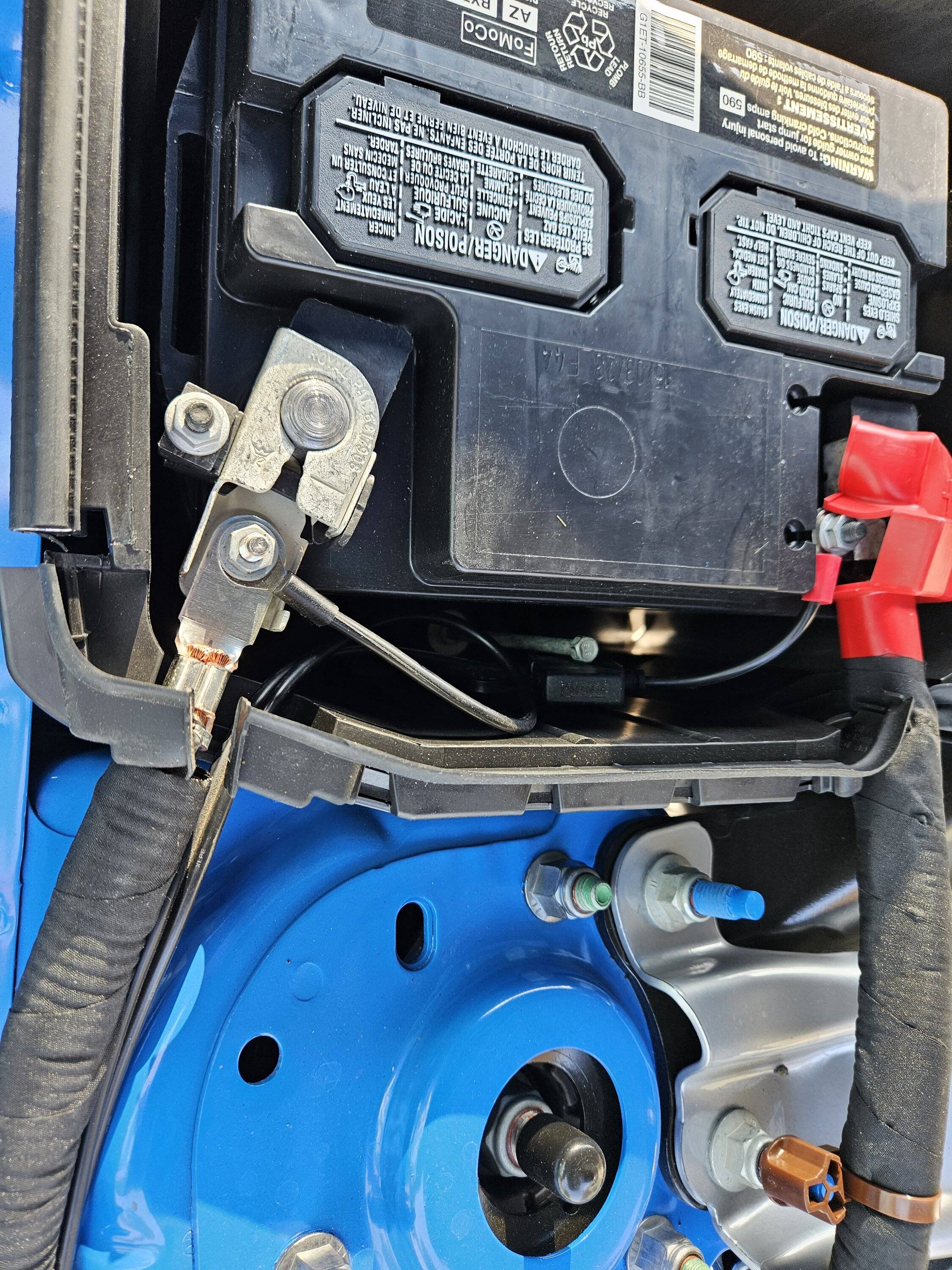

Exactly where do you have the battery tender pigtail hooked up? Is it hooked to the fusebox or directly to the battery? To me it sounds like once it goes into deep sleep mode, the BMS is cutting off the tender allowing the battery to go to a low state of charge.

Negative (ground) is connected to factory ground on the Passenger strut tower. Positive is connected to the fuse box terminal where the battery cable ties in (electrically, the same point as the positive terminal).

That's how most hook them up and have no issues. I went direct to the battery so the BMS can do whatever it wants but the tender will always charge the battery.
Try moving the neg connection directly to the battery, If it won't reach, take apart the post where you have the neg hooked up now and make sure there is no paint on the threads, ford is good at not chasing out ground lead connections and leaving paint in there.

I thought about connecting it as you did, but I wanted the ability to do a disconnect without popping the hood. My method put the quick disconnect right above the headlight, and I could disconnect and tuck the inch of connector up under the hood. I could also pull it out and plug it back in without opening the hood.

I get it, but try it just to see if it solves your problem. If it works you can always buy a longer pigtail or make on from an extension cord that fits your particular charger. I have an actual battery tender brand and amazon sells extension cords that plug into the pigtail. Get one long enough and cut off one end and crimp on some ring terminals.

I know others have said connecting to places other than directly to the battery worked for them but I'd personally never connect a tender anywhere except the battery terminals themselves.
If cable length is the only concern I know that Amazon sells 25' cables.
I'm willing to bet that would solve the OPs problem.
