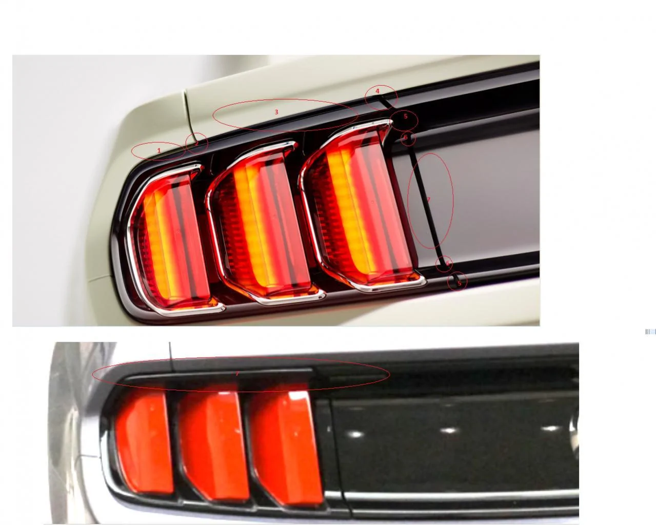

Had trouble uploading more than one photo from my MAC using Outlook. Will try and get some uploaded on Saturday.
Seeing as how the tail light photo was the only one to load, I'll stick with this for the moment.
No.7 shows what the designers had in mind on the clay model in the lower photo. On the LE you can see how the trunk lid at No.3 has a cutout to clear the housing. It almost looks like they tried to copy the top part of the trunk lid from a late 60s Mustang. However it doesn't work because No.1 & No.2 have a lip which is lower than No. 3 (Not as pronounced in this photo, because the trunk lid deck is sticking up above the quarter panel. Some have tried to adjust this down, so No. 1 & No.3 match, but then the lid is lower than the quarter panel. No.2 is the corner with excess metal that interferes with the housing. It's different on the left and right sides. I've tried to bump No.1 & No.2 up and into the recess, to so that No.1 & No.2 match No.3, which is starting to work, but it won't match the straight-across of the clay model. Even if the top lines match, the plastic at No's.4, 5, &6 cannot all be aligned, especially at the top. You can get most of them, but not all. This is due to the Trunk Stamping, the Plastic Mold design and the Quarter Panel Stamping and welding of the panels. The left panel is so far out, that the back glass sits lower on the left, than the right, up by the roof. The trunk lid corner near the glass, also has alignment problems due to the quarter panel. Had to pound the corner of the trunk lid down to match the profile of the quarter. Also, if you tighten up the gaps near the glass, the corners are sticking out and the creases no longer match. To match the creases, you pull the trunk lid aft, but then it sticks out beyond the quarters. I tried lining up the trunk first, then the lights and panel. Close, but will never be perfect because of design flaws.

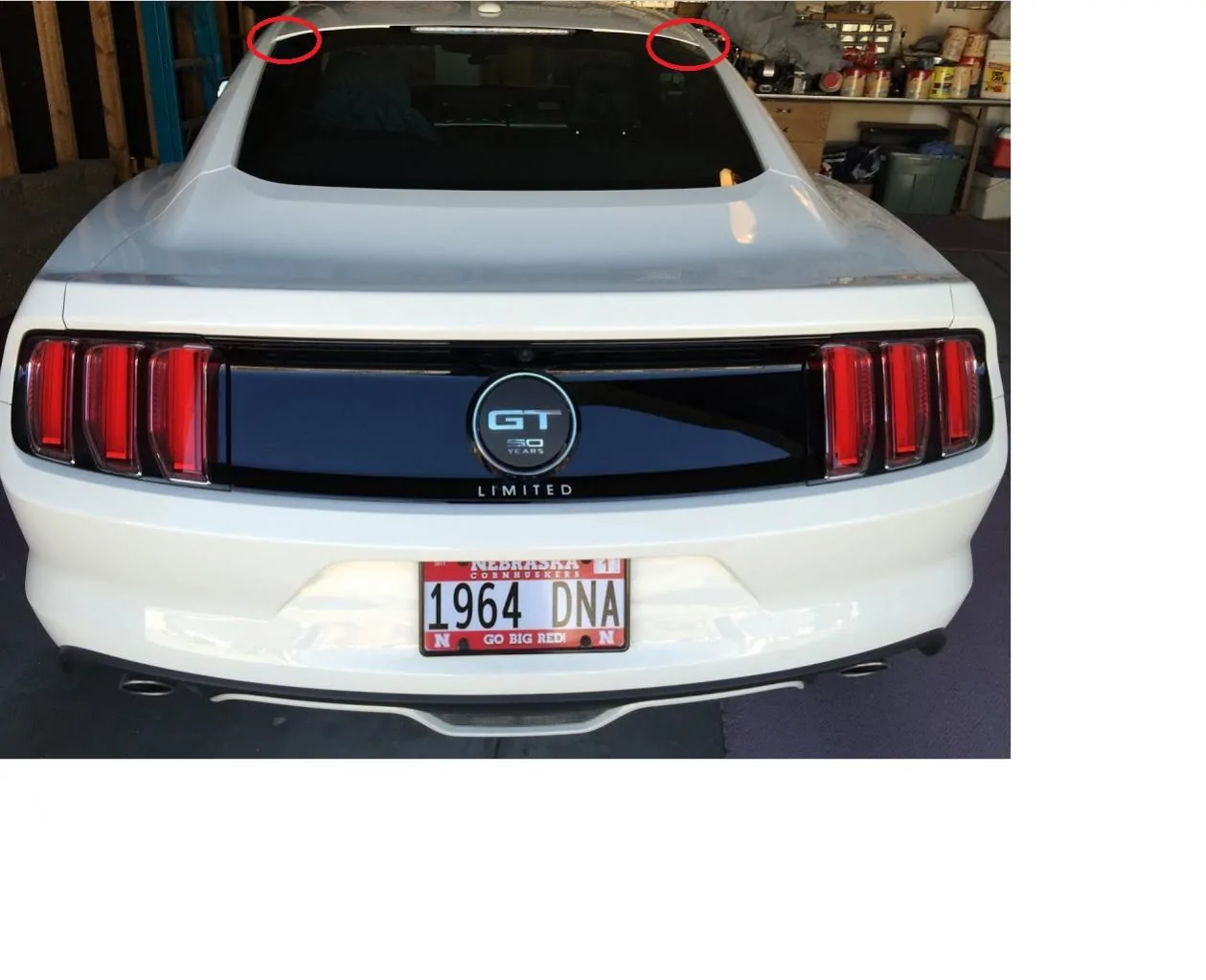

Husker's LE
Husker's LE has the problems that most have. If you line up the plastic, the trunk won't align, and vice-sersa.
