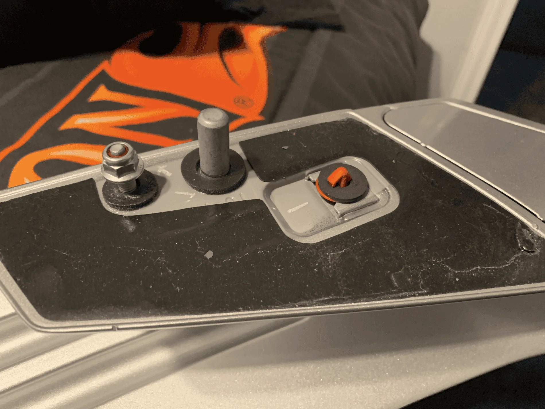

I followed your advice. I also made 4 load spreaders from light angle iron and additional 2-sided tape. Now those tiny nuts are clamping on a much larger area of the trunk sheet metal.
The spoiler is stuck down really well and I feel pretty confident it isn't going anywhere.

I just recently re-attached my PP1 wing spoiler. Within months of buying the car new, the spoiler started lifting off at the ends. It progressively became worse to the point that my OCD couldn't handle it. What a complete pain in the butt to remove and clean the adhesive residue off. It's on there good now and the 3M VHB part# that I provided the link for is slightly thicker than the factory applied tape and seems to be much stronger and better at filling in gaps.

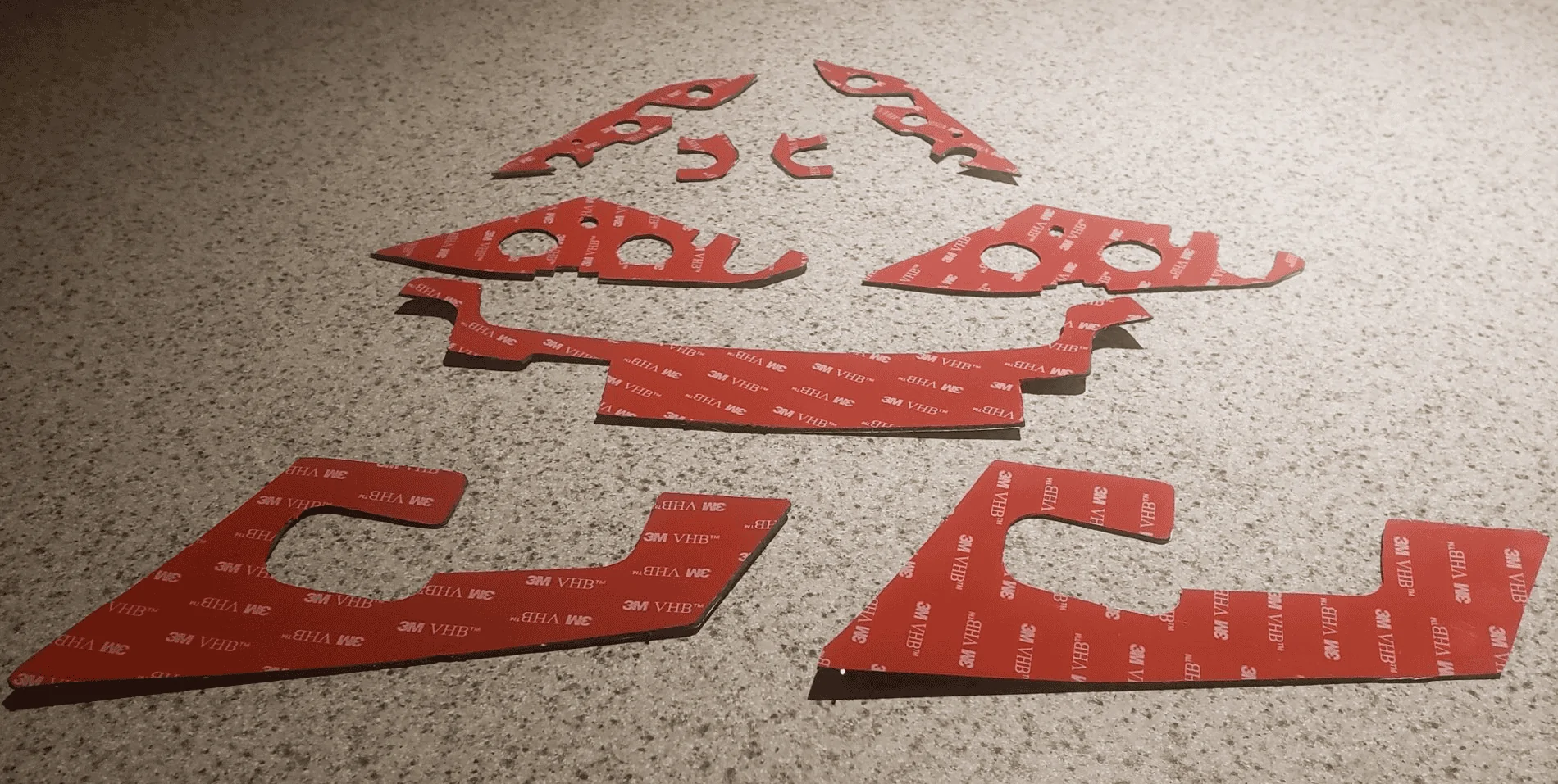

A 12x12 sheet was way more than enough. But not quite enough to do it twice.
I made templates by tracing the grooves on the backside of the spoiler using a sheet of paper and the edge of a pencil to get an impression. Then cut-out the paper and traced that onto stiff thin cardboard. Then used the cardboard as a template to cut the VHB. It was time consuming.
Search around you can find pictures of how the VHB pieces should look. It doesn't go all the way to edges. This should help:
The 3 large pieces in the foreground are what you will need to make (example, the smaller pieces are if you take the spoiler apart to change the paint color, made by another member):

Perfect! Thanks for the detailed response! I did notice how the tape doesn't go to the edge when I was taking it off. I also saw the raised edge you used as a guide to trace on the paper, so I'll do the same. Thanks again!
