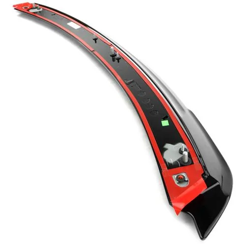

lol you cant install it improperly though. hes just pulling it off, seeing debris under it, and probably saying it looked like it didn't seat right is because dirt was under it, it just lifted, dirt went under and now you got dirt. can happen from even a sitting brand new car I reckon.
you clean the surface, and the spoiler, has several bolts and guides, cant remember how many, but 2 people, (I did it myself or with my gf) I cannot remember, you simply set it into the spots. the spoiler wouldn't go on, if it wasn't placed in the holes properly. the sticky tape is just extra grip.
there's also a guide on each side, and each bolt has a spacer/grommet that slides into the holes perfectly.
here's photos for ya. using oem 350 wing, but they are all the same if you have stock spoiler holes, just diff shapes.
