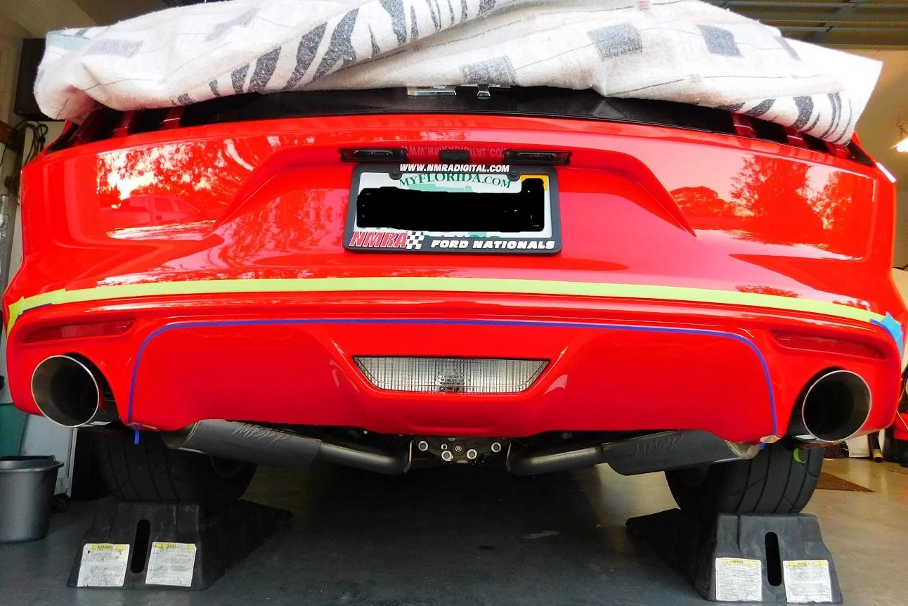

Base lower rear Bumper paint (pic)
BOBS550
Jul 16, 2015
207
155
Port St Lucie Fl
Bob
2019 Mustang GT Auto Race Red

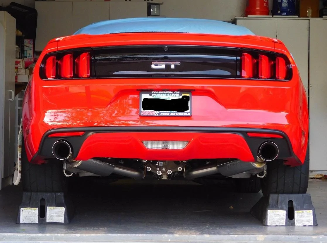

I will probably get flamed for this but I did use Plasti Dip in case I did not like it but it was my first time to use Dip. I will say I am happy with the out come, I did use 1/4 inch fine line tape for the curve area and worked great (2nd pic):cheers:

Have you guys got any tips for masking it off? I can see OP drove his up on ramps, but how about you [MENTION=24889]Labradog[/MENTION]? The valance goes under a decent amount so I just worry a bit about the quality of spraying it and how smooth it would look.

Looks great. How many coats did you apply? Any glossifier added?
I only have ramps was not to bad just had to lay on my side for low areas:thumbsup:
I did 4 very fast coats so I could peel the tape off, no glossifier. But may get something to treat it for protection :shrug:

I think it looks great! I bought the stuff to do mine just never got around to it.
Did you end up masking the reverse light and reflectors? That's the part that worries me the most. I feel like it's going to be difficult pulling the tape off of those without messing it up.
If I would do it again I will use paint, I did mask off the whole back of car with tape and paper I did not take a pic of that step. The reflectors I dipped over and peeled it off when it dried.
You are right about peeling the tape off without getting a jagged line, I watched many vids on you tube on how to do it and practiced on a piece of metal with tape first. It is a problem keeping the dip wet and pulling tape off while wet Next time trim black paint:thumbsup:
Shouldhavegotthegt

I did mine on the ground, so lots of laying down. I’ll post a pic tomorrow of the result in the sun. I think it came out well, there’s some texture but it actually matches the rest of the lower abs pretty well. I did 6 coats and you gotta remember to remove the tape right after you spray the last coat or it will tear.
