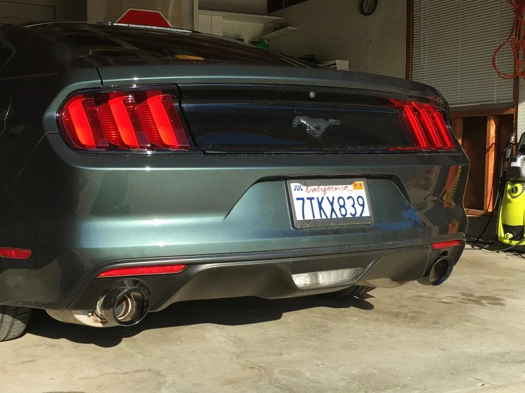

I used bumper paint from autozone. I did the whole bumper. My car is magnetic. Added the MMD bumper fins
Pics! Thinking of doing the same if I don't go to a 2018 bumper.

No flame. That is just smart. It looks great and can be removed easily.
Now I am thinking about it.

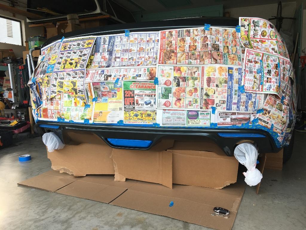

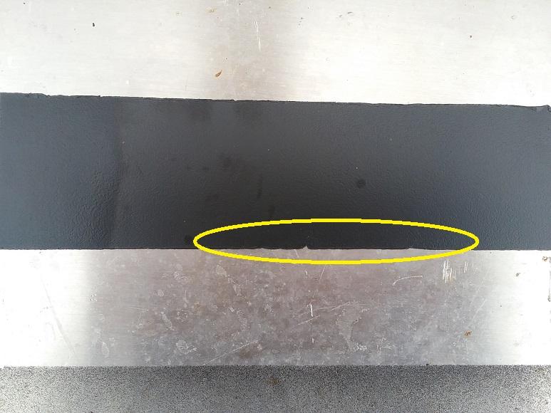

I did have problems pulling the tape off had to practice on a old piece of metal to keep from having a jagged edge. The dip sticks to the tape had to pull it while wet, did many practice runs on test piece:frusty:

I found the same thing Bob. Seems like you gotta do a thick final coat and get that tape off in under a minute for the best line.

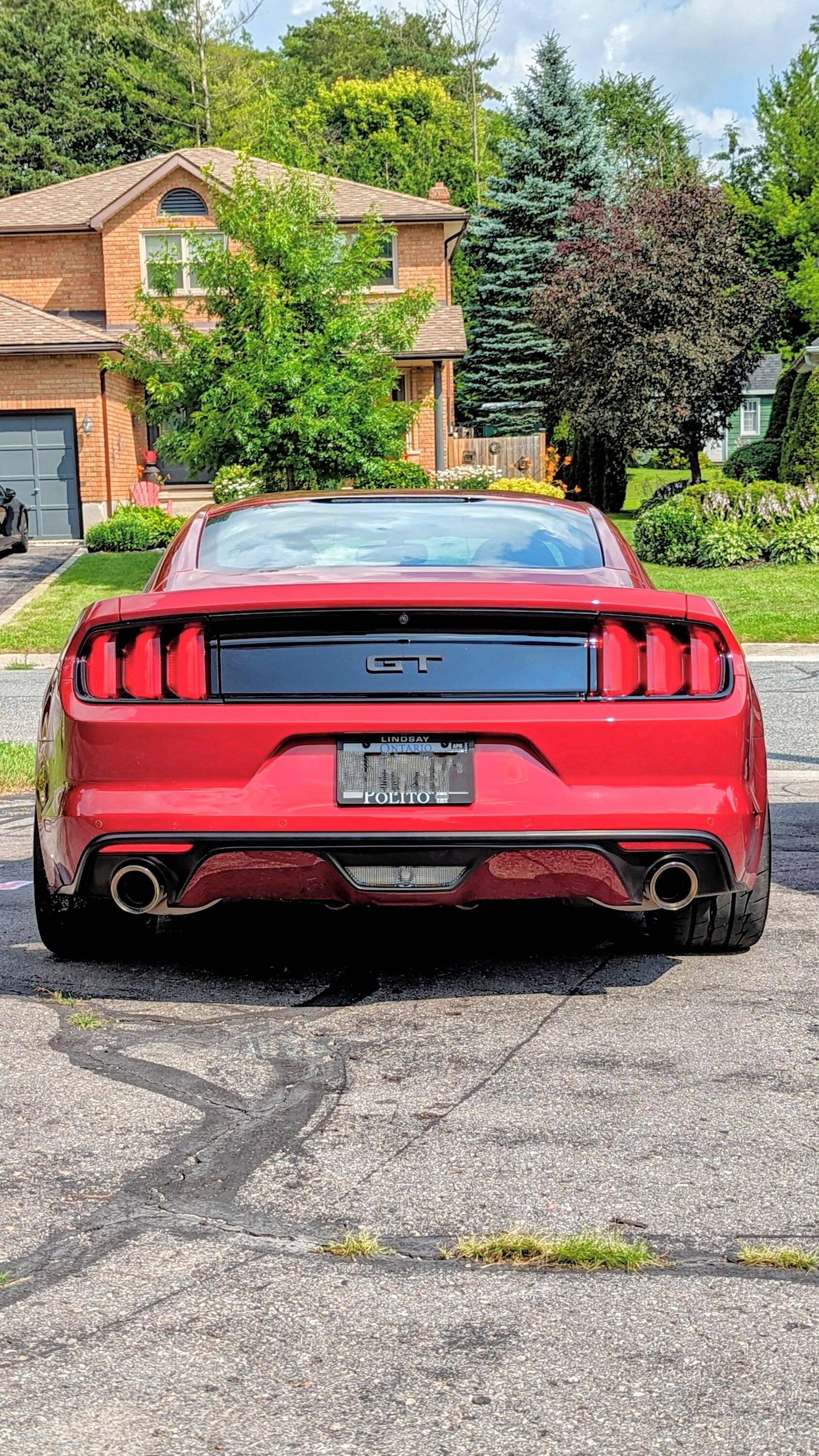

Thanks for the inspiration! I was able to gather the courage to do mine as well. I tried to follow the premium lines when I did mine.
