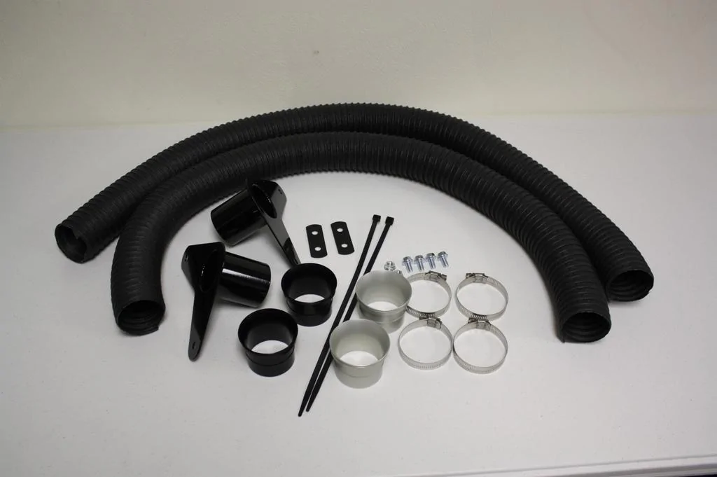

And I would argue that 4-pot brakes, with high-quality track pads, fresh fluid (even OEM), and cooling ducts will perform superior to the brembo setup with no other mods.
please tell me how you plan on running the cooling duct kits on a base Gt brake set up? The back plate literally blocks the path and theres no way to attach them.
Look, my point is that the weakness of the GT Premium brake system with 4-pot front calipers is NOT the calipers, but the pads, and lack of augmented cooling.
Cooling ducts are superior to the air vanes that come with the PP front arms. The dust plate is replaced by theirs that accepts the new hose. (The plates in the picture below are at a weird angle so that they don't even look like plates.)

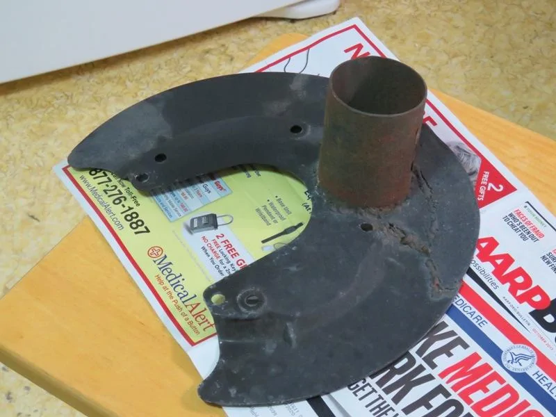

Dust shields can be modified with a hole cut to suit a short length of tubing of appropriate diameter. That's what the people who sell dust shields ready-made for hose attachment either do themselves in-house or contract others to do for them.
Something like this that I did for the little 12.4" brakes my car came with, showing a false start or two, messy MIG-welds and all. Must have helped, because I was able to actually crack XP10 track pads without ever losing braking performance.
The car now wears much nicer dust shields with 3" inlets (Vorshlag).
