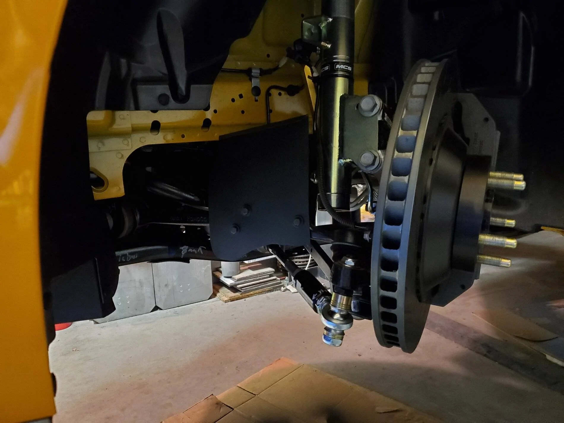

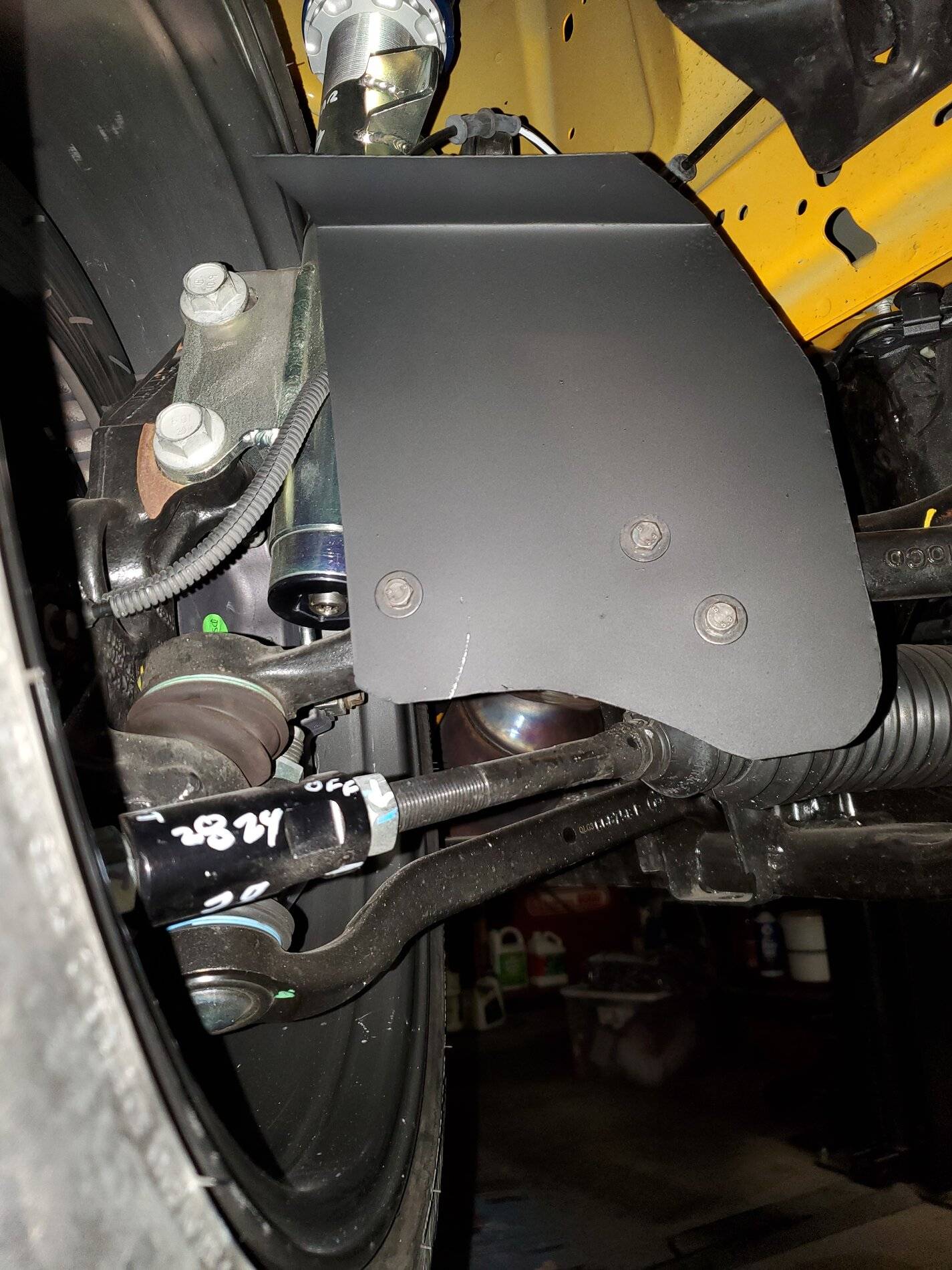

Vorschlag proved that the PP1 undertray channel ducting and big brake deflectors works better than tube based ducting. I said great. I don't want to fab those anyway and we always destroy them when tires rub on the tubing. The Vorschlag deflector is under $150 bucks but easy to make. I needed some ASAP for a weekend race so I just made my own from aluminum stock. I would just buy Vorschlags just to save the time. I tested my creation at autoclub speedway last week in a 30min sprint race with the biggest brake zone about 130mph to about 50mph into the infield. Ambient was only about 70F and the big deflectors worked fine. Just like we racers don't use the dust boots we also don't need the protector plate that covers the inside of the rotor and spindle. I (like vorschlag) run without those and that gets more air right to the center of the rotor. I do not see much of an advantage to dust boots or the inside protector plate even on a streetcar.
I honestly doubt deflectors are better than a well thought out ducted arrangement, but if the deflectors are enough, then the extra work, weight & complexity is unnecessary. They work fine for Porsche Cup cars and it's going to be a rare Mustang that can get around a racetrack faster then one of those.
For me, the biggest issue is getting the vents on the correct side of the brake bell. Venting on the outside of the disc is just ridiculous.

Vorschalg did all kinds of testing. I forget where you can read about it. The splitter channel ducts showed cooler brake temps. They even combined 4" hose ducts with the splitter channel ducts and that did not reduce brake temps over the channel ducts alone! That was a huge surprise. Airflow is a strange thing. Personally, I'm happy to have one less thing to fix and maintain.
