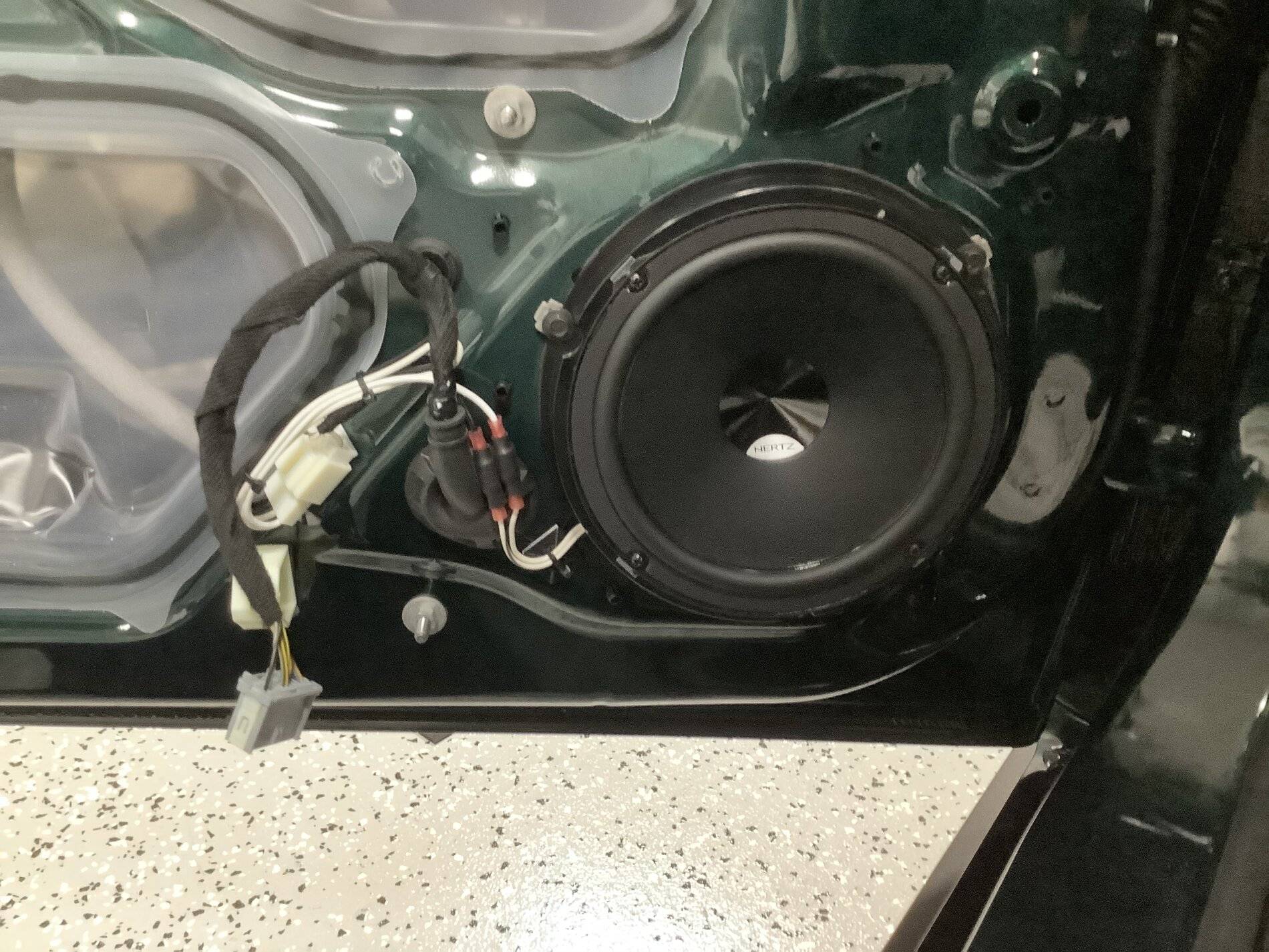

I found this pic of the DSK 165 mounted in my driver’s door.

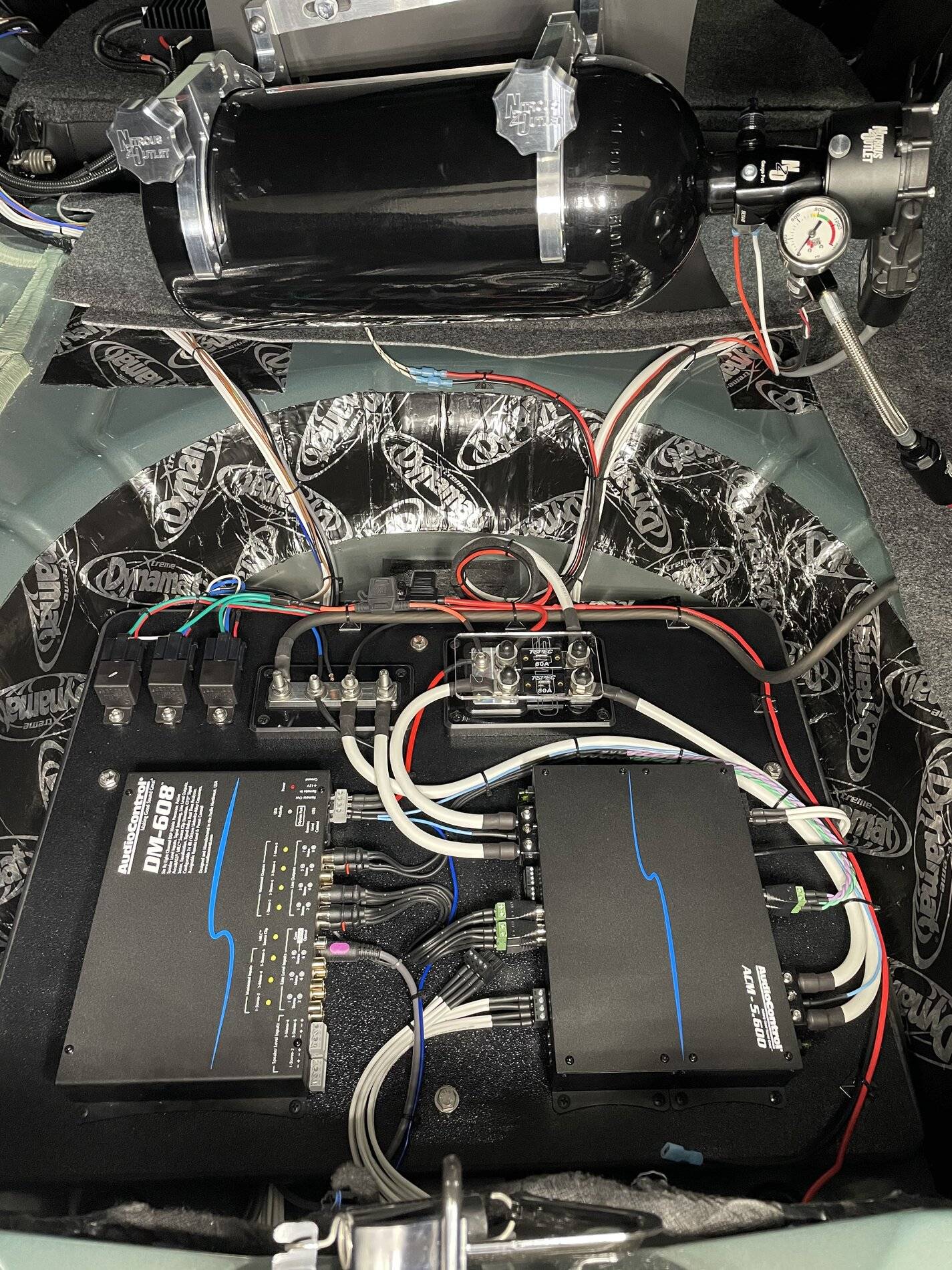

The DSK 165s come with tweeters and their own passive crossovers, although I didnt use the crossovers because I’m running the AudioControl DM-608 Digital Sound Processor (my tweeters are running off of an AudioControl 4.300 four channel amp). I never hooked the 165s up to the aftermarket amp because I wanted to avoid cutting the factory wiring harness, in hopes that someone would manufacture a plug and play harness. The 165s sound so good on the B&O amp that there really is no rush to run them off of rhe aftermarket amp.

Here is a pic of the DSP and my two AudioControl 1.300 and 4.300 amps. They are under a si gel cover (the one that has 5.600 on it).

Oh yeah I recall that NOS to cool the amps haha....I'm just wondering what to do with vert 9 speaker, cheaply....
The easiest way to integrate everything is to get a PAC Audio AmpPro fd-21 interface and use RCA cables to feed the speaker signals back to your amp.
I’d do the DSK 165s in the doors (leave them on the B&O amp) install the supplied tweets in the A-pillars and run them on an aftermarket amp along with rear replacement speakers (check Crutchfield to see if the DSK 165s will fit in the rear speaker locations). Lastly, I don’t know how much room is in a convertible,trunk, but maybe consider something like the subwoofer below. if you do this, try and find a way to port the sound from your trunk into the cabin, so that it isn’t confined to thr trunk.
