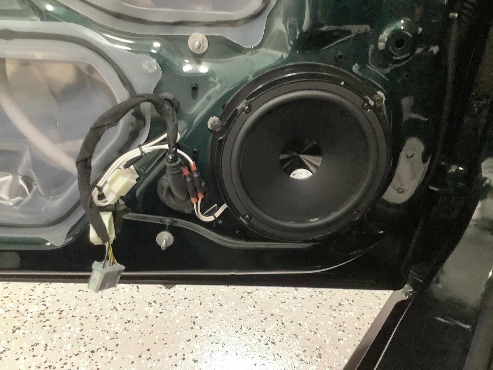

Do I need any special brackets, plugs or site modifications for DSK? I really appreciate your insight!
If you order from Crutchfield they will send you brackets and a factory style pigtail/connector. I simply drilled a hole in each speaker bracket, ran new speaker wire (soldered to all speaker terminals; although you could use female spade connectors if you wish), routed the speaker wire out of the hole In each bracket and added male and female spade connectors on the supplied Crutchfield pigtails and speaker wires and then plugged the pigtail/connector up to the factory connector on both doors. Look closely at this pic and you can see the new speaker wire exiting the hole that I drilled in the mounting bracket, followed by he red spade connectors (I used two male and two female spade connectors) which are connected to the positive and negative speaker wires, as well as the positive and negative wires on the pigtail/connector which is shown plugged into the factory connector (off white connector on the door).
