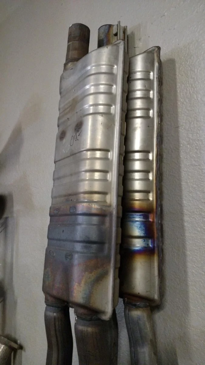

Only issue with the stock exhaust is the restriction and heat generated in the center muffler (suitcase). I have attached a photo for reference. Just remember turbo engines like the most free flowing exhaust possible.

I would go catback or at least put a Y pipe to eliminate that rubish stock resonator. Another reason why I don't go axleback is that I dont like cutting my stock exhaust if eventually I want to go back to stock it would be simple. As far as sound this is very subjective you have to choose what works for you.
