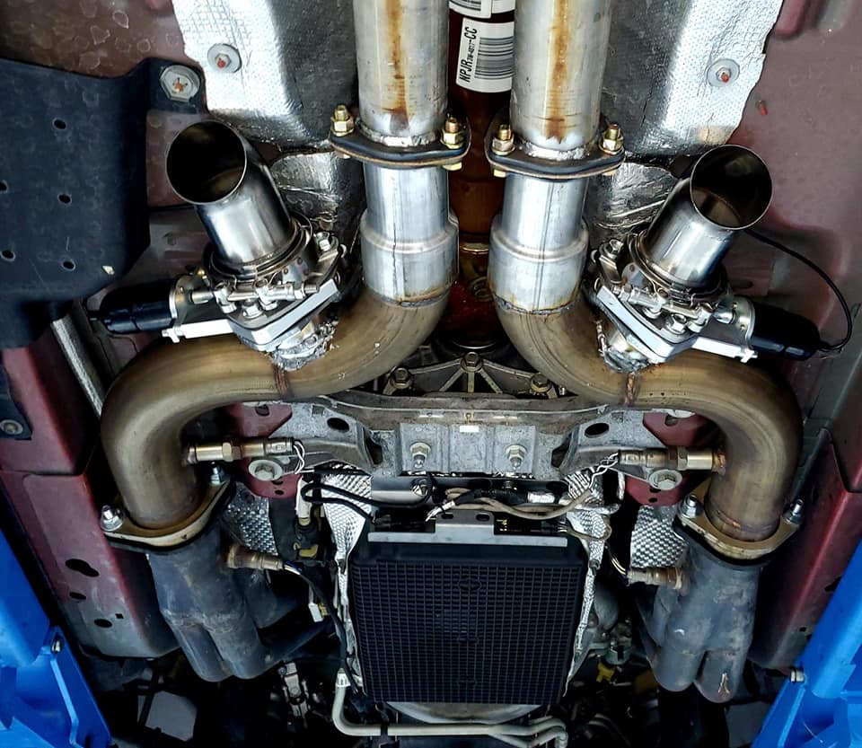

I had 3" MBRP Street on a 2015 that had a deep tone and didn't drone. Stock manifolds and cats on that car with resonator delete. My current 2018 car has Long Tubes, no cats and a resonator delete with stock axle-backs. Nice deep tone at idle, low and moderate cruising speeds with zero drone. I also have electric cutouts at the mid-pipe between the headers and resonator delete. WOT runs with the cutouts open sounds like a NASCAR racer. Best of both worlds. Good luck with your decision...

Any pics of your cutouts in the mid pipes and maybe a sound clip of them open and closed?

Pics are attached as requested. Two issues with the audio request. One, my right side cutout valve has burned out. This is normal. I got over 3 years out of it and I have a replacement on the way that is easy to install. Two, even when I do get the cutout replaced, idle and low rpm are all that my phone will record, due to the microphone protection built into the phone.
The brand of cutouts that I use is Spelab. I had a shop weld flanges that allow for easy replacement of the cutouts. If I remember, I'll try to get some video with audio of idle and low rpm with the cutouts both open and closed. The replacement cutout is supposed to be here sometime this week...
